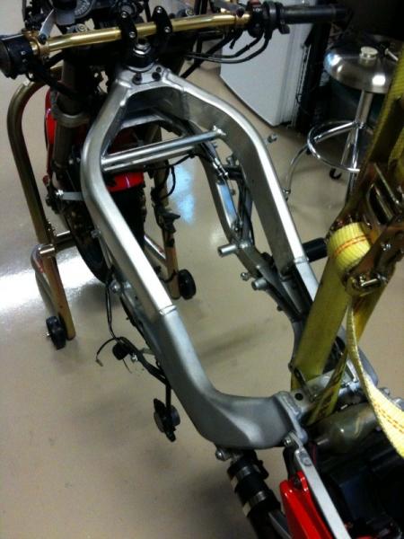

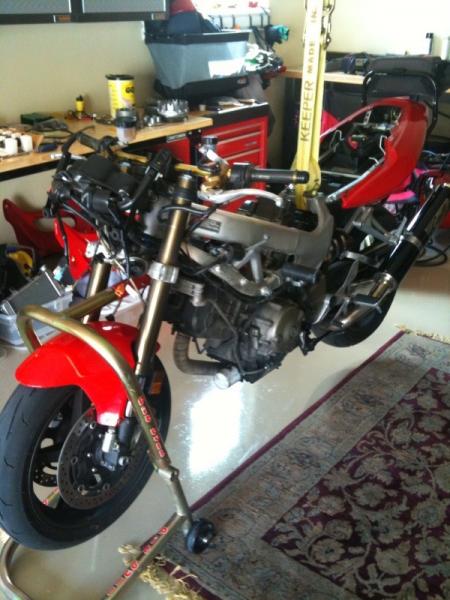

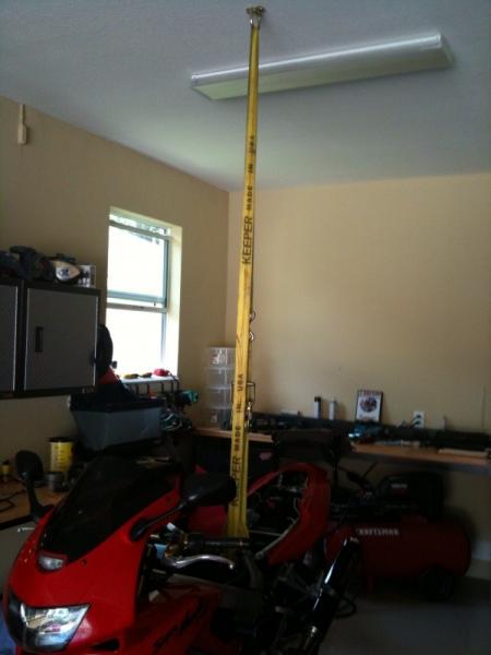

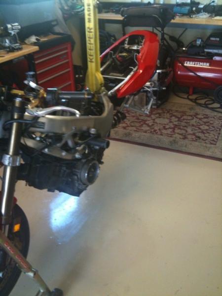

Transplant surgery in progress!
Attached Thumbnails Time for Stage I-hanging-system.jpg   Time for Stage I-hanging-system2.jpg   Time for Stage I-carbs-out.jpg

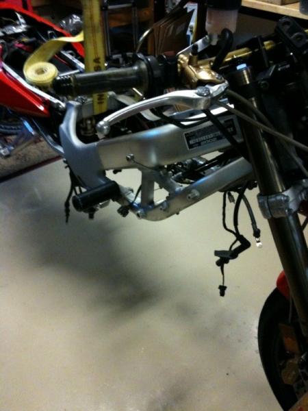

I took the rear section off yesterday. Next I'll drop the stock motor out and put in the fresh STG1 motor. However, I'm still waiting on some parts to come in. This monster should be breathing fire soon!

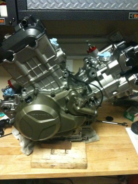

more progress!
buttoned up the torque monster last night....finally!

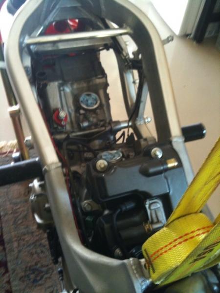

Tame motor is out!
tame engine is out! anybody want a nice 100hp motor with 30K on it?
Attached Thumbnails Time for Stage I-tame-motor-out2.jpg   Time for Stage I-tame-motor-out.jpg
