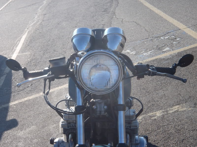

ok brake gurus, i have a kz650 that i need a new MC on and since i have the VTR MC extra now i was contemplating putting it on and seeing how it works. the piston size for the kz is 41mm and the vtr's a 14mm MC
Front Master Cylinder Ratio Chart
i dont know enough to make a sound decision on if the vtr MC will work for me or not, the stock 650 MC is 5/8ths and the leverage comes out to 6.67, with the vtr's MC it goes up to 8.58... what exactly do these numbers mean in terms of braking?
right now my 650's brakes are awfully spongy and the MC leaks slowly, i have had the brakes bled and i have done it myself but its just time for a new MC and i thought i could use the VTR's
any and all help would be appreciated
thanks!

Well your 5\8th or .625" master is equal to 15.875mm So the SH master would be even smaller, giving you even less stopping "power" though the lack of air bubbles from the leak might make it better.....
ahhhh soo the mc has to be at LEAST the same diameter (??) as the one its replacing in order to be viable to use, any modern bikes MC's that we know of are 5/8ths??
edit i remembered reading about this on page 1, and i looked back, sooo the F4i MC eh? interesting

There are lots of options but yeah you would want 5\8 or 16mm.
Just to broaden your search a little bit I also know that a 650 V-Strom (DL650) uses a 5\8ths front master.... and has a mirror mount on the clamp if that is needed on the bike you are looking to put it on.
not a huge issue for me just looking for something that will work
thats the beast its going on
Old Sep 12, 2011 | 02:04 PM
  #206
Well to keep it simple, if you put a smaller bore master on, you will have more "feel" but less "power" in the brakes
A larger bore will do the opposite, Less "feel" and more "power"
The trick is finding what works best for you.
You don't want the brakes to be wooden (too much master) or overly "soft" (to little master) but like goldielocks..... just right.
Now what the master comes off of is not really an issue as most bars are 7\8" so it should bolt right on. You might have to do something with the brake light switch but even those terminals are pretty common on all of them.
Old Sep 12, 2011 | 02:10 PM

great ok, i might just try the VTR one out... due to the leak i have in my current one i might just try it out and bleed it well and see how it works, right now im getting the lever all the way back to the grip...

Reverse that.. in MC: Smaller bore = more leverage (power), more lever travel, less feel. Larger bore = less leverage (power), less lever travel, more feel.
