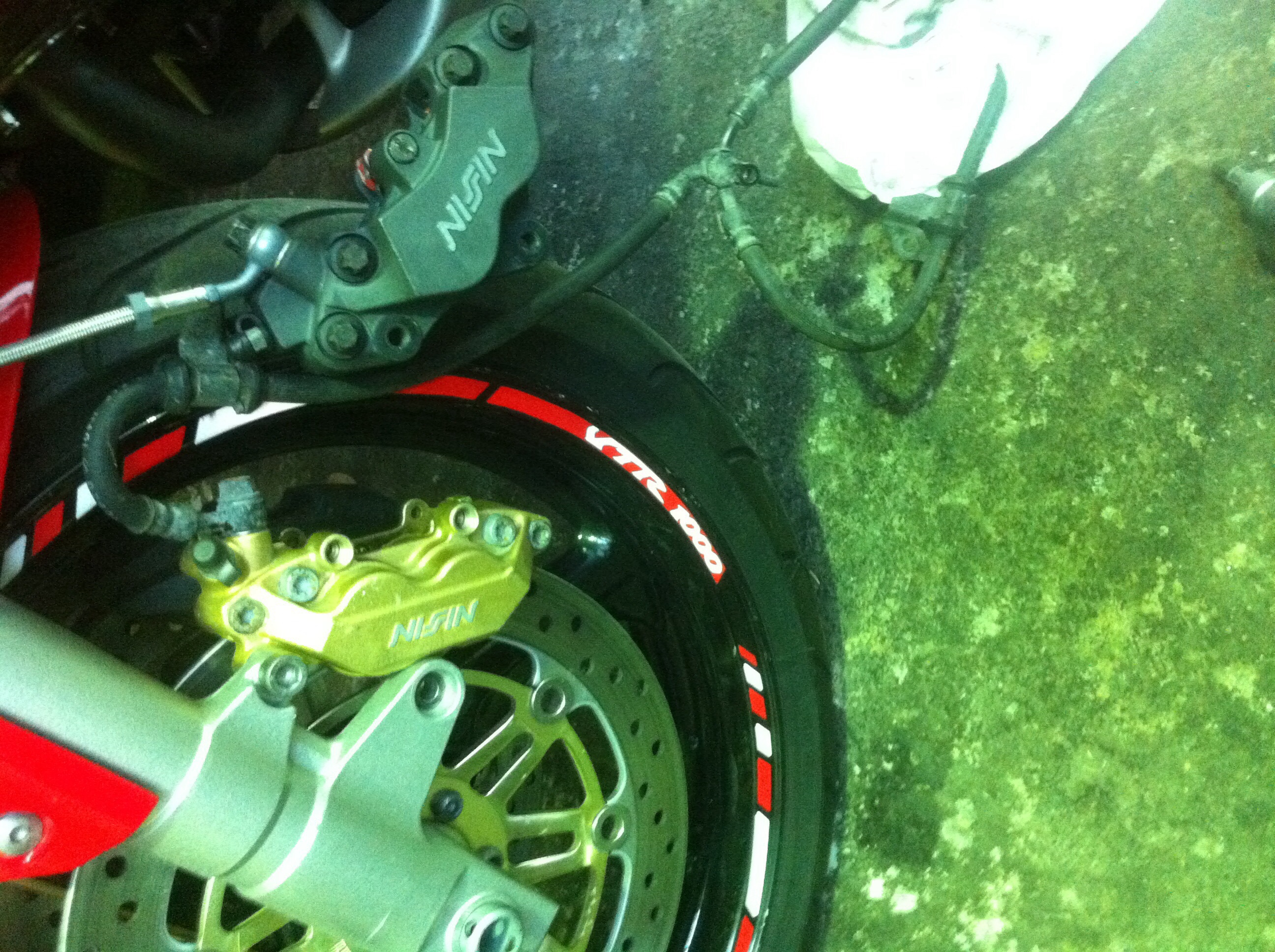

  #266
nyk23's Avatar
Joined: Jun 2014
Posts: 34
From: Romania-Bucuresti
nyk23 is on a distinguished road
Caliper Honda 954, next upgrade.
