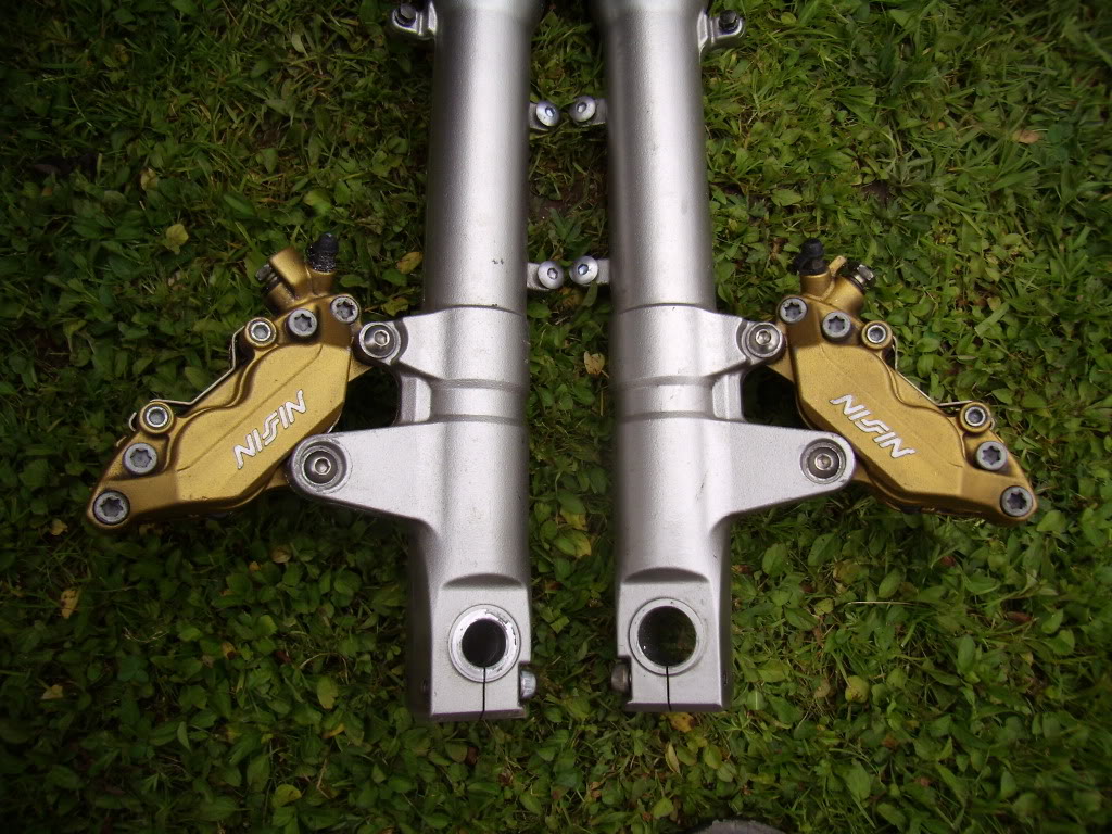

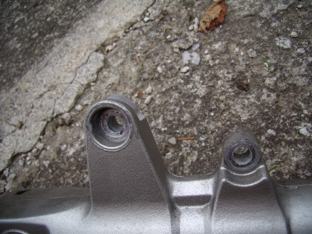

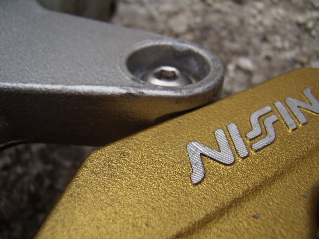

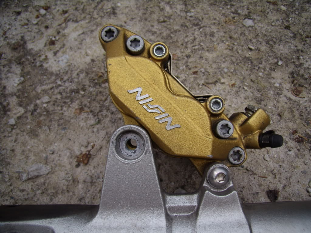

forks trim
I just add a few pics of trimmed forks to fit CBR 954 calipers, maybe someone will find it useful. I think it is better idea than to trim calipers.
original:
trimmed:
mounted:

Thanks for the pictures, Stephan. I'm doing this swap (well, RC51 calipers) in a week or so. I got the calipers w/ new pads for $75. The SH brakes are probably the weakest link as far as I'm concerned and I've wanted to do this mod for more than a year... Money, money, money...
