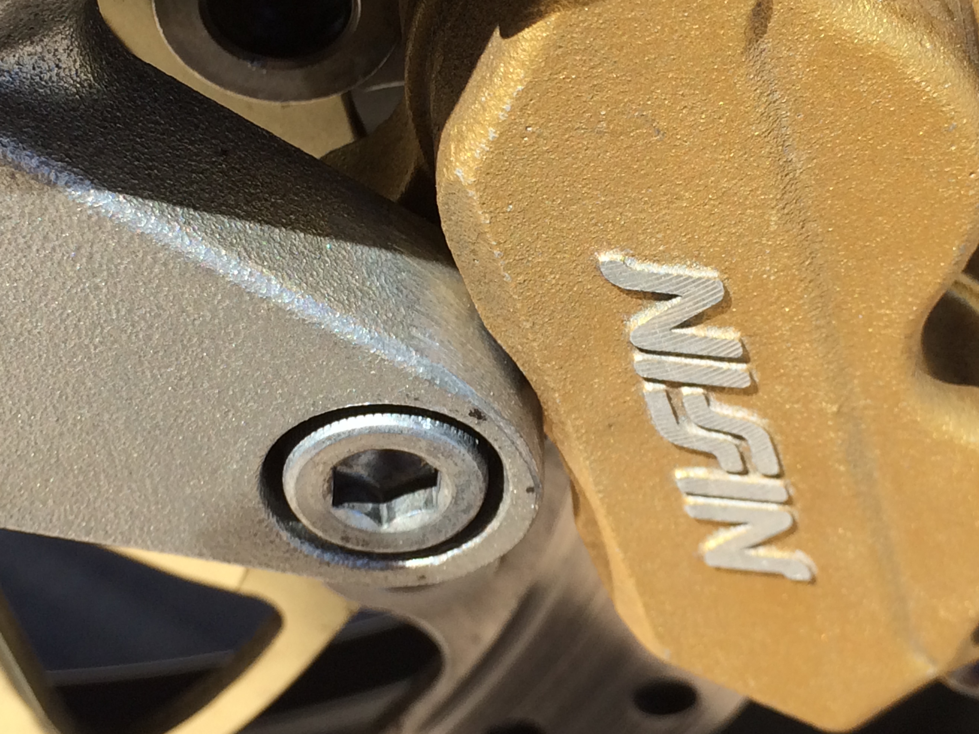

Finally got around to installing 954 calipers that have been waiting for a long time. Still have the stock master on, but have a 954 master on the bench along with a rebuild kit. The current combo is a bit hard to modulate. Though the biggest issue seems to be the wimpy forks bottoming out under hard braking.
The two black marks define the area that needed to be ground off the allow the caliper to mount up. I thought it was going to be a lot more.
