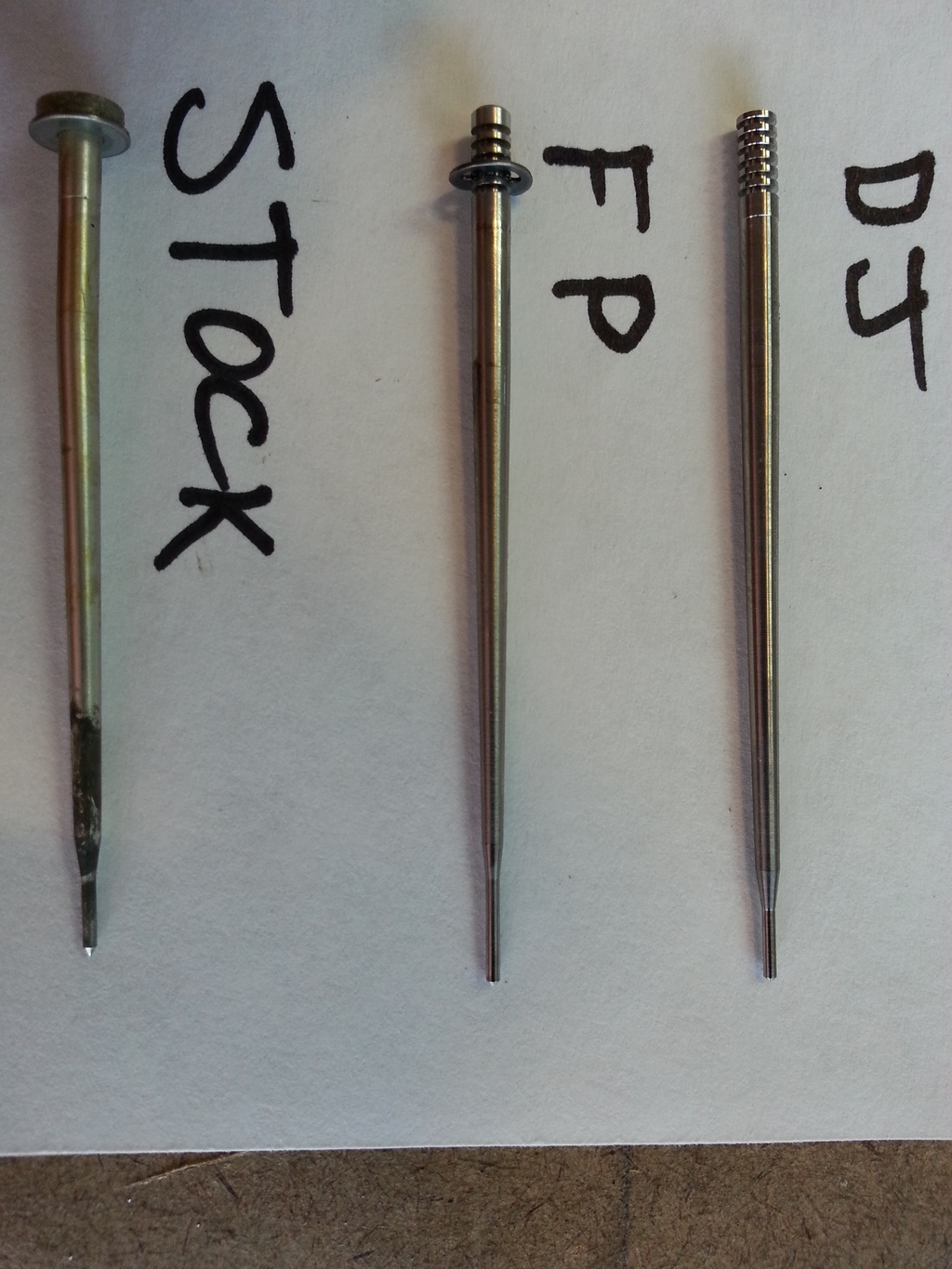

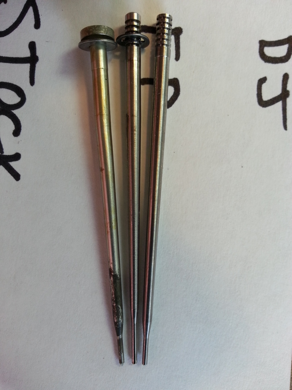

As I said, here is the three needles next to each other. Sorry for the condition of the stock needle (yes, the body of the needle is bent). This was the best of the two needles from my "spare parts" carbs. At least you can see the taper and design of each needle.
Old Apr 12, 2015 | 04:29 PM
Thanks man. That answers a lot of questions for me. And why I have trouble getting the mid right.

As far as I can see, and as the picture shows, the DJ and stock needle have the exact same profile.
To add another bit of info, the Factory Pro needle is the closest to the HRC profile of the 3 needles.
Though it does sound like you guys actually might need the unobtainium HRC "rich" needles which give a fatter mid-range and were for the ram air set up.
To me the DJ and fp look richer in the mid. But you have them in your hand.

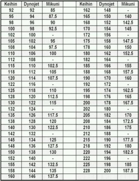

The more I think about it I didnt have this problem with the big idle jet in.
One major point, I stuffed up the Kehin jets being metric holes. They are not. Woops. So a 2.1 drill gives you a 230 size Kehin jet.

Jet chart below. Dyno jet work off bore size I believe.
Attached Thumbnails Latest OCMD project: modded airbox lid-jet.jpg
