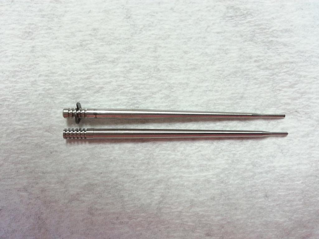

I haven't had any low end problems with my Factory Pro needles when I raise them. I have a picture showing the difference between the Dyno Jet needle and Factory Pro needle. I'll find the picture and update this post.
I just put on about 90 miles today with the 48 pilots and it is still too much. I'm putting in the 45's tonight.
With the 205F 210R I have the Flow Commander set at 1 turn out and it keeps getting better the more I turn it in (making it richer). I might jump up to 210F 215R and fine tune with the Flow Commander.
For the life of me, I can't remember which needle is which. I think the Factory Pro needle is on the bottom and Dyno Jet on top.
Edit: Thank you for the correction Micky! Dynojet is on the bottom and Factory Pro is on the top.

Top one is a ton richer.
