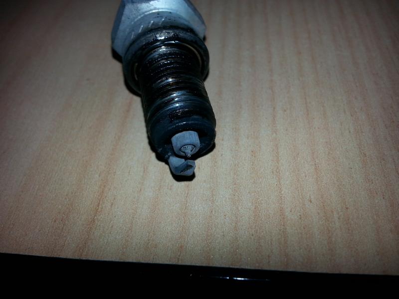

Ive noticed a flaw in my fueling. Only came to light on the track. Holding a constant throttle at 5k rpm Im getting a surging. I will plug chop it today to see if its lean or rich but suspect its a lean condition. A smidge more throttle and she pulls like a train.
It runs great everywhere else. Im starting to think the slides are not lifting quick enough. I may drill out the plugged holes in the slides but will start with smaller holes.

size of slide holes has practically zero effect at constant throttle (since the system is in equilibrium), what it does affect is the speed at which the slides react to a change in vacuum (ie. caused by throttle movement). Surging is typically caused by a lean condition, so you likely have to raise your needles slightly.....
Interestingly I just plug chopped it and it reads as being rich. Base circle is black and sotty. Maybe a drop in idle jet size?

Re-reading the plug with a magnifying glass. Does show as being lean in the mid and still rich up top.
So will lift the needles and drop main size on the front at least. will pull the rear plug on my next break.

Last night I put 1mm shim under each needle, dropped to 45 idles and 195/198 mains.
That fixed the surge on constant throttle. But what I have noticed is a huge difference in front to rear fuel screw adjustment. 45 seems good for the rear at 2.75 turns out but the front is 1/2 turn out and still not making much difference. Think I will drop it to a 40 idle on the front.
