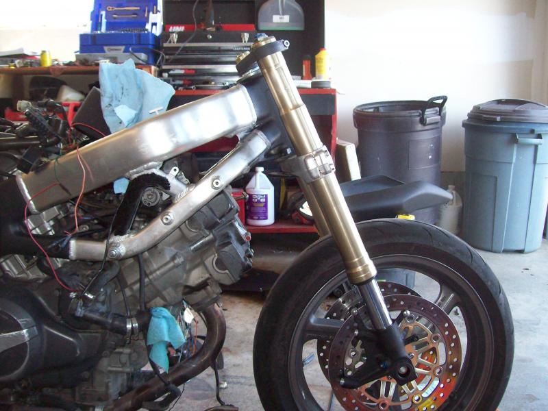

GSXR forks
i just mounted a set of 2007 GSXR 600 USD forks on a 98 hawk. i know what your thinking wtf 600 forks but their a 50mm vs the stock 41mm and the GSXR fork weight capacity is 790lbs. so it will be find. it didnt bolt straight up have to bust the dremel out on a stock vtr bearing and used one gsxr bearing. the bikes not done so i cant tell you how it handles yet.Fork swap?-015.jpg

i just mounted a set of 2007 GSXR 600 USD forks on a 98 hawk. i know what your thinking wtf 600 forks but their a 50mm vs the stock 41mm .....
FYI - they are both Ø41mm. Even the inverted forks are measured by the steel chrome plated tube. The inverted forks are much more rigid due to the design though. Keep us up to date on your progess. Better yet, start a new thread with all of the details on what you are doing to get it fitted.
