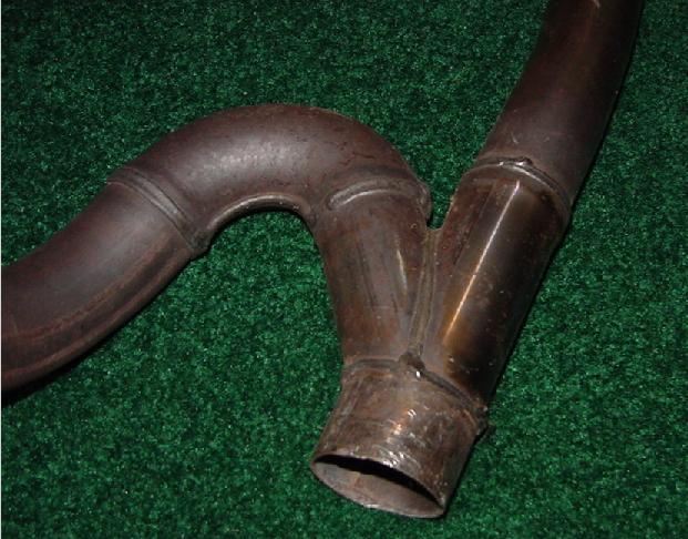

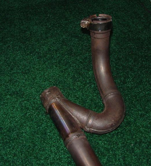

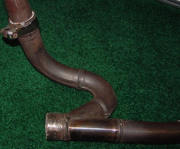

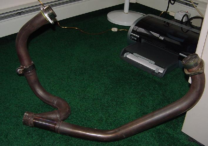

2-into-1 exhaust pipe pics
Hope this will help you get a better idea of how the exhaust pipe gets cut and welded. In picture 922, both headers are shown. The others show how the 2 pipes gets tied into 1 pipe as mentioned earlier by Gregw.
Attached Thumbnails exhaust-header_1922.jpg   exhaust-header_1923.jpg   exhaust-header_1924.jpg   exhaust-header_1925.jpg
Old Dec 20, 2008 | 01:10 PM
Yep, I cut my header in precisely the same place (at the end of the merge, just before they split again) I used a dremel to clean up the welds (to reduce turbulence and restriction, smooth out the airflfow) given that I had access to them. Hook up the link pipe there (2" diameter) and you're in business.
