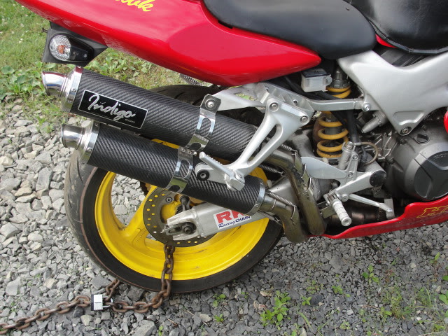

The closest thing to a "single sided" exhaust made for this bike would be the old Indigo system which used two (2) mufflers on one side.
I don't have any details about this local hawk but wanted to show the pics (and subscribe to the thread...).
My .02 on this system would be that it is not 2-1 in any way. These pipes clamped on just like any other dual system, it just has both cans on the same side.
