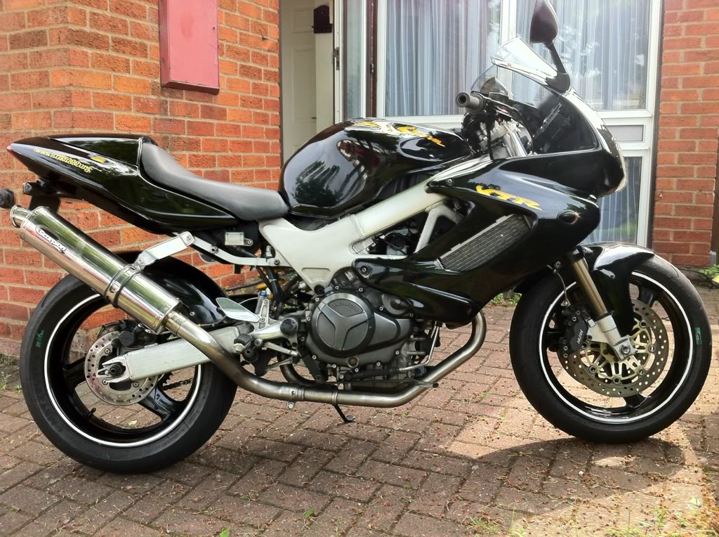

Here is my 2 into 1, but it was mainly driven by the sp2 swing arm set up.
Old Sep 25, 2012 | 02:55 PM

and mine
Old Sep 27, 2012 | 08:07 AM
altosuperhawk's Avatar
Posts: 153
From: Alto, N.M.
From those dyno charts it looks like you picked up 31HP and over 3 ft/lbs of torque? Must've been a lot more done than a 2 into 1 pipe conversion. I've considered the idea of 2 into 1 conversion for the last 13 years but always reconsidered for fear of losing the impressive bottom and mid range stomp. I want to do it for a very different reason than others- improved chain cleaning and lubing access.
Old Sep 27, 2012 | 05:44 PM
It read the blip at the end as peak. A good dyno guy would have cropped that off.
Old Oct 6, 2012 | 09:40 AM
barncat's Avatar
Joined: Aug 2012
Posts: 39
From: upstate NY
barncat is on a distinguished road
have put a few hundred miles on my modified system. if you instantly crack the throttle wide open on the bottom end of 2nd gear the carb slides take a split second to catch up. but a smoother roll on, particularly if you're already up a bit on the tach will really launch you, and the reduced restriction seems to give it more top end. it's hard to find a stretch of road around here where you can really wring this motor out though without the risk of losing your license...
i have not gone back into the carbs yet to experiment with perhaps shimming up the needles a bit. that hesitation would not be happening with direct lift slides. CV/airbox carbs are always more of a pain to dial in.
Old Oct 6, 2012 | 11:06 AM
lloydievtr's Avatar
road racer v2 power
Posts: 265
From: coventry england
all i changed on mine was the slow jets 45s to 48s
and a 1/16th turn out on the mixture.
i was already running 190dj mains and 4th clip on the dj needle .
i have found that the carbs need to be synced very well as a little out will cause the hesitation on the throttle at low revs .
and also blocking the 3rd dj hole on the slides helps alot on throttle response.
it now pops the front wheel up very easy in 3rd gear on the throttle

Old Oct 19, 2012 | 05:36 AM

Old Oct 19, 2012 | 08:27 AM
lloydievtr's Avatar
road racer v2 power
Posts: 265
the dyno had a spike when it hit the limiter thats why he put the markers on the graph
you can see that it gained 2 torque and 3 bhp at the top.
but it also moved the dip in power and torque up the rev range which makes it much better lower down and for road riding
i wish it had 136.78 bhp that would be fun to ride but it dont it has 108.61bhp
Old Oct 19, 2012 | 09:03 AM
nath981's Avatar
Posts: 2,934
From: altoona, pa
well this is certainly more plausible. Thanks for the nice pics. I want to go this route just to get rid of those heavy-*** OEM cans, and to have a few more ponies wouldn't **** me off either. Oh, and thanks for the carb notes which will likely be requisite.
I doubt that this could get me roll on the throttle easy third gear wheelies though, but I'll take your word for that. I have 15/44 gearing and mine doesn't, but i usually have my ***** against the tank because it makes them feel useful. haha
