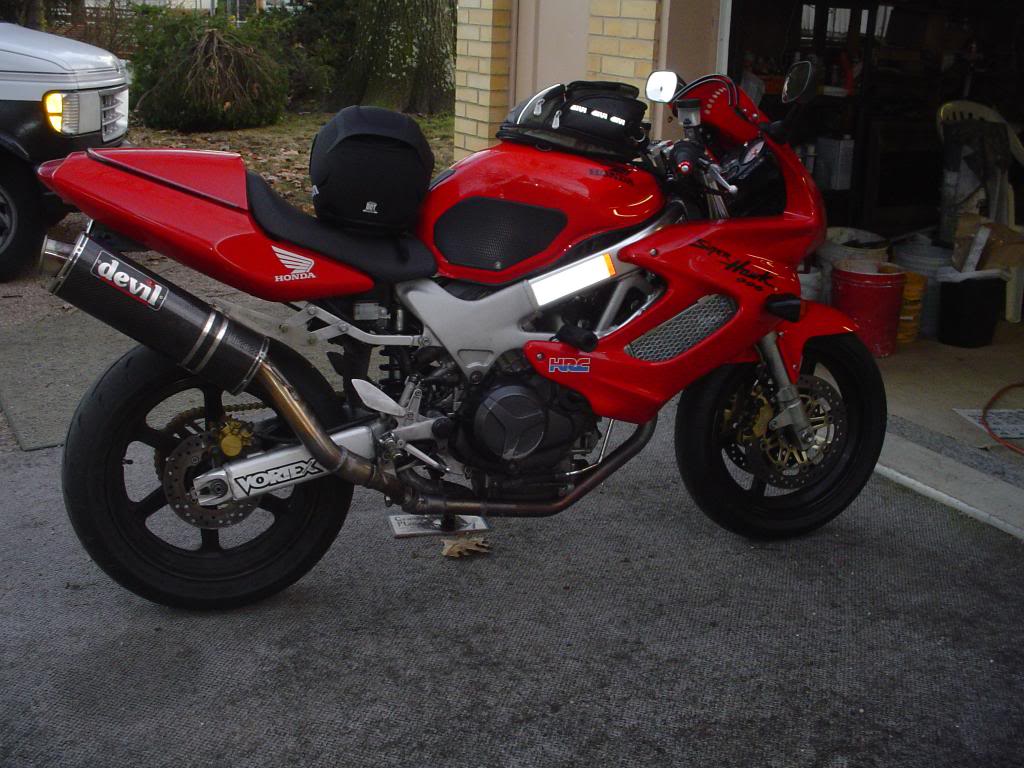

a little feed back on my recent 2 into 1 mod.
sounds good but totally different than any 2 pipes I've heard. The best I can describe it is rapid pulse, throaty, kind like a pissed-off, 4 stroke chainsaw.
Did my friend Hawks carb mods exactly because it didn't run good at above 7000 in 5th and 6th, i.e., acceleration slowed toward the top of the rpm range in the higher gears.
Below that runs good or maybe better than previous, so I decided to try some 93 octane to see what happened. On the third tank now and this improved performance significantly in the upper ranges...Go figure. Doesn't bother me cause it's only a little over a buck per fillup. The color of the pipe seems perfect, not black, not grey, just right.
Gonna get bigger pilots and mains to see if that improves it with regular gas for my own curiosity.
I love the reduced weight on the rear(main reason for doing this) because of the improved lean-in and cornering, and it's esp noticable in quick transitions.
Definitely happy with this mod.
Old Nov 18, 2012 | 06:10 PM
  #73
nath981's Avatar
Posts: 2,934
From: altoona, pa
Just did a couple hundred miles today(45deg chilly) and I can say unequivocally that this mod is awesome, if for nothing else but for shedding the overweight OEM sleds. If you can't tell the difference in decel, accel, lean, bump absorption, etc., I feel sorry for you. Getting rid of all that weight and replacing it with a featherlite carbon fiber, or even 2, is definitely one of the most significant improvements I've made. Transitions like a 600 now. There are naturally some other contributors for sure, but the weight reduction is significant none the less. I wish i would have weighed all that **** against the new set up when i had it all off, but like they say, or maybe just me haha, wishings for fairies.
I need to thank my friend Derek again who gave me this Devil pipe and I wish(dam fairies again ha) I would have installed it when he first offered it to me a year ago. Had this opportunity never presented itself, I know i wouldn't have even considered it and that, i know now, would have been a big mistake in terms of the vast improvement in handling alone.
Like I mentioned previously relative to engine performance, with hawk's carb set up, it runs a little stronger at the bottom and a little weaker at the high end of 5th and 6th, but 93 octane has mitigated this condition to an acceptable level. Runs better everywhere compared to 87 octane including acceptable in 5th and sixth. The pipe color is perfect too. If it never gets any better, it still runs plenty strong for me.
I ordered 50 pilots and 185 and 188 mains from Jets R Us to see what that will do with 87 octane, so I'll report on that later good or bad.
Some pics below, oh, and that helmet is an Icon Airmada, another worthwhile upgrade if anyone's looking for better aerodynamics for less of a neck workout.

Old Nov 18, 2012 | 07:02 PM
  #74
I like the clean look looks sharp, but you got to do something about these rear blinkers bro'....
Old Nov 18, 2012 | 08:33 PM
  #75
nath981's Avatar
Posts: 2,934
From: altoona, pa
why???? i can't see them. haha.........Had to do something because of the long pipe you wanted.
Probably have to go integrated but don't know about PA inspection in terms of distance side to side.
I think the looks of the pipe came out alright, but the real benefits relative to reduced weight are more than satisfactory to this rider.

They also state that a stepped header is basically a waste of time, yet the header that has been shown to make the best bolt on power gains on a SH is..... wait for it...... a stepped header. Can you tell me why that is true if the tuning procedures are the same for both types of engines.
Also you have gone from stock mufflers to a single exhaust set up. So can you say the engine is making the same power or is your seat of the pants dyno being tricked by the weight loss?
Using the formula of every 7 pounds removed is equal to gaining 1 hp you should have picked up the equivalent of around 5hp(using approx 14lbs per side and then eliminating one side completely.)
Now the whole chopping of one side of the stock exhaust will give you a system that works as well as the stock set up discussion. Sorry I don't see it for a number of reasons.
First would be why do they come with dual exhaust to begin with? This would apply to just about ever 1000cc or larger 90 degree v-twin that revs past 8K RPM (Think Ducati, Suzuki, Honda).
All these bikes are built to a price point, so why add bits that are not needed? If a single sided system worked as well or better, why not set the bike up that way and save more than just a little $$ over the production run?
Then lets look at the stock header. Yes it has "merge collectors" like your link and also has multiple bends in the rear primary to "trick" the system into thinking the primaries are approx. the same length.
We then come to the part that most folks get wrong. when the pipe splits back into 2 the normal comment is "look at that restriction" Honda left in the pipe. What is really going on is that "restriction" is tricking the exhaust into thinking it is single sided at low RPM (that is why the right pipe stays cool at idle) and a then as the RPMs (and exhaust pressure) rise it then flows as a dual exhaust system.
So what I see on most single sided set ups is that the left pipe is removed.
Now IMHO that is the side that should be seeing the exhaust pressure at low RPM. Routing the gases to the right side has now shortened the exhaust system. Without re-timing the cams you will loose power (the same way adding high mounts loose 1-2hp by making the exhaust system longer). Then at high RPMs you will have an increase in back pressure, which, by your link, is not good for power.
While the mod can work for some folks, IMHO it is not the "Hot Set Up" and has limited applications.
To reply to your last little rant, I'll ask you this. Just how much does my bike weigh? What electronics package am I running? How are my carbs set? How about the exhaust, stock or just looks stock? What engine work has been done?
If you can answer these questions, then you can comment on what performance numbers my bike can generate, other wise you're just flapping your gums....
