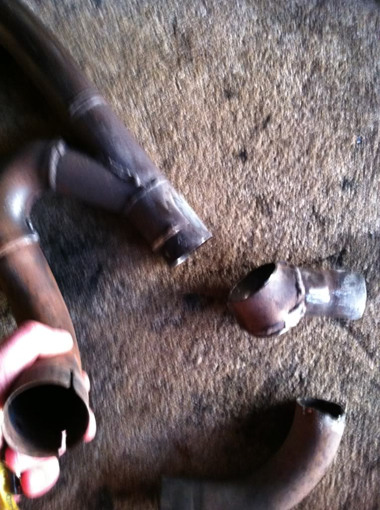

I started install of the Devil 2 into 1. Friend I did some work for gave me this, from a CBR I believe. I will find out later. I cut the OEM muffler as per the photo below and cut the Devil pipe as well to get it set up for welding and brace. I think this will be the approximate location. Once I get it welded on and braced, I'll cut off the midpipe and remove the other muffler.

are you only using the standard right side exit pipe on the headers .
if you do and block the left up you will loose power as the engine wont be able to breath enough.
thats why i cut the rear section of and had a new link pipe made .

Yeah, i planned on cutting the left side muffler exit pipe flush at the juncture and having the hole welded over. Seemed easiest and most logical.
I don't understand the difference, but I'll take your word for it till I get in there and see what you mean. But wait a minute.... takin your word may not be such a good idea based on your history of deception haha. What you've done is a lot neater, but how does it differ?
also, what metals are we dealing with here? OEM pipe? Devil pipe looks kind of yellowish? The welder will need to know what kinds of rods he needs I would guess. I tried to find this out online, but it seems Devil is out of business now acc to a pop up when you bring up their site.

The right side mid pipe is partially blocked at the junction, it is engineered this way with a purpose. If you keep the right side as is and just block the left pipe, you will loose significant power due to this.

i cut off the standard rear y pipe and had a new pipe made to fit straight onto the collector .you will be wanting a nice 2" pipe for the 2-1 .have a look at the pipe i posted . if you only use the rhs exit that pipe is less than that 1.5" i think , and its even less if you dont open it out .
standard exhaust headers are made from stainless steel .
here some pics i took wile doing the 2-1

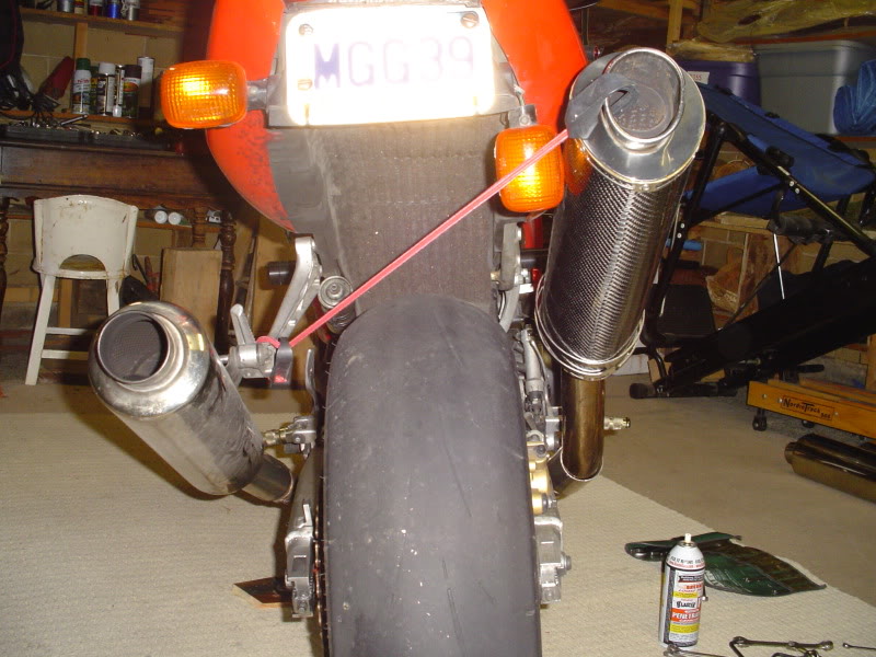

Got the 2 into 1 completed. Pipe cut off and welded.
first impressions: love the lighter ***-end, noticeable improvement in quick transitions. Those freakin OEM pipes have cement in em. The sound is good, albeit much different........more like a machine gun than an automatic weapon. Quick pulses rather than the slower pulses of twin mufflers. Quick vibrations like if you made rapid da-da-da sound by vibrating your tongue. Weird.
Maybe it's that the Devil muffler was made for an in-line four. Not sure if there is a difference? Also not sure what it's off of........the number hand etched(pretty cool like an artists signature) on the backside of the muffler pipe is 116123/13/03 (in case anyone has access cause i think they are out of business?)Made In France. I should of got a pic of it when it was off. I'll try to find out what it came off of, but so far, no luck.
Performance wise, same good low end power, but noticeably slower accel at higher speeds in upper gears(ie, no third gear roll-on wheelies haha). I need to pull the plugs to see the color and will do this shortly. I have 48s for the carbs, but haven't needed to install them yet, so this is probably next.

Dyno's gonna have to be my *** for now, mostly for financial and geographic considerations.
Temporarily added rubber washers to reduce vibration.........helped a little. Footpeg brace on old part of muffler is still rubber mounted also.

I see you used the existing right side pipe to the muffler, did you make sure to cut out the restriction on the right side split at the junction? If not, that would be one main cause to the loss of power mid to top end, kinda defeats the purpose if you leave it there....
Old Oct 28, 2012 | 09:16 AM
  #57
nath981's Avatar
Posts: 2,934
From: altoona, pa
yeah, cut it out, but i need to get in there with a file and smooth everything out. What I might do this winter is clean the inside pipe out by pulling a gas soaked rag through and then coat it with Por 15, a cheap ceramic coat of sorts.

even with the standard rhs opened out its still more restrictive than standard .
for a 2-1 you need at least 2" outlet from the headers to get the gasses to flow .
