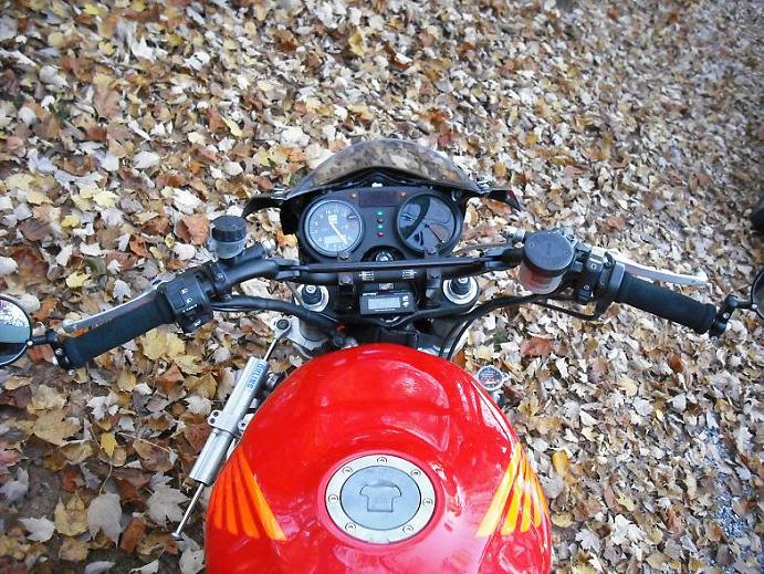

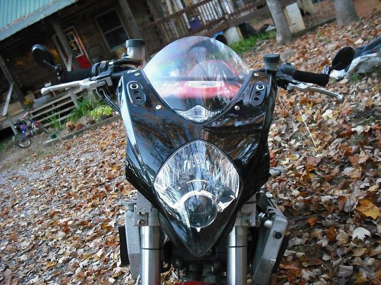

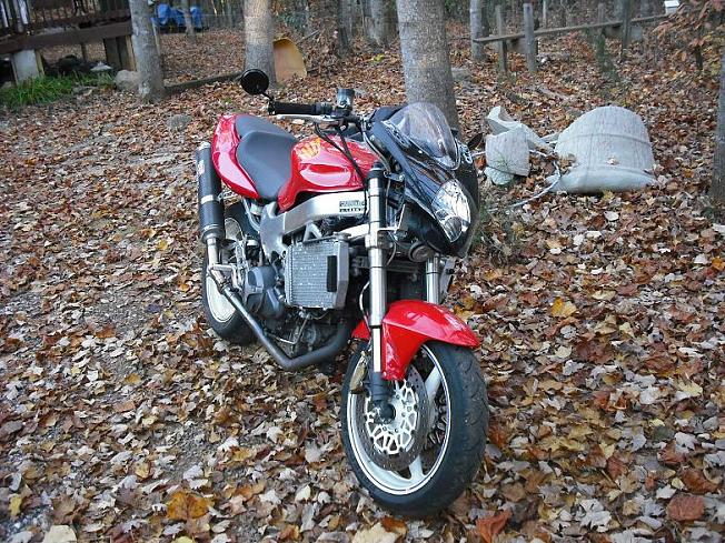

This one started as a retired racebike. Most things are still safety wired. It came with sharkskin RC51 bodywork, CBR929 front end, Fox shock, re-enforced frame, Coerce rear sets, Yoshi carbon cans with headers, Moriwaki cams (grind unknown) with Dynojet tuning. I pulled the body work, added a 07 GSXR1000 headlight, Freestyle Ingenuity bar risers, Yamaha Banshee handlebars (by Moose), mocked up a dash to hold the SPA tach and Summit speedo and CRG bar end mirrors. I've originally tried the GSXR1000 mirrors, but they were too low for any use and I didn't like the look. So I added the bar end mirrors and trimmed the fairing by 3". I like the look much better now. I have most of the parts to move the radiator to the rear, under the seat. Sometime this winter, I'll pull the motor and get it painted, silver and gold are my current ideas. Then paint the frame gloss black and the fairings and wheels flat black. The dash is just temporary, so there's machine shop work in my future. Anybody in western NC have a milling machine?

did you set up your sigma like you would on a pedal bike? i have one of those sitting at home and am pondering doing the same. any tricks to it? how did you mount the magnet on the wheel? thanks!

Flyingeyepro, just out of curiosity where is your frame braced? I see the swingarm. Anything else?

looks like you got rc51 radiators on there too.

Sorry for the delay, it's been an interesting winter so far. The frame appears to have been braced around where the tank, seat and top cylinder meet. There are panels that have been added and welded to the inside voids. I hope to be pulling the motor in a few weeks and will snap some pictures. Yes, those are RC51 radiators. Those will be up for sale soon, if anyone is interested. Assuming the underseat radiator mounting goes as planned.

Looks good. Just called for a price on the FI risers. Pricey, but they overcome the angle on the 929 triples.
