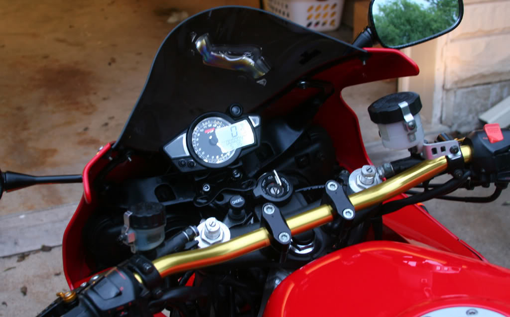

I like this mod so much that it was one of the first things I did to my new (used) vfr. I think I did a write up on it(?). Anyway, here's some pics of it.

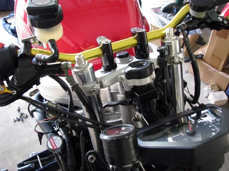

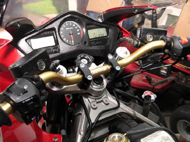

Superbike bars on a Superhawk.
Things slowed down and I finally got the superbike bars mounted and fully installed.
I followed Superbling's description.
There are pictures attached of the parts, the finished job and a few details of note.
Dave states that these bars "barely fit" without modifying or replacing stock wiring and hydraulics.
I can't stress this enough. "Barely"!!!
Pictures

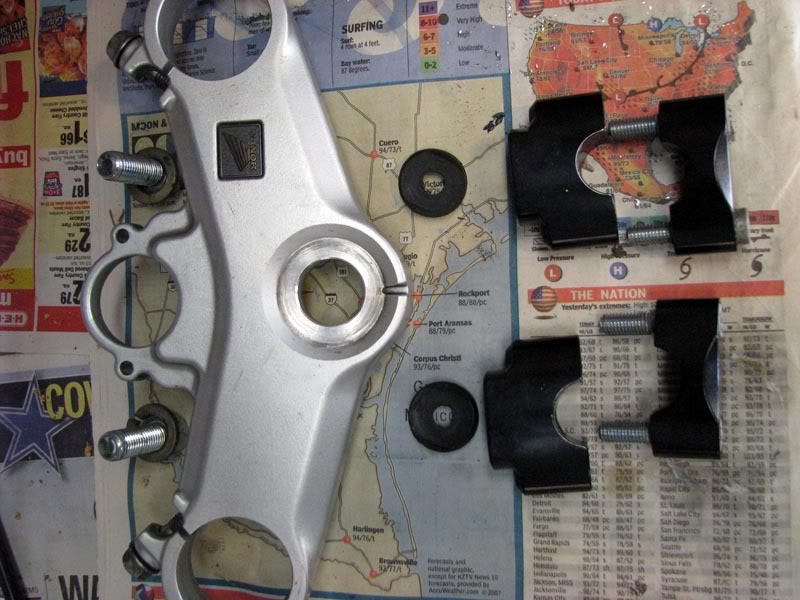

1. parts required
2. premount. old and new bars both in place.
3. after conversion from front.
4. after conversion from rear.

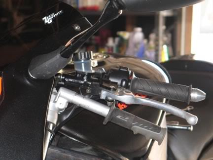

5. closeup of clutch master cylinder/ left fork tube interference

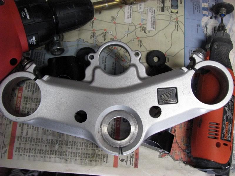

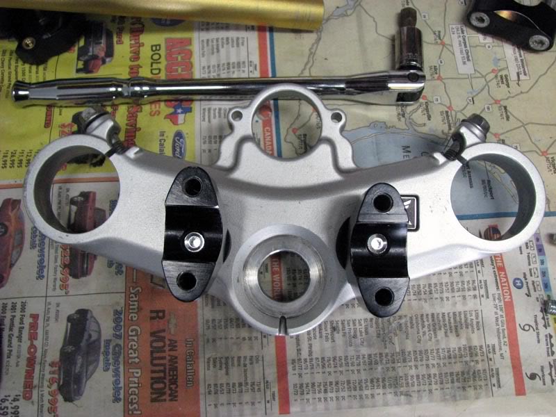

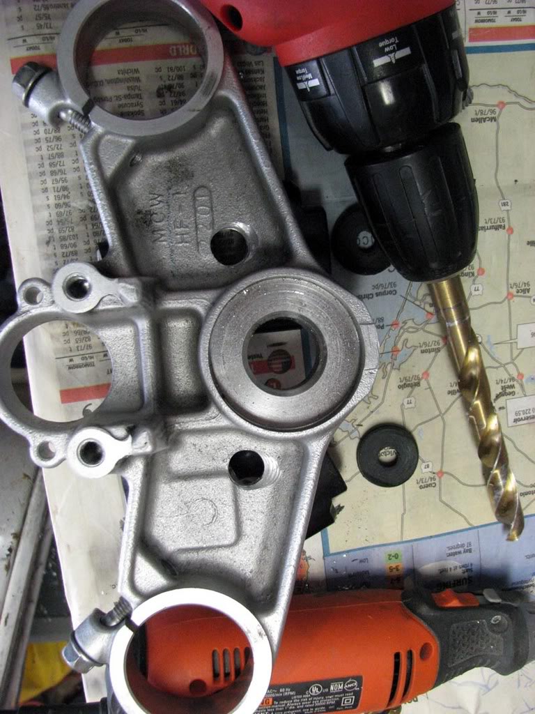

To determine where to drill for the bar mounts, I preassembled the bars and mounts held them in place and traced the outline of the mount on the top tripleclamp. Then I located the center of the hole , tooka deep breath and drilled a 1/8 pilot hole, followed by the 10 mm hole.

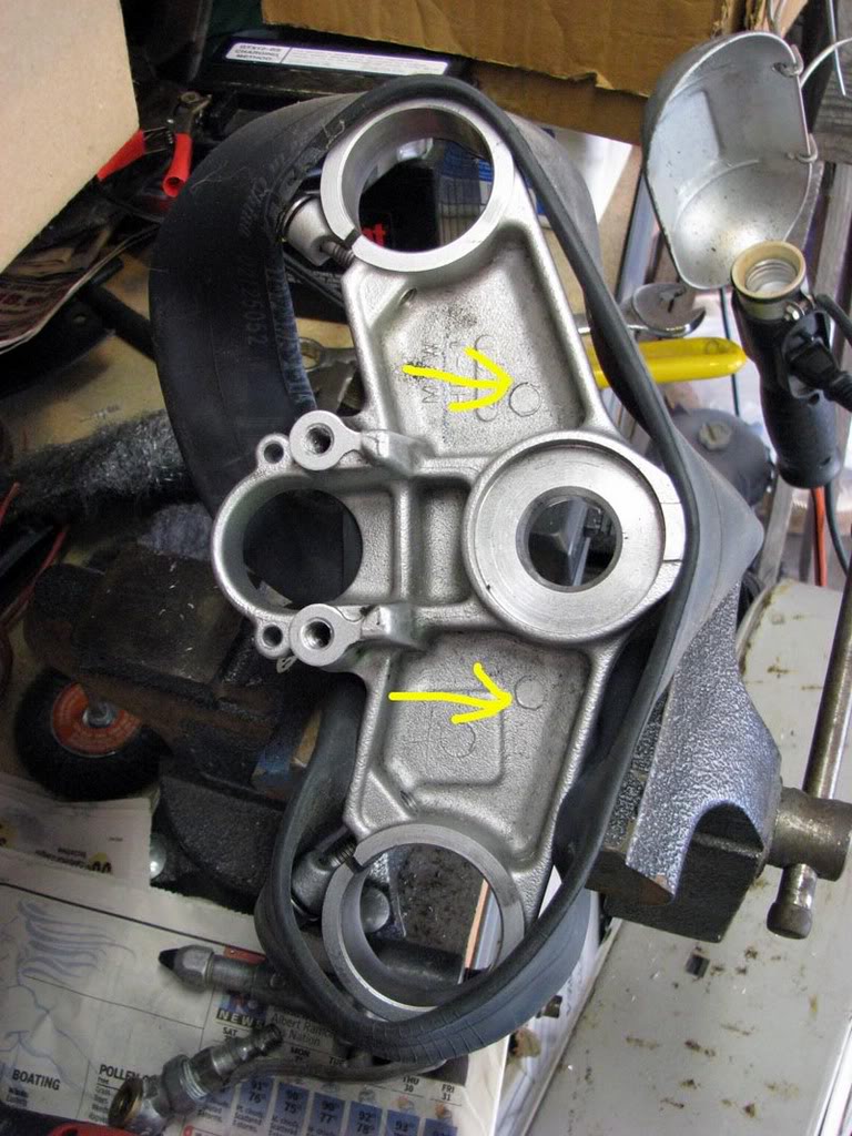

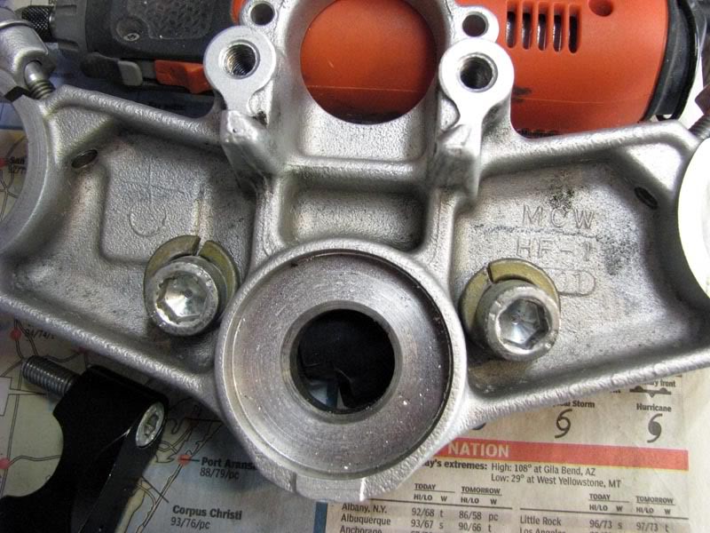

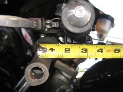

I'm now on my 3rd install on yet another VFR/CBR hybrid project. This particular install will require longer throttle/choke cables but the wiring has plenty of slack.
I'm using TAG mounts #4092 (5mm rise) sourced from ebay but any dirtbike oriented place should have them. Just make sure they have a separate bolt that threads into the bottom. Cheap drag bar with small rise also sourced from me-pay.

I use a lock washer plus locktite on the threads, it's very, very secure. The bolts thread into the mounts for nearly an inch. It would take for freekin' ever for one to vibrate out. IOW, you'd have plenty of warning of one loosening before it would become dangerous.
BTW, that's a superhawk clutch m/c in the pic. So I gained about 10ft/lbs of torque!!!!
