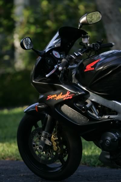

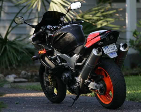

After using VFR bars for several months and putting in a 1600mile long weekend a while back, I've decided the bars are about right in height (slightly higher than those would still be OK) but I'd also like them back a tad more. I just sold a Bandit 1200S in which the riding position was about perfect for all around riding (goldilocks syndrome!); what I call dirt bike style.
So I checked into the kits available ($$$) vs what I thought I could do myself and decided to just do it myself. With a little luck on ebay, I was able to piece this all together for under $100! 8) BUT just as with the aftermarket kits, you'll have to trim the upper fairings so it does "cost" more than that.....
I used a K&N superbike bend bar with moose racing 55mm risers bolted to a drilled stock upper. Stock brake lines juuuuust work (barely), I needed to re-route the throttle cables and loosen up the clutch line from one bracket but all the electrical wires had enough slack.

Damm Doug! This is a very radical but also very nice mod!
How it feel compare to stock for short and long ride?
I guess it's more easy do to wheelie like this 8)
Your fairing seem to be very well cutted, with what have you done this, a dremel or??
BTW, nice calipers and the red to orange fade on your Super Hawk sticker look great too!
Very nice!!

Yeah, they feel great but they really work on long distances which I haven't done with them yet as I just got them on this weekend. But as I said, they are very similiar to the Bandit 1200S I had. I rode halfway across the country in 1 & 1/2 days to get it back home after buying it with absolutely no problems!
Yes, I used a dremel on the fairings, then carefully sanded the edges smooth and applied touch up paint to finish them off. I want to round the ends off some more and remove what's left of the inner lip there but it's fine as is.
The paint "effect" is just a ray of sunshine hitting it juuuussst right. Thanks for noticing. Check the peformance forum for more on the brakes.

Yes, I looked at the aftermarket kits too. OUCH! That's why I did it myself.
I used moose racing 55mm risers I got off ebay. I think anything shorter would interfer too much with the pre-load adjusters. I got the bars from azmotorsports.com.
Here's some more pics demonstrating the difference over stock. It's pretty substantial.

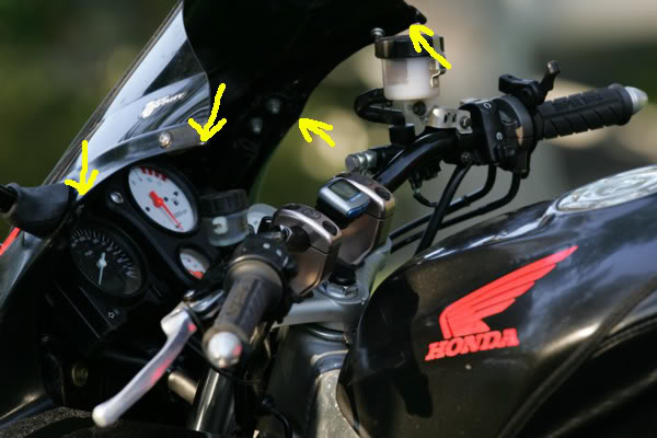

nice... where does it need trimming.. you got a pic that shows the detail? thanks
Old Aug 22, 2005 | 06:38 AM
superbling's Avatar
Posts: 2,553
From: South Texas
Re: Adding SuperBike Bars and risers
I trimmed the area between the two yellow arrows. The red arrow approximates the area where there is interference but just trimming there would look pretty bad aesthetically. I plan to round off the end some more when I repaint this winter.
Old Aug 22, 2005 | 06:50 AM
W-O-T's Avatar
Joined: Jun 2005
Posts: 165
From: Riverside, Calif ( Sun City)
W-O-T
looks clean... very nice job... thanks for the pic....
