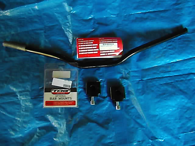

Things slowed down and I finally got the superbike bars mounted and fully installed.
I followed Superbling's description.
There are pictures attached of the parts, the finished job and a few details of note.
Dave states that these bars "barely fit" without modifying or replacing stock wiring and hydraulics.
I can't stress this enough. "Barely"!!!
Pictures
1. parts required
2. premount. old and new bars both in place.
3. after conversion from front.
4. after conversion from rear.
5. closeup of clutch master cylinder/ left fork tube interference

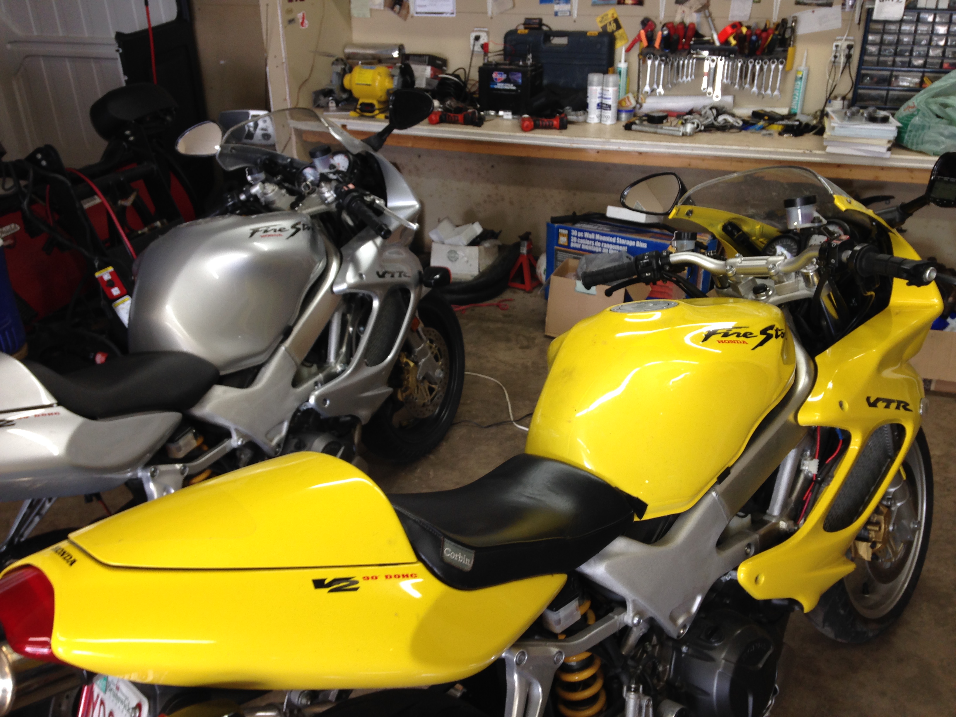

i am adding handle bars. the front brake line T fitting is fixed to the bottom triple clamp. the line going up to the master cylinder is not long enough. did you folks disconnect the T fitting from the fork tube in order to free up length? if so did you still have binding issues because of short length?
another option for me would be custom length SS lines. add the clutch line and we're adding up the $$$ so i''d rather leave the oem lines.
thanks guys

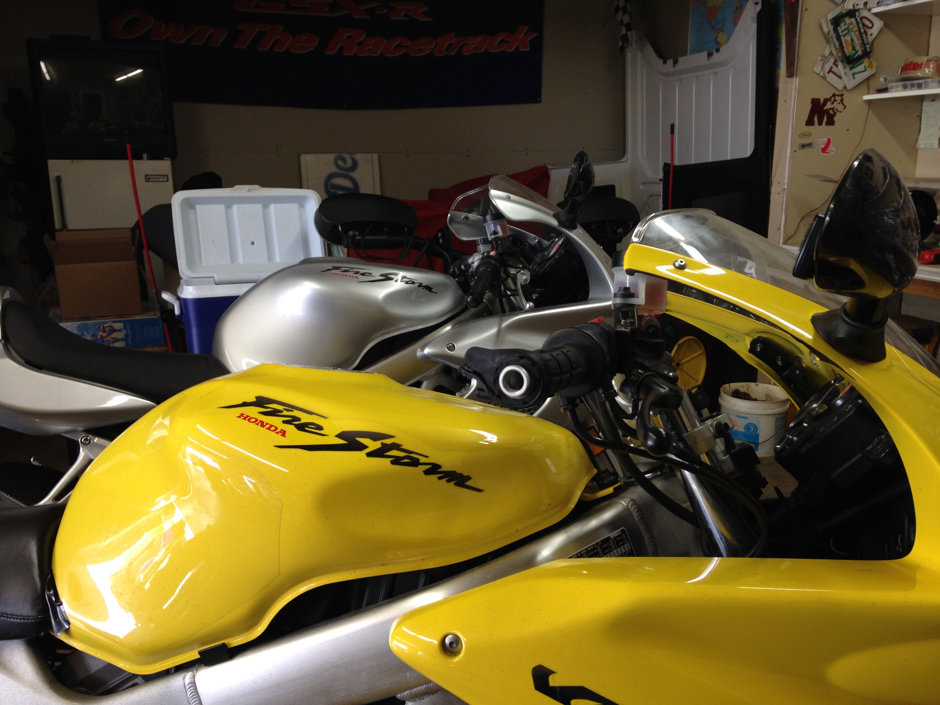

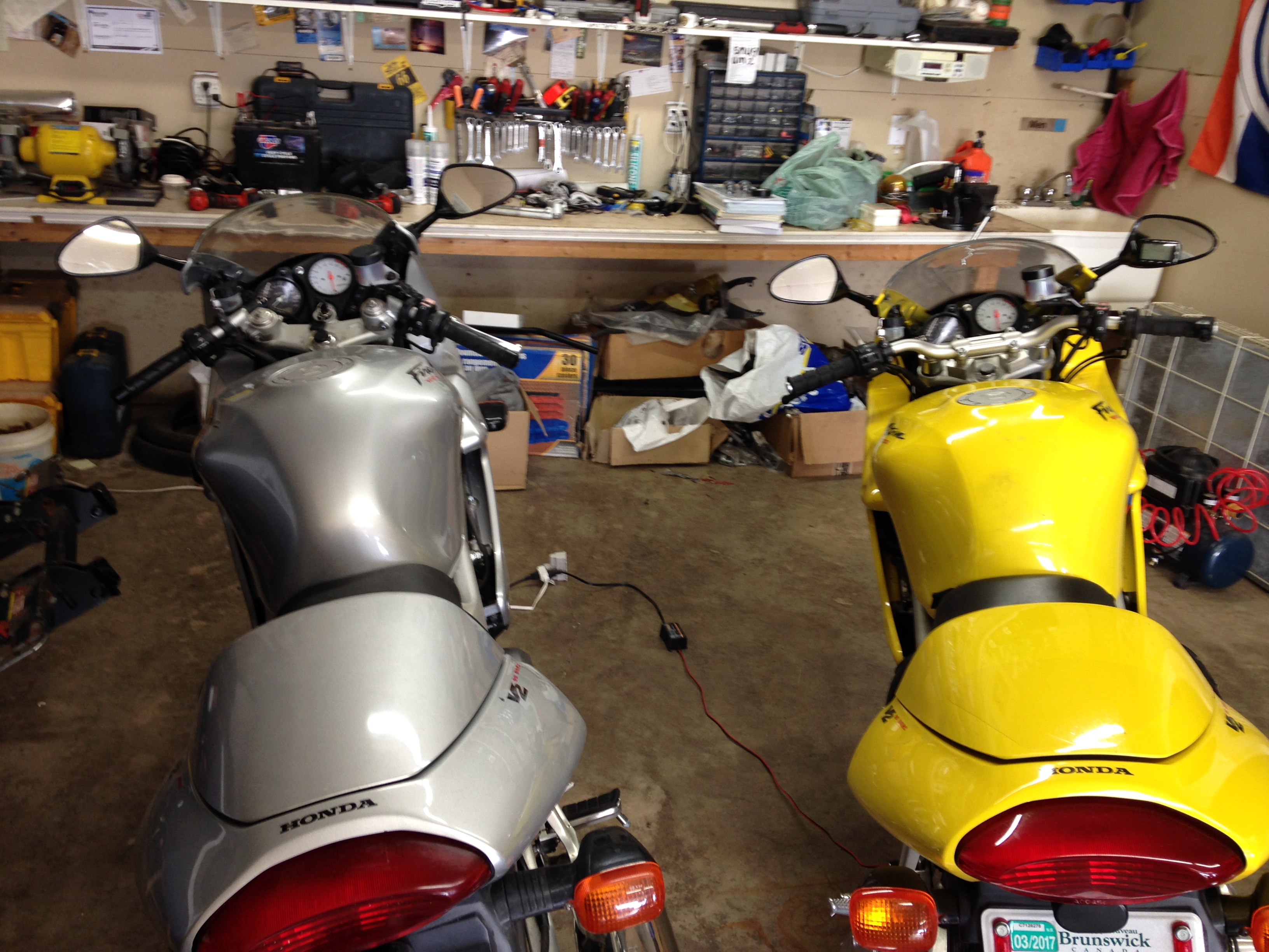

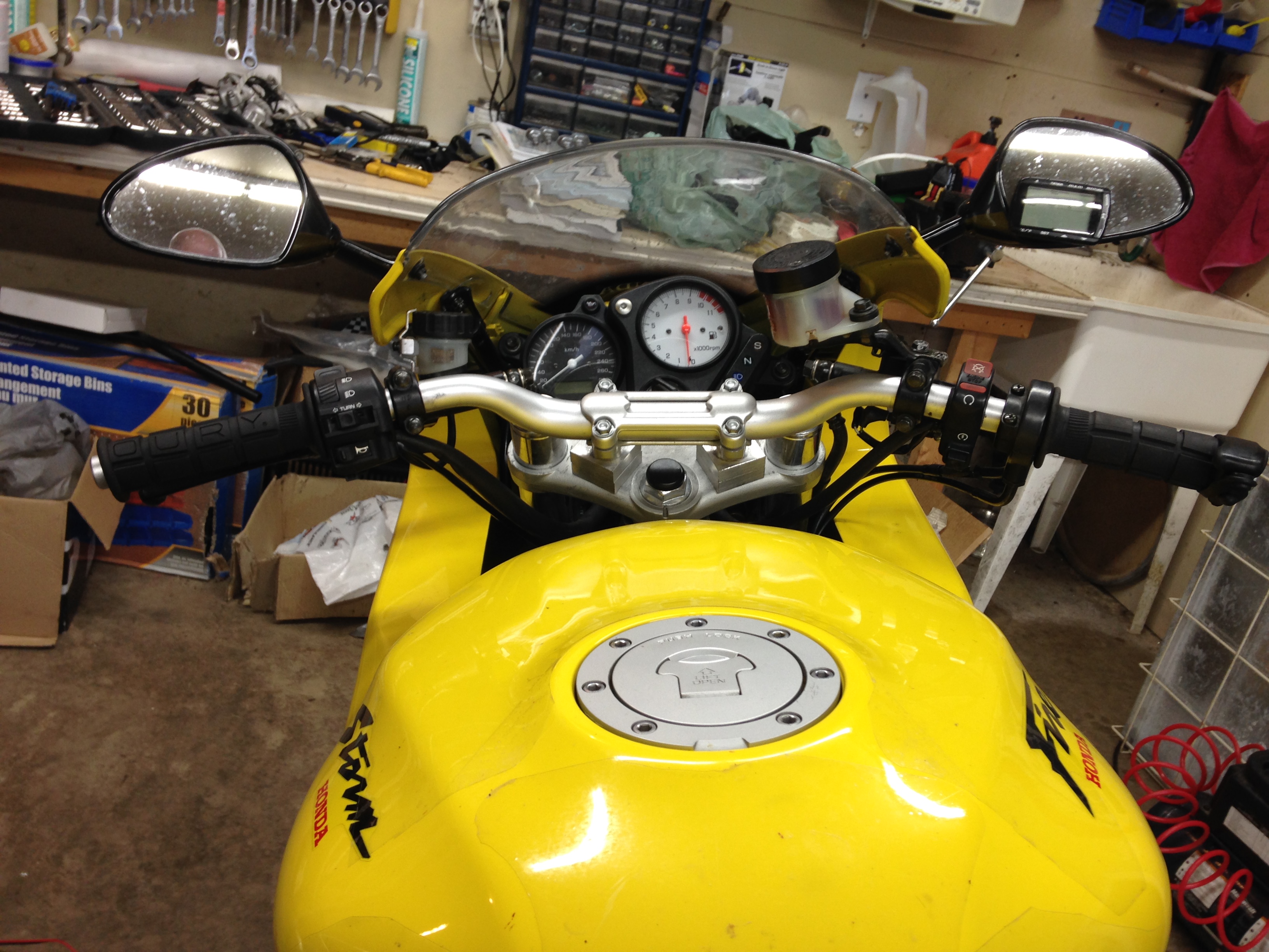

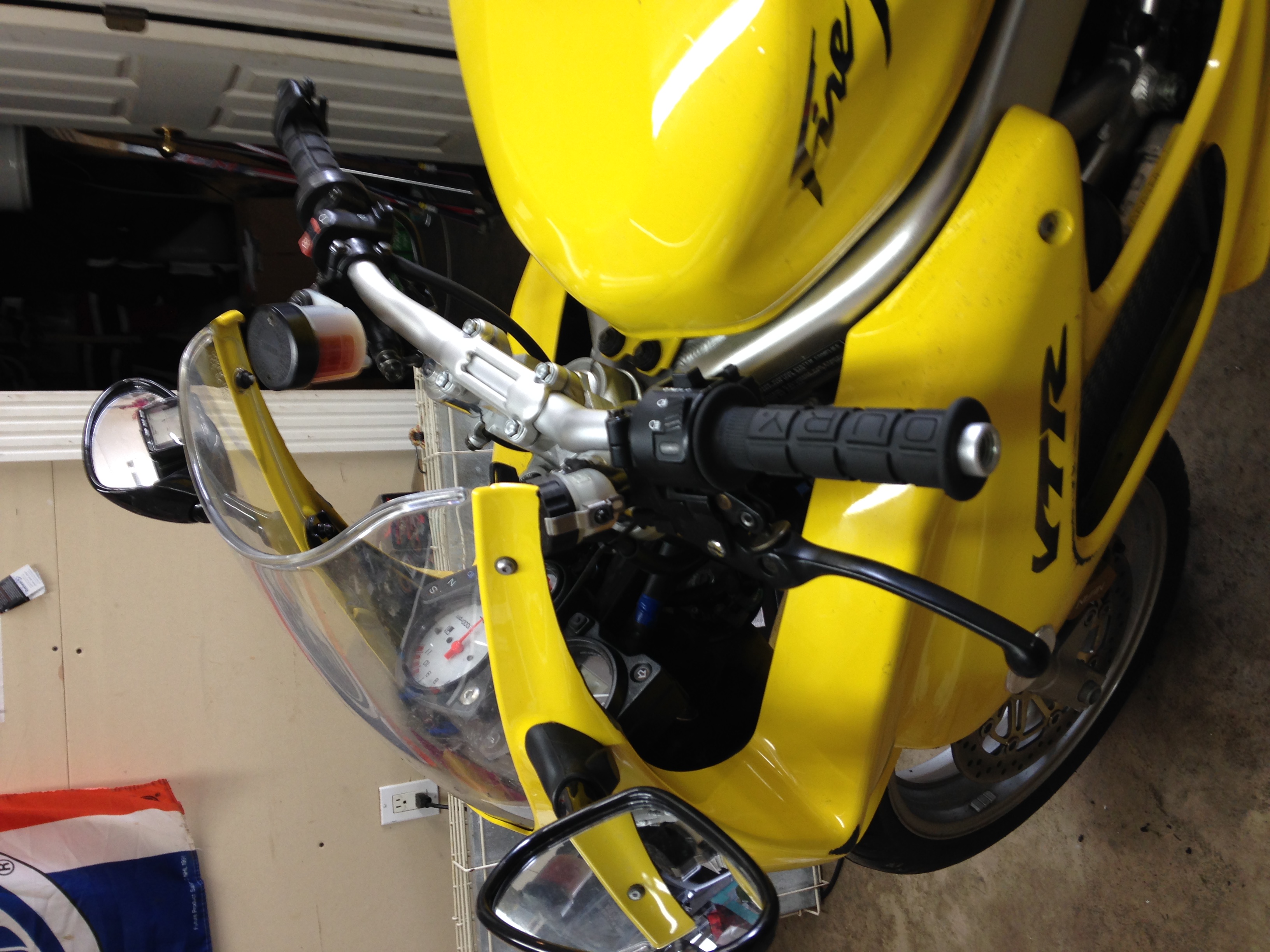

an update.
i bought some triumph street triple handle bars off ebay. 28" and 1 1/8". i had a few minutes to start installing them. i think they will work.
i had to disconnect the clutch and brake line tethers, routed the throttle cables on the outside of the fork tube, had to loosen the clutch banjo bolt to change the angle that the fitting comes off the master, had to fiddle with this and that, etc... hopefully i can finish the project soon
Attached Thumbnails Adding SuperBike Bars and risers-img_2063.jpg   Adding SuperBike Bars and risers-img_2071.jpg   Adding SuperBike Bars and risers-img_2434.jpg   Adding SuperBike Bars and risers-img_2433.jpg

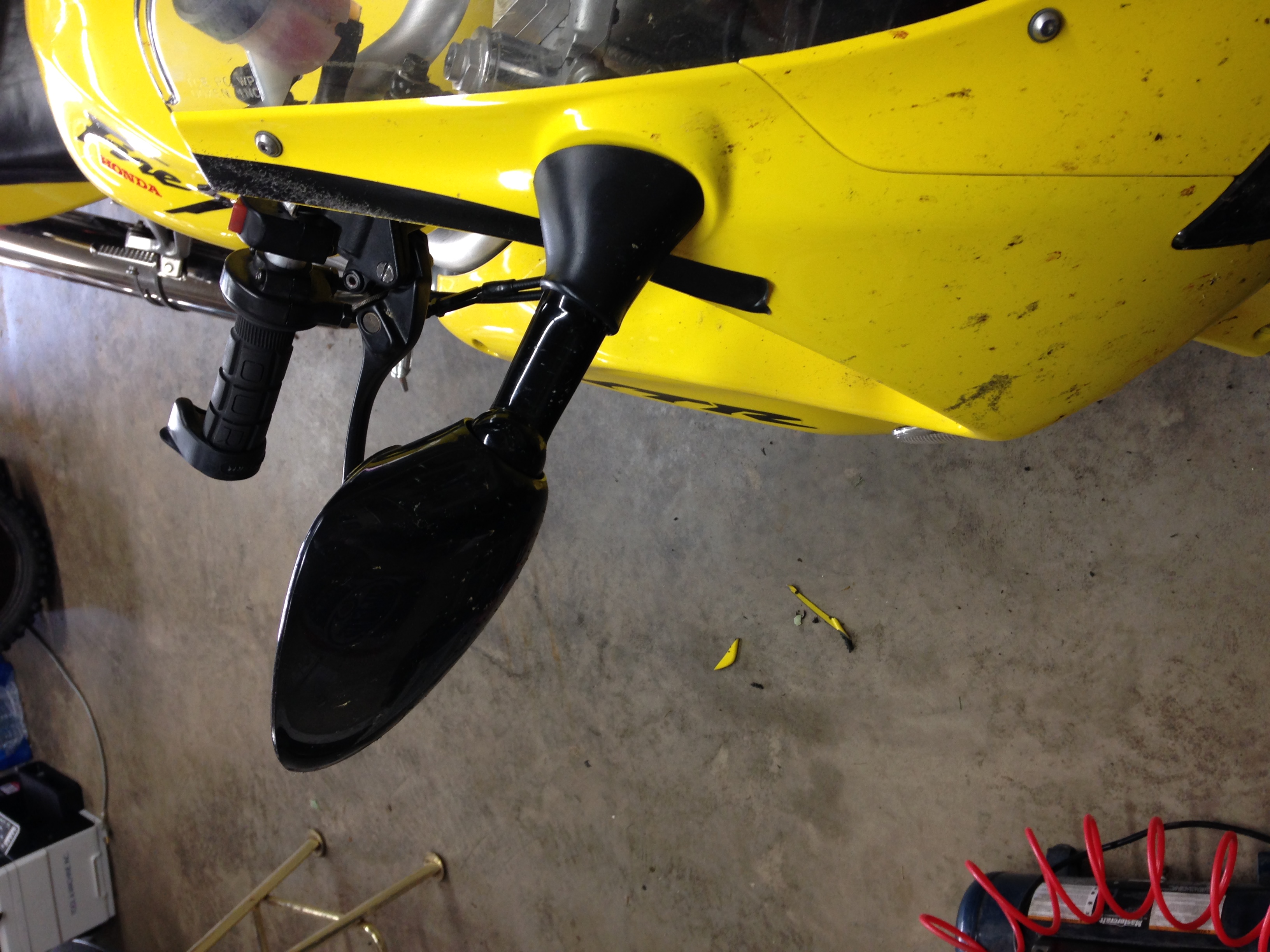

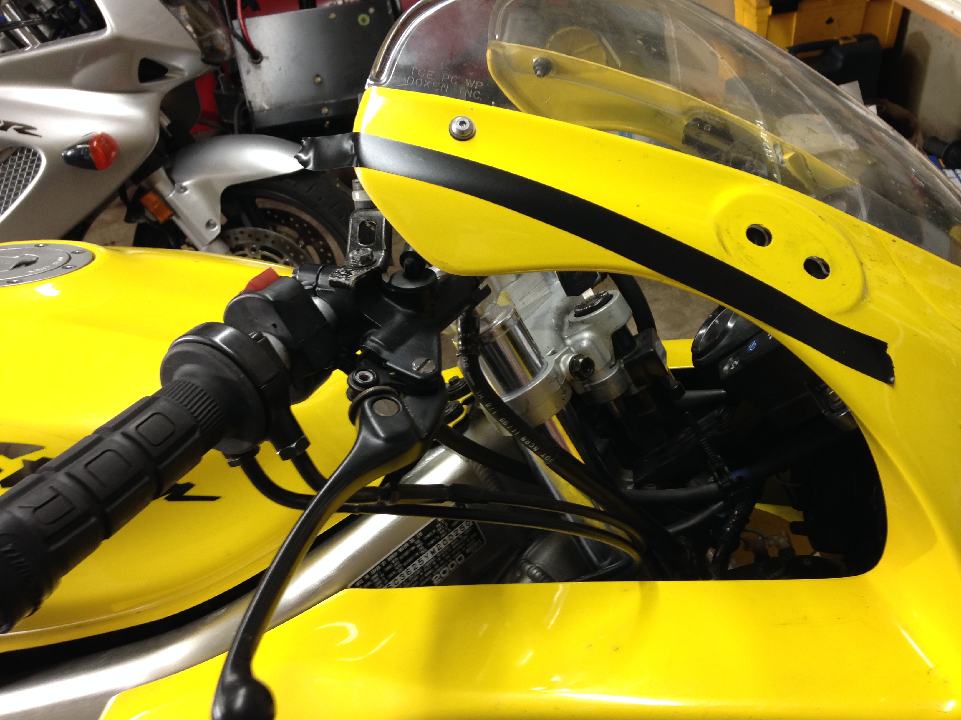

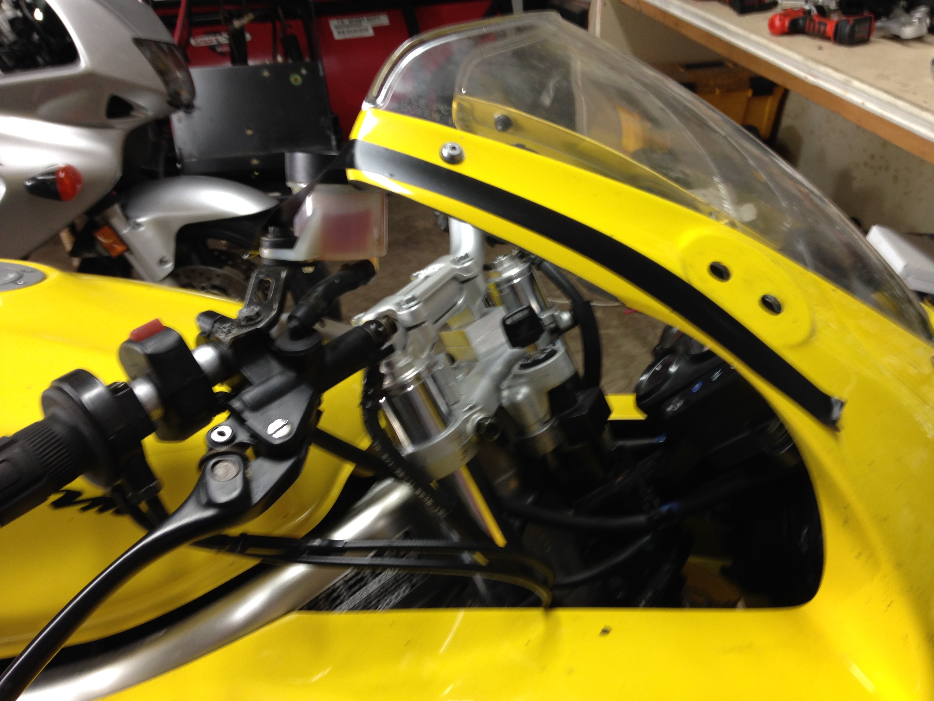

Posts: 1,269
From: moncton nb canada

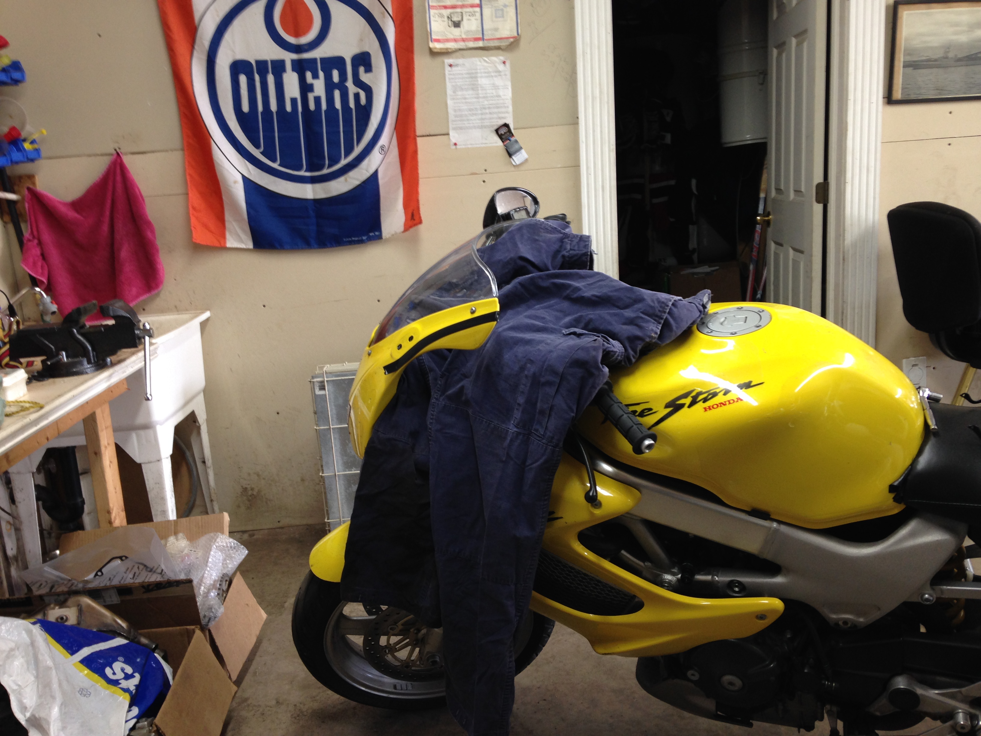

more progress.
ground off the nubs on the switch housings. i use hockey tape on the bar and installed the switch housings over the tape and that keeps them from turning on the bars.
cut the fairing with a 4" angle grinder. in just a few minutes i had things looking ok. i am considering painting the fairings and tank this winter, if i do i will sand and prep the area.
the on/off switch hits the fairing and flips the switch to off. the left switch housing also touches the gas tank. the solution i am thinking of is dropping some weld or welding a small piece onto the turn stoppers. i won't need much.
i had to loosen up various lines and disconnect a few cable organizers. the horn wires were very tight so i just bent the horn bracket up a bit to put a bit of slack in the wires.
i will price out ss clutch and brake lines.
Attached Thumbnails Adding SuperBike Bars and risers-img_2437.jpg   Adding SuperBike Bars and risers-img_2439.jpg   Adding SuperBike Bars and risers-img_2440.jpg   Adding SuperBike Bars and risers-img_2441.jpg   Adding SuperBike Bars and risers-img_2442.jpg
Adding SuperBike Bars and risers-img_2443.jpg   Adding SuperBike Bars and risers-img_2445.jpg   Adding SuperBike Bars and risers-img_2447.jpg   Adding SuperBike Bars and risers-img_2448.jpg   Adding SuperBike Bars and risers-img_2446.jpg

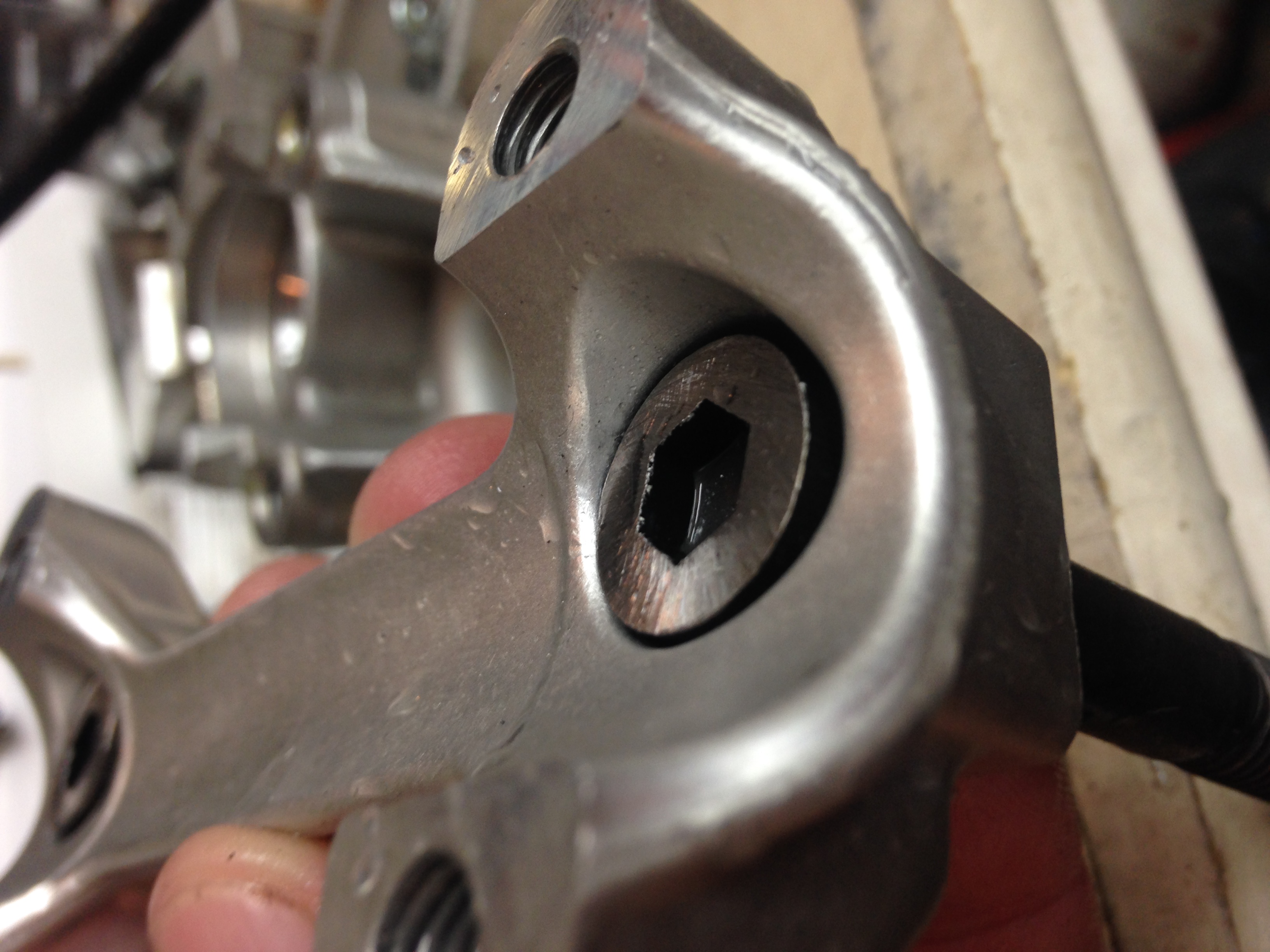

Thanks for sharing all of this progress! I've got a second top triple drilled with the risers and bar installed on it. I'm just waiting for the chance to throw it all on the bike and see if the cables are long enough. I tried polishing the top triple but it was turning into more work than I wanted to do. It looks good from a few feet. Just don't look too closely!
someone on the faceplant vtr group recommended using stick on wheel weights to modify the steering stops. i tried it and they work perfect.

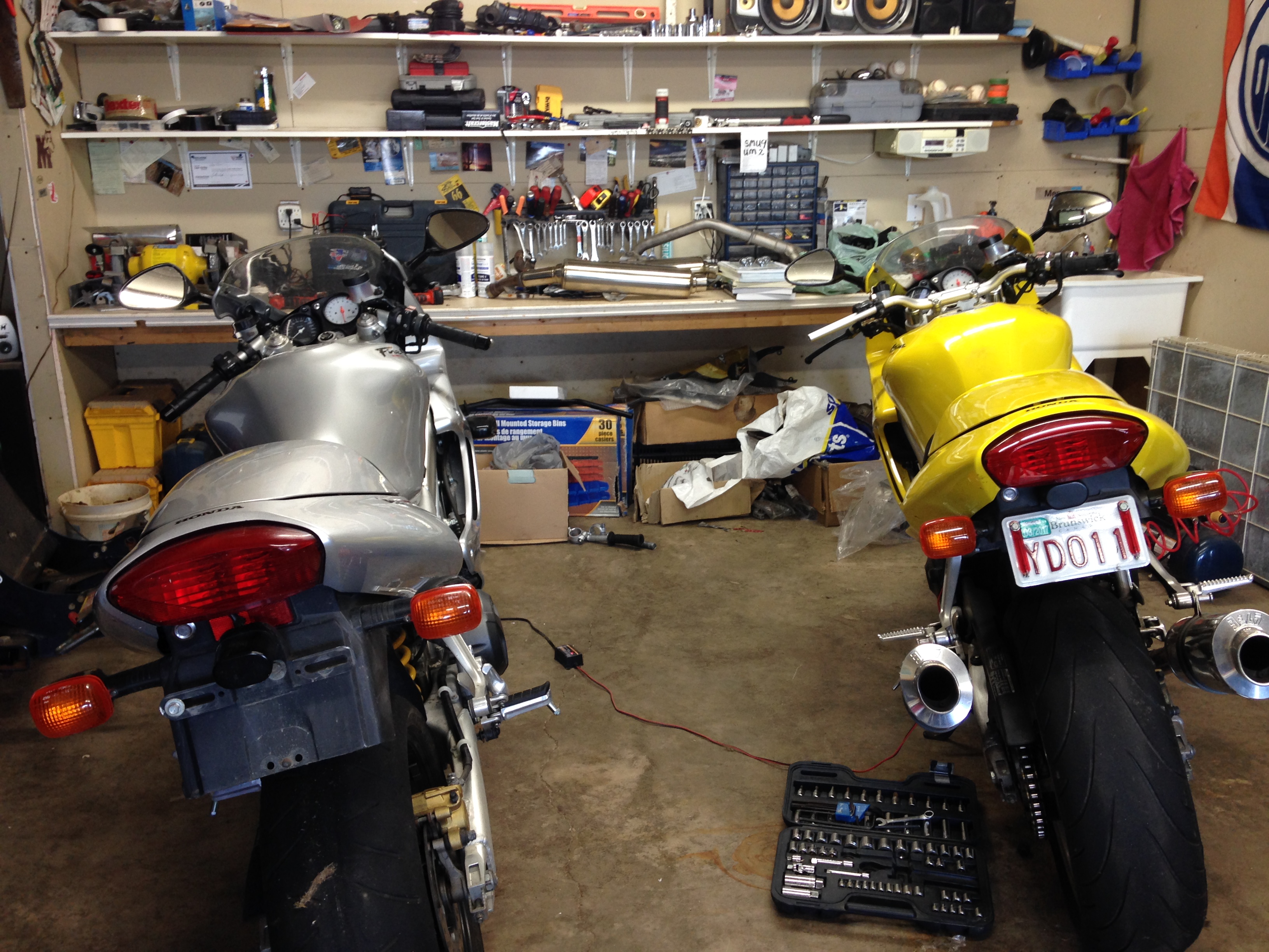

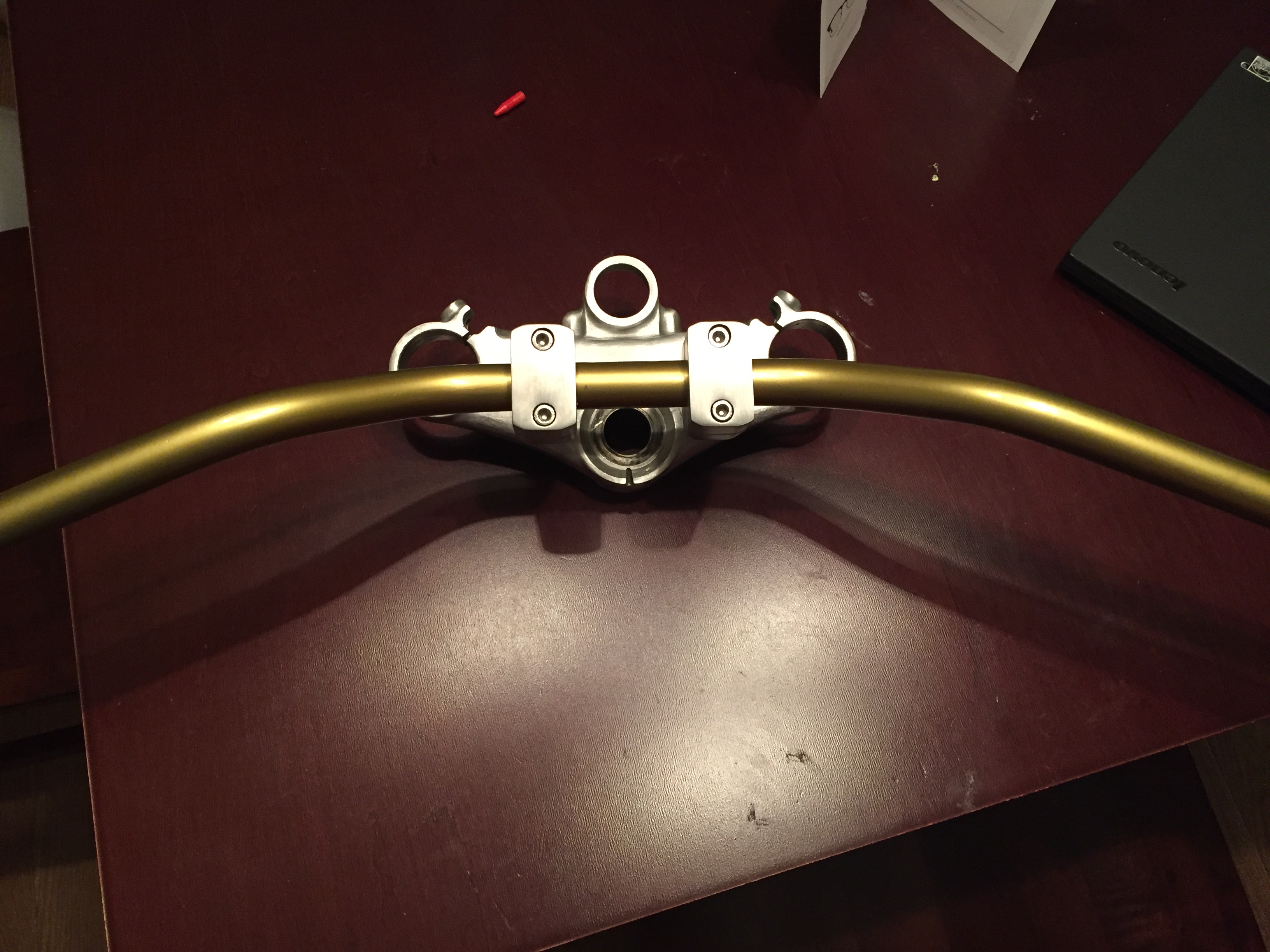

bringing up this old thread AGAIN!, lol I am looking at handle bars for my ducati 750ss so back on the topic.
update on my vtr:
everything came together and my install went well. I have been riding the bike for some time now and not one issue.
here is the list of components I used:
oem top triple clamp off ebay
1 1/8" triumph street triple bars.
1 1/8" beta dirt bike bar clamps.
home made spacers under the clamps in order to get the right height and clearance
bolts to hold the clamps, spacers and triple clamp together.
ss brake and clutch lines
ps:
I find all the bar bend coices a bit overwhelming. so I emailed renthal questions. they replied that me that their model 754 would be closest in 7/8" to the triumph street triple bars. I might be wrong but it seems to me that the renthal 754 is close the classic superbike bend. I suspect that other renthal bends would work too.
7/8"
https://road.renthal.com/shop/road-p...s/road-se-bars
1 1/8"
https://road.renthal.com/shop/road-p...s/road-fatbars
