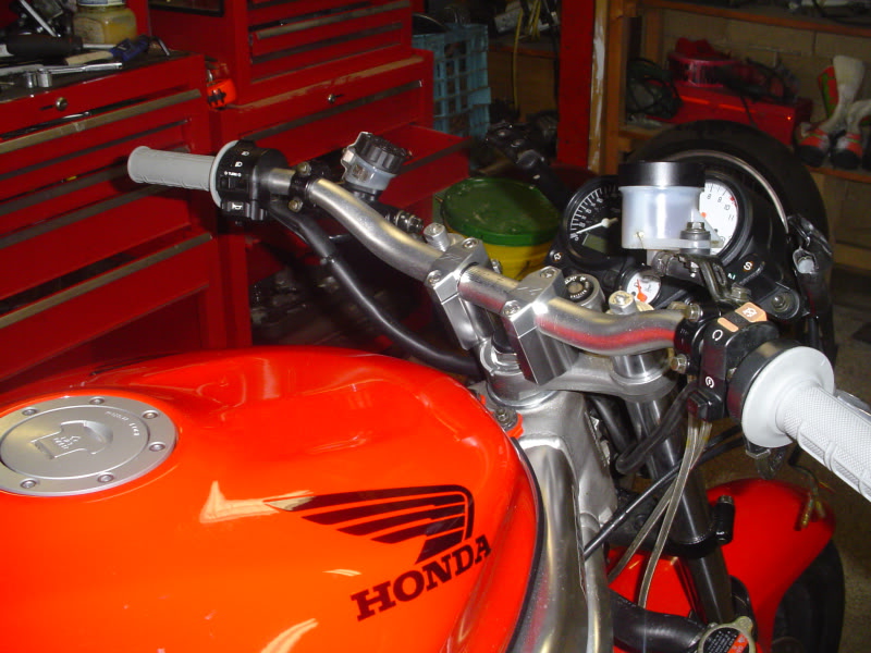

another version of risers
[IMG]http://i608.photobucket.com/albums/tt168/nath981/2005autocarNortonBlazegrandkids002-1.j/IMG]
Old Mar 8, 2011 | 09:57 AM
  #134
nath981's Avatar
Posts: 2,934
From: altoona, pa

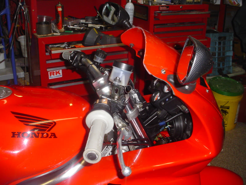

Never had a problem with OEM clip-ons till I hurt my left shoulder this winter.....painful with cllip-ons, bearable on dual sport, thus the riser mod.
just to add some specifics to above post:
wheeling cycle supply(Forrest Green)
Zeta SX Low Enduro Bar..................................$60
Optional lower bar mount 55mm SX risers.........$30
replacement 2pc clamp kit SX ..........................$20
grips were free
ship.............................................. ................... $7
The 55mm risers have multiple mounting positions(mine are furtherest rearward)
Had to lengthen horn wires, re-rout brake, clutch, and throttle cable to outside the fork legs.
Cut fairing and inserted spacers under fairing below mirrors to gain clearance.
Drilled hole in bars for throttle.
Cut some off bar length to reduce width.
Mounted bars with front wheel off ground to assure enough cable lengths.
forks are at OEM position in triples.
a lot of options includ lower risers for no- cut mod, rubber mounts for reduced vibs, and diff bars.

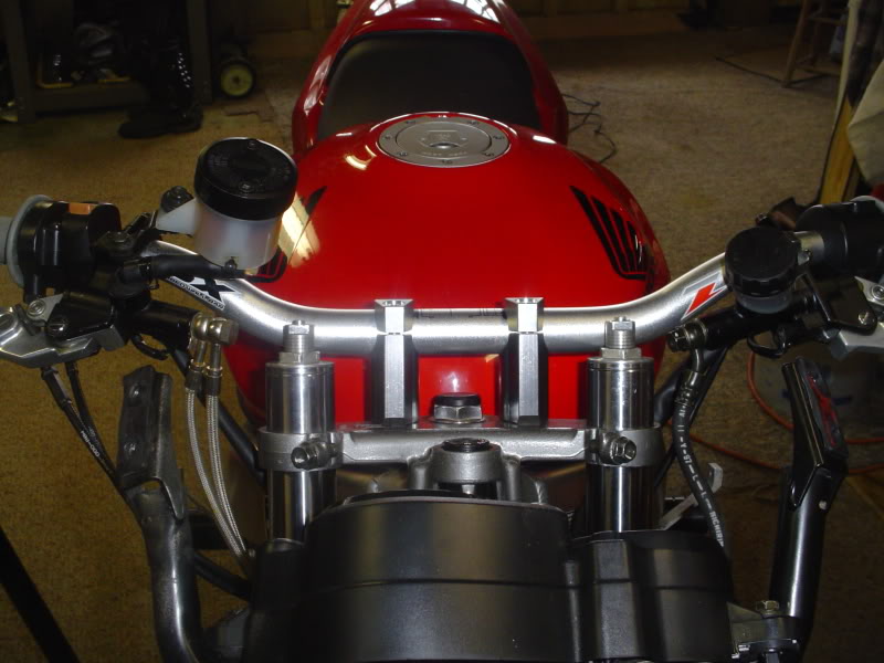

bought spiegler low superbike fatbars(also from Wheeling Cycle, which are much better in that they have a longer area of 7/8" which allows a little room for making narrower. I cut 17-18mm off either end and reversed the risers to the forward position. This places the risers in the center of the triples(as opposed to the rear of the triples as in previous posts with the Zeta bars) and creates a little forward lean ergos and a drag bar feel. This along with the added wind foil reduces windblast a bit. Riders who want to sit back or more straight up should opt for the standard spiegler superbike bars in lieu of the Low model.

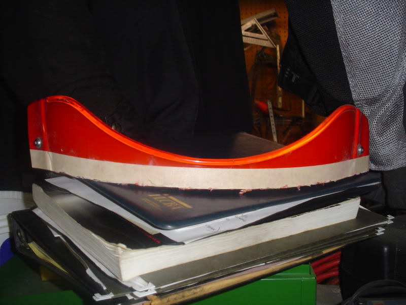

front view of the wind spoiler (from cut off windshield) mounted on thick rubber spacers.

yes, had to drop the forks or raise the triples 10mm (effectively raising the front height)in order to clear the 55mm risers in the forward position. Previously had the risers as far back as possible and didn't have a clearance issue. When i reversed the risers forward, the preload adjusters which are sticking up quite a bit, were higher than the bars. Don't require much preload since springs are matched to rider weight.
In terms of front rear geometry, since the taller 190x55 rear tire and JD,s rear shock mod have raised the rear significantly(could be as much as 24mm total), the front being up 10mm is still 10-14mm lower than the rear. Of course the seat height has risen the better part of an inch and although I'm only 5'8", I like the additional clearance.
the Specs for the bars are on speigler's site(search "speigler superbike low fatbar" and that page will show the difference in sweep and rise and length. If you want a more upright position, go with the standard superbike fatbar(more rise and more sweep) because the Low is more akin to a drag bar esp since i trimmed 17mm off each side. The Zeta catalog and their site i believe lists the specs for their bars. if you can't find info, let me know

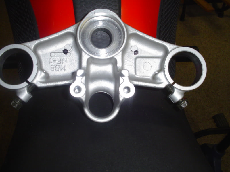

there are honda top clamps you can simply bolt on when you remove the bars job done , easy peasy ,
Old Jun 12, 2011 | 06:30 AM
  #147
nath981's Avatar
Posts: 2,934
From: altoona, pa
really not that difficult to change except if you have to get longer cables and hydraulic lines. I liked the oem clip ons, but i hurt my shoulder this winter, so was trying to get a little diff position. I don't know if the standard spiegler superbike bars would require those alterations, but the spiegler low bar did not.
I wasn't aware of the honda top clamps, but that might be a good alternative.
Old Jun 12, 2011 | 06:37 AM
  #148
CrankenFine's Avatar
Posts: 1,481
Do you know a part # or a source for those?
Old Jun 12, 2011 | 08:22 AM
  #149
motokraft's Avatar
motokraft
Posts: 111
From: dublin ireland
motokraft is on a distinguished road
if you use a top yoke from a honda cb400sf super four , you can take off the hawk bars drop on the top yoke and as long as you dont go crazy with very high or wide bars you can use the stock cables , with a small bit of jostling
im not sure about the brakelines as there are braided lines on any of the bikes ive done
i also dont know what kind of clearance you have with the fairing
some other honda top clamps work , but fyi the hornet 600 is similar but doesent work because the forks a re set a little further apart ,
i think the nt650 deauville top works too (measure to be sure tho !)
i changed computer so sorry im not sure if i have any pics , but the orange and black bike in my profile is done this way ,
Old Jun 12, 2011 | 08:32 AM
  #150
motokraft's Avatar
motokraft
Posts: 111
the honda cb400 93 - 99 definitely works , im sure there are others but wouldent like to steer you wrong with bad info ,
the bike in this clip is done this way but its not very easy to see
YouTube - ‪vtr 1000 firestorm streetfighter short clip‬‏
