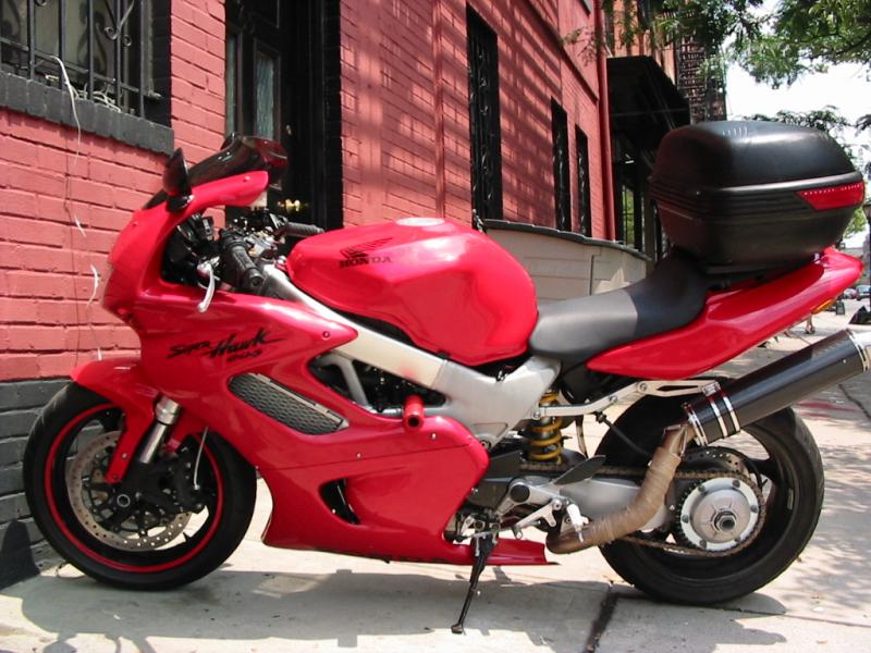

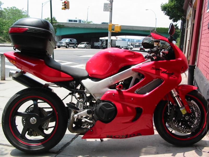

So here is the bike so far. Great handling, comfortable position. Had to carry stuff to work so I bolted a GIVI baseplate onto an extra seat I had. This bike now handles like my SV650 but less wallowy & tons more rip. SV is still a better race bike but for the street this is great.

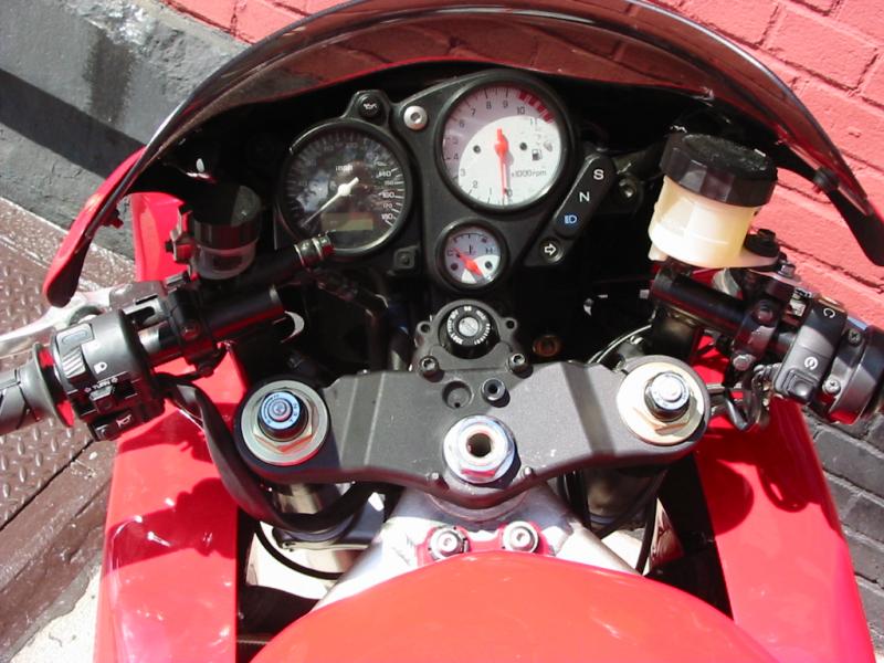

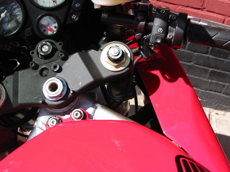

I realize this is a subjective question but can you please describe how difficult it was to do this swap? Also, do you have pics of the triple tree? Did you reuse the superhawk key or the CBR?
Old Jul 6, 2010 | 11:57 PM
I have to say it being all honda stuff it was pretty easy. I have done alot of head bearings on racebikes over the years so if you do the freezer/ heat method they go on easy (I would recommend tapered rollers even on a stock set-up). I bought the parts over the winter pretty cheap (join a bunch of CBR forums). I assembled the whole front end in my living room, bled the brakes, etc so it was ready to put on. The installation only took an afternoon if you dont count the time spent stripping fairing. Figure a weekend. A bit of time for all the other tweaks like controls. The old ignition just bolts right in. Like I said the turning radius is comprimised in tight walking speed left turns but I have an F4 master on the way. This is the way honda meant to do this bike. I mean it is a SUPERhawk right? How did it loose the single sided swingarm of the hawk & not get USD adjustable forks?
