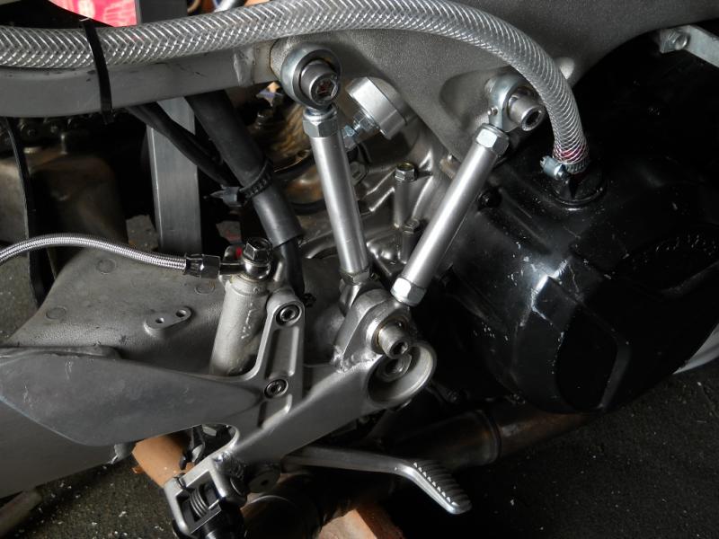

Will get into the garage tomorrow with the camera , also some struts i made to hopefully give a little more support to the frame

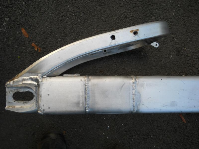

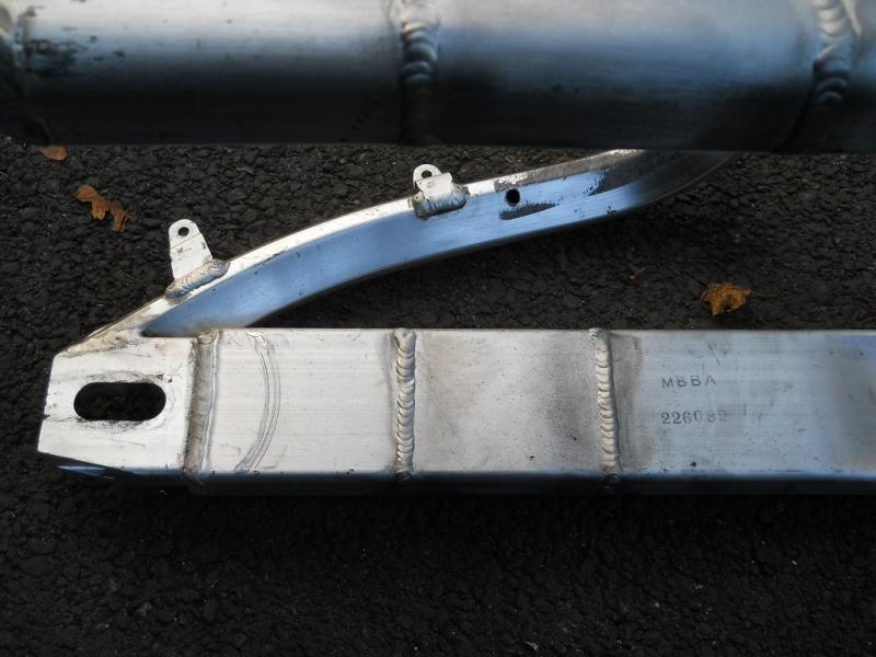

Sorry for the delay, i havnt been able to find my camera so i have put a old shot of the arm before i had braces fitted between the arm and the top brace off a cbr900. the picture shows my original arm having been cut at the adjusters, i then cut off the adjusters + 3" off another superhawk swingarm, i then had made the insert piece you can see now welded between the two, in total this gave 6" over, this really does give me the confidence to drop the clutch without the front wheel going over my head on drag starts
All the best mate
