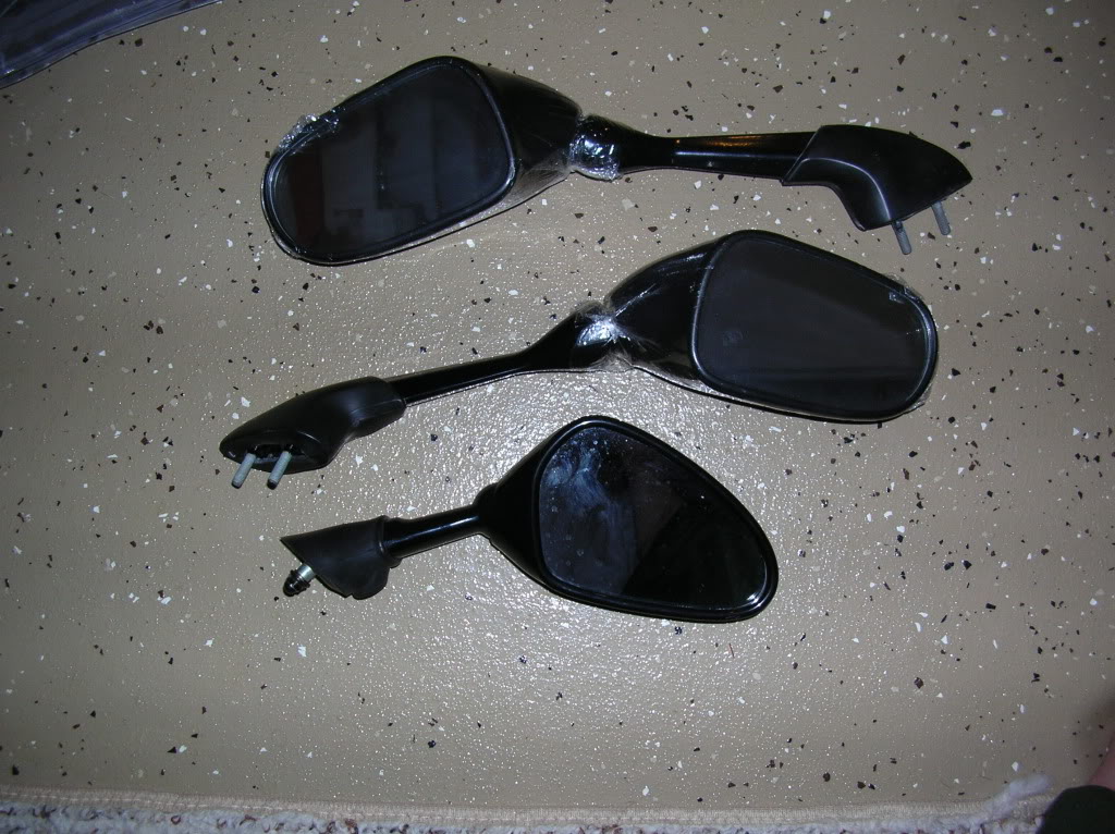

here is the pic of them if it helps out nekkid..
this whole transaction leaves a bad taste in my mouth as i sold what i though to be no problem bolt ons to IDK.... like nekkid said i ended up putting bar ends on mine, so any help to get these mounted up looking purdy for him would br great... nekkid i will have the store narrowed down this weekend.. i'll pm you regardless of what you find out here

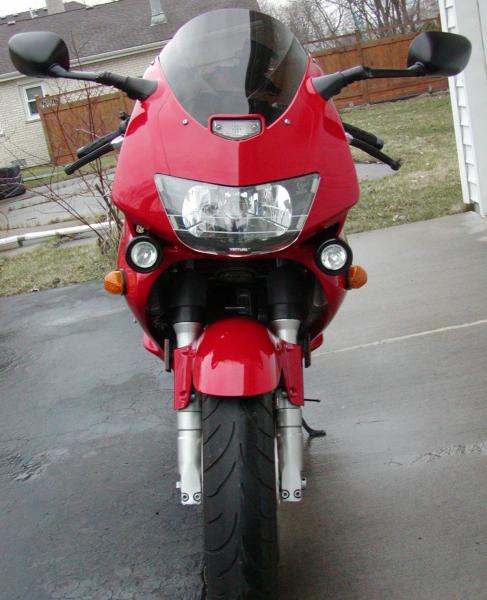

You can unbolt the stems that attach the OE mirror "clevises" that mount to the fairing under the rubber boots, and grind off one side of the "rivets" that retain the stems to the mounts on the R1/R6/FZ1 mirror (and others). Then bolt the R1/R6/FZ1 mirror/stem with spring (wave) washers, flat washers of the correct OD & ID to the VTR mounts. Now you have easy adjustment and OE mirror orientation. I have custom machined, anodized extenders in between R1 mirrors and the OE mounts for a great rear view with 3 angles of adjustment.
