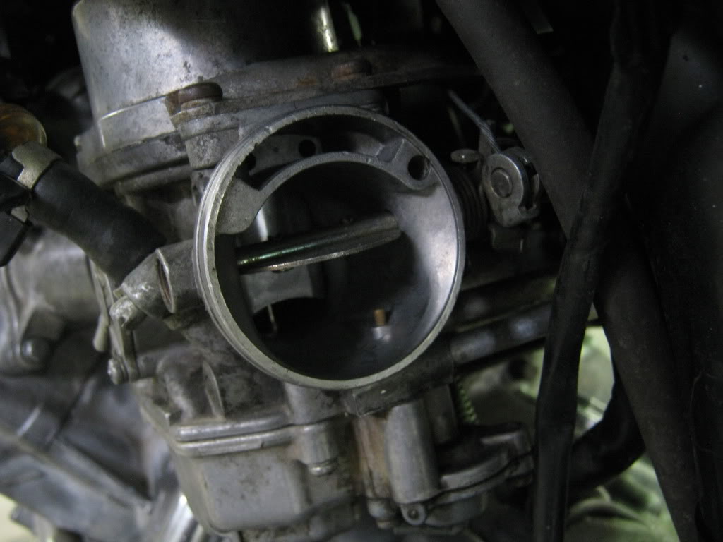

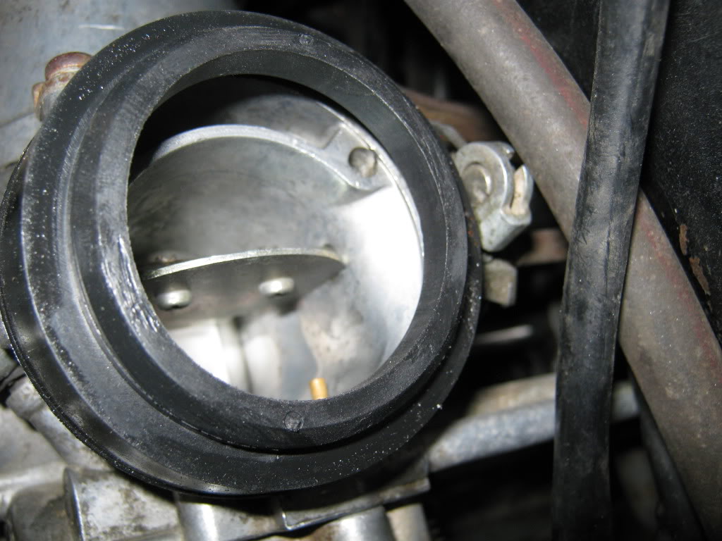

I am attaching a few pics. I did some investigating and the bevel of the rubber end for the filter seems to clear everything, no blockage. In the pic though it looks like it is but that is because its not 3d. Anyways I moved the filters back a little to help just in case. I will try running it a little later.

I really appreciate the ideas guys, I have been going and checking everything you have said. Its good practice and I have been learning more. Stick with me, thanks.

Try a less air test. Take duct tape and tape off 1/2 of the filter and run it. If it runs better, you are too lean, worse and you are too rich.
