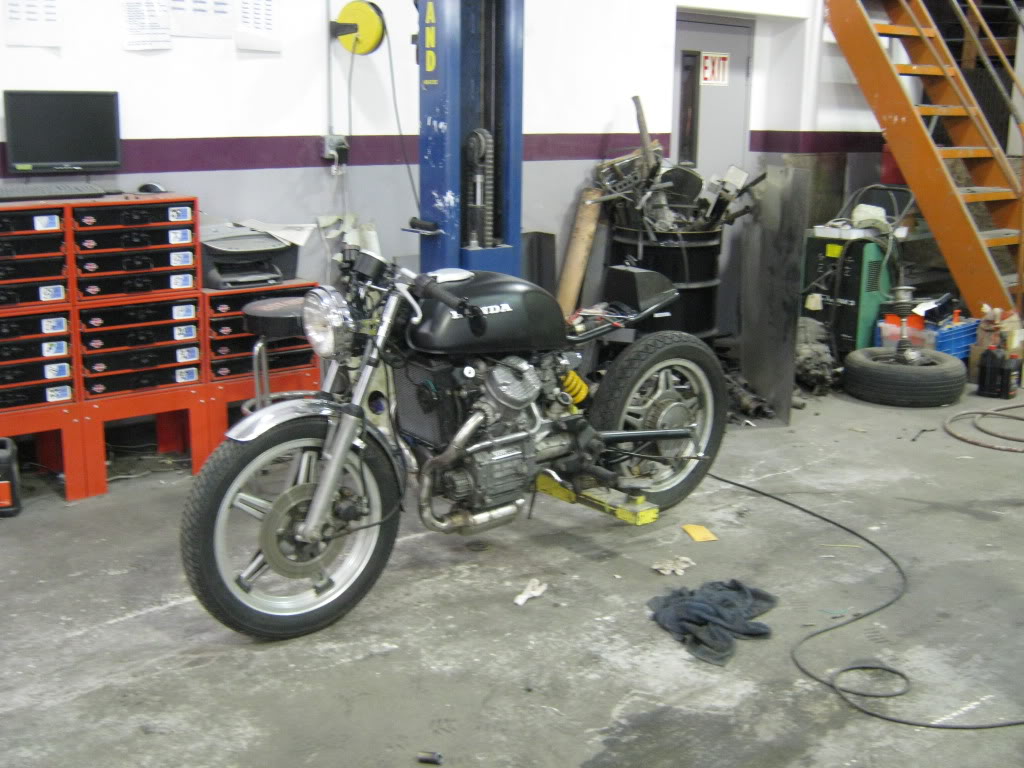

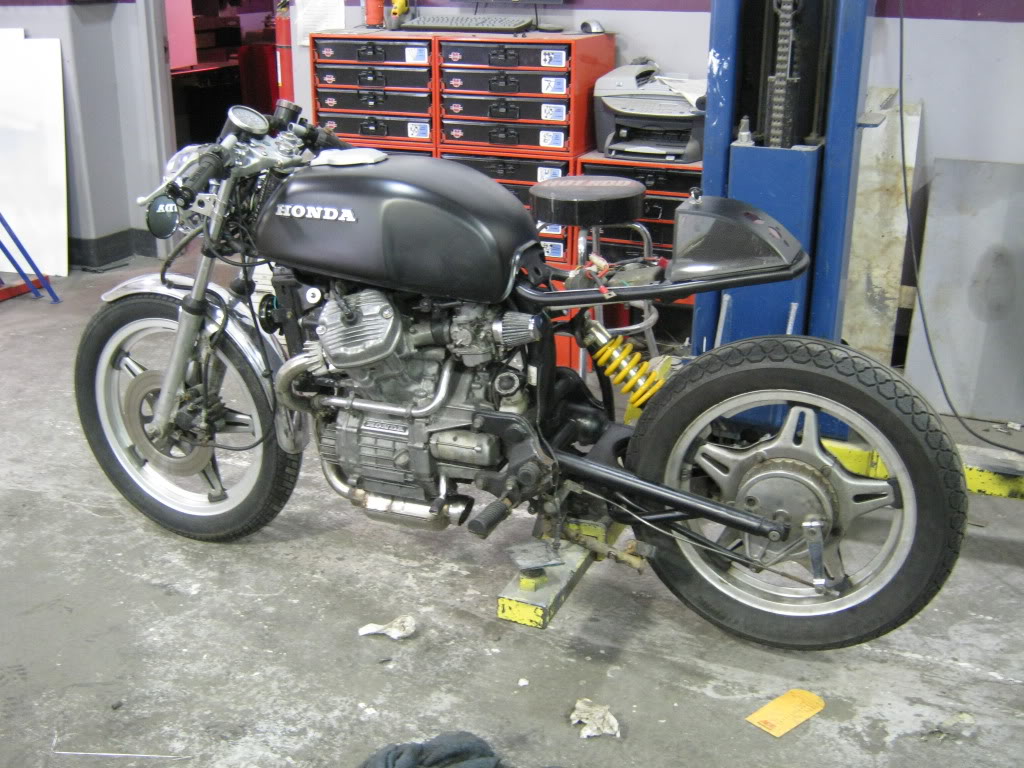

Its beginning to look like a race bike! I got the carbs back on, the shock frame mount painted, the carbs jetted, also finished the exhaust and it is mounted. Just batteries, a seat, blinkers, and the license plate.

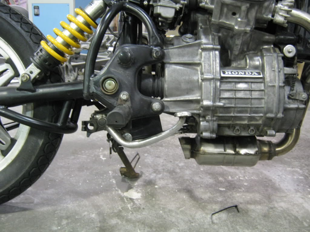

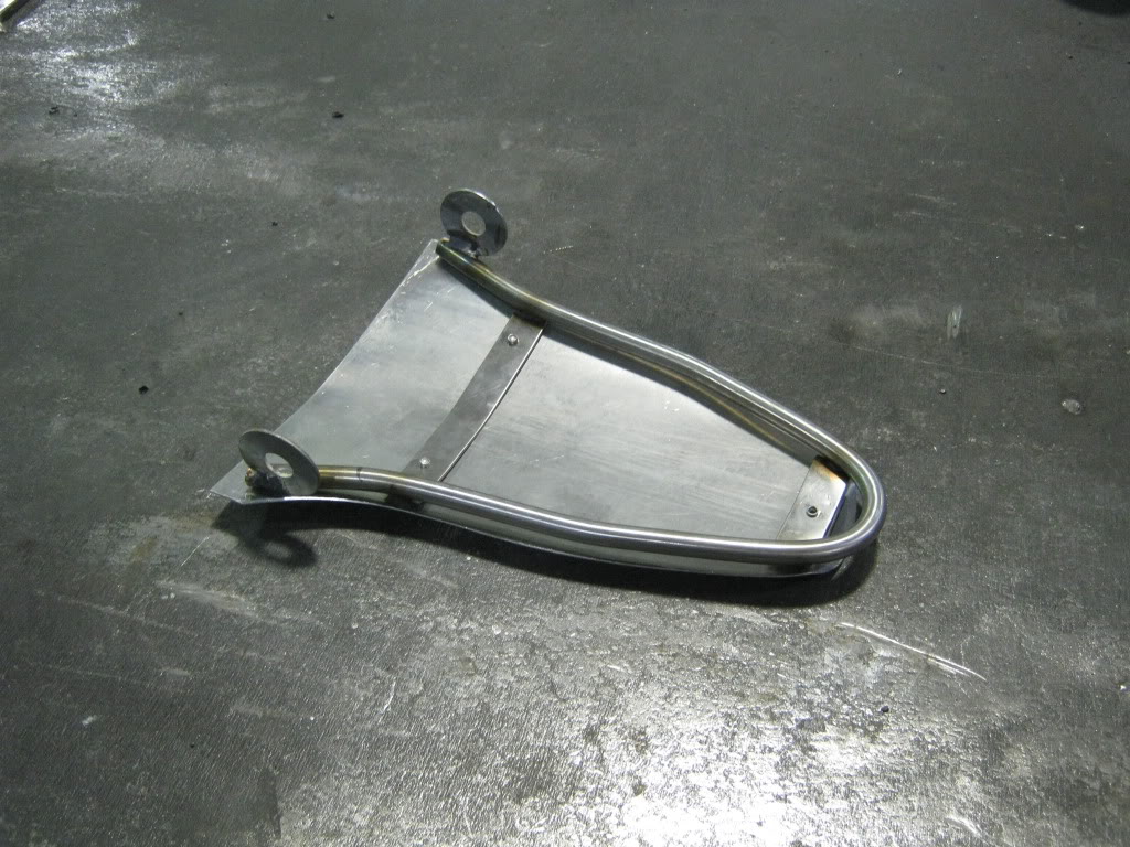

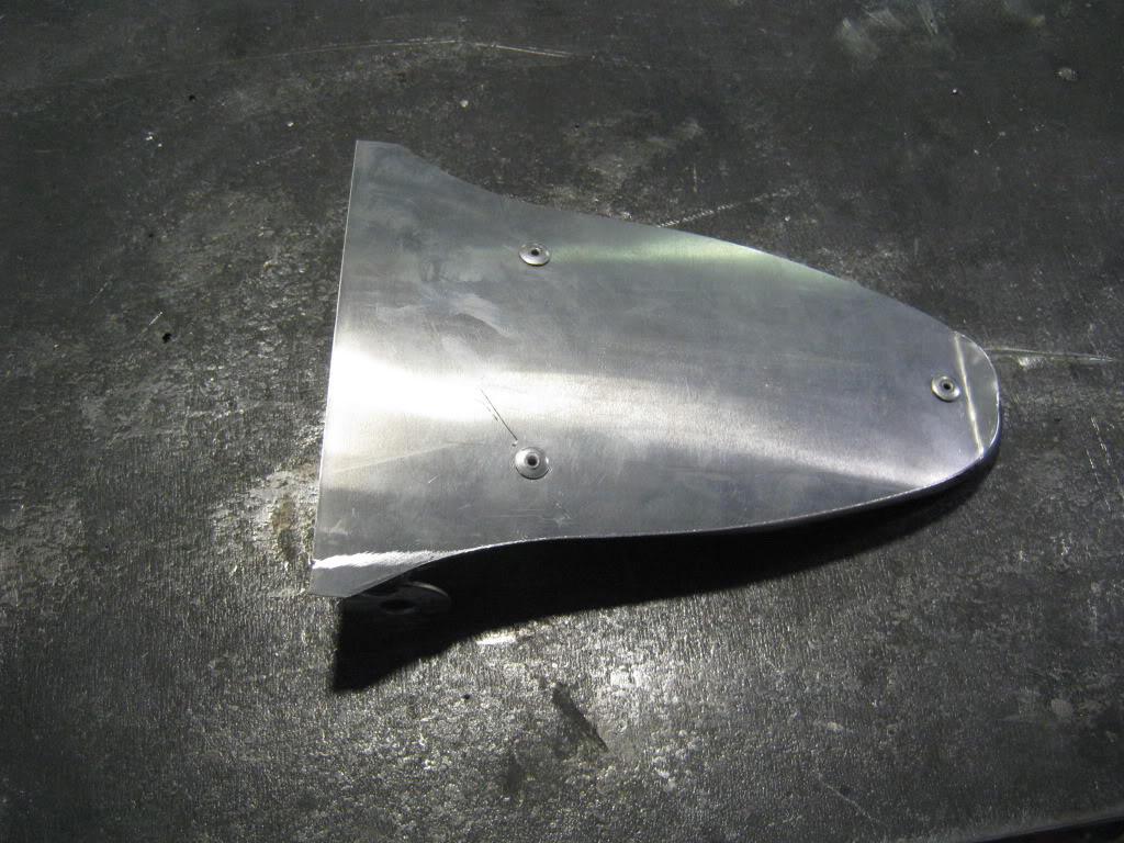

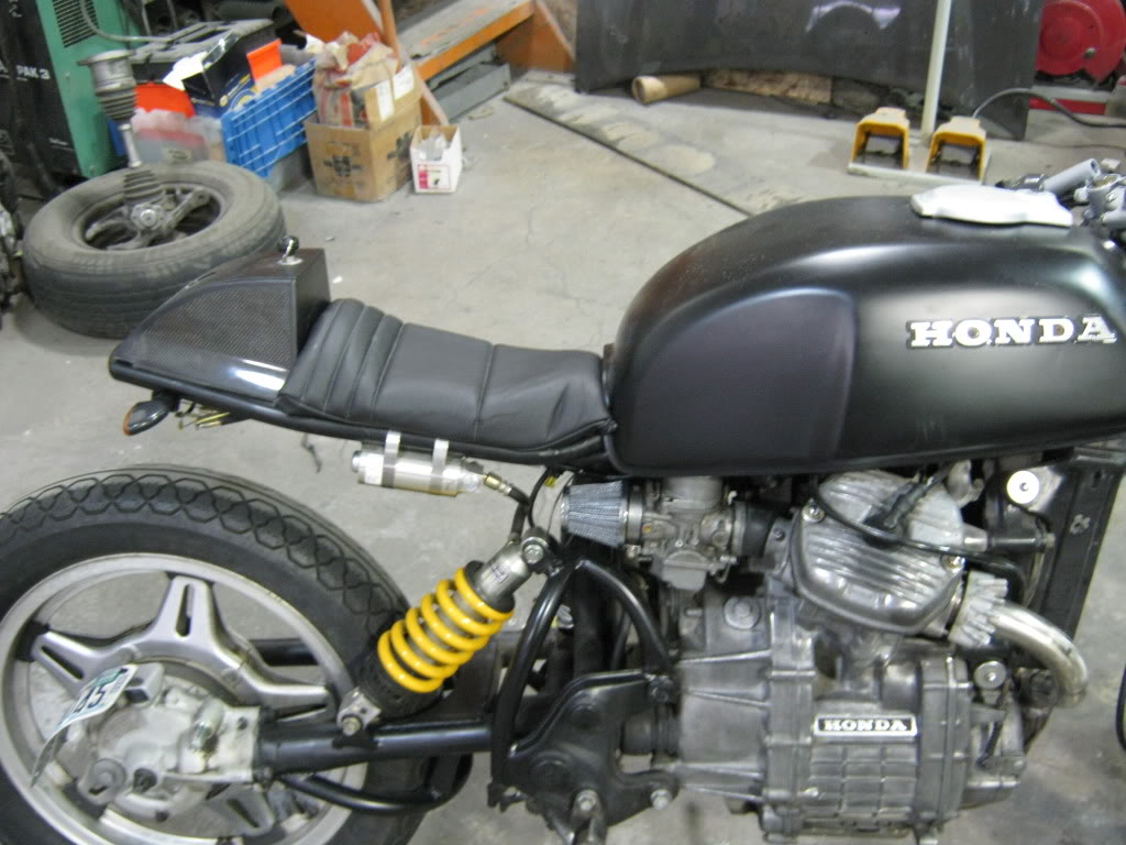

Been pretty busy with actual work so its been a little while since there have been updates. Anyways I mounted an AGM battery under the engine, it is near the exhaust outlet so I built a dual purpose strap and heat shroud. Here are some shots of that.

Well that won't hurt the center of gravity. I would be a little afraid of the heat, any carbon fiber left that you could replace the sheet metal with or maybe or maybe just throw some thin insulation in there.
