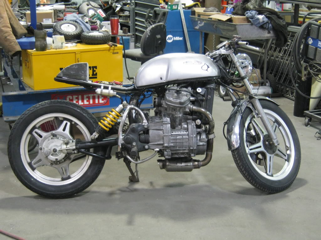

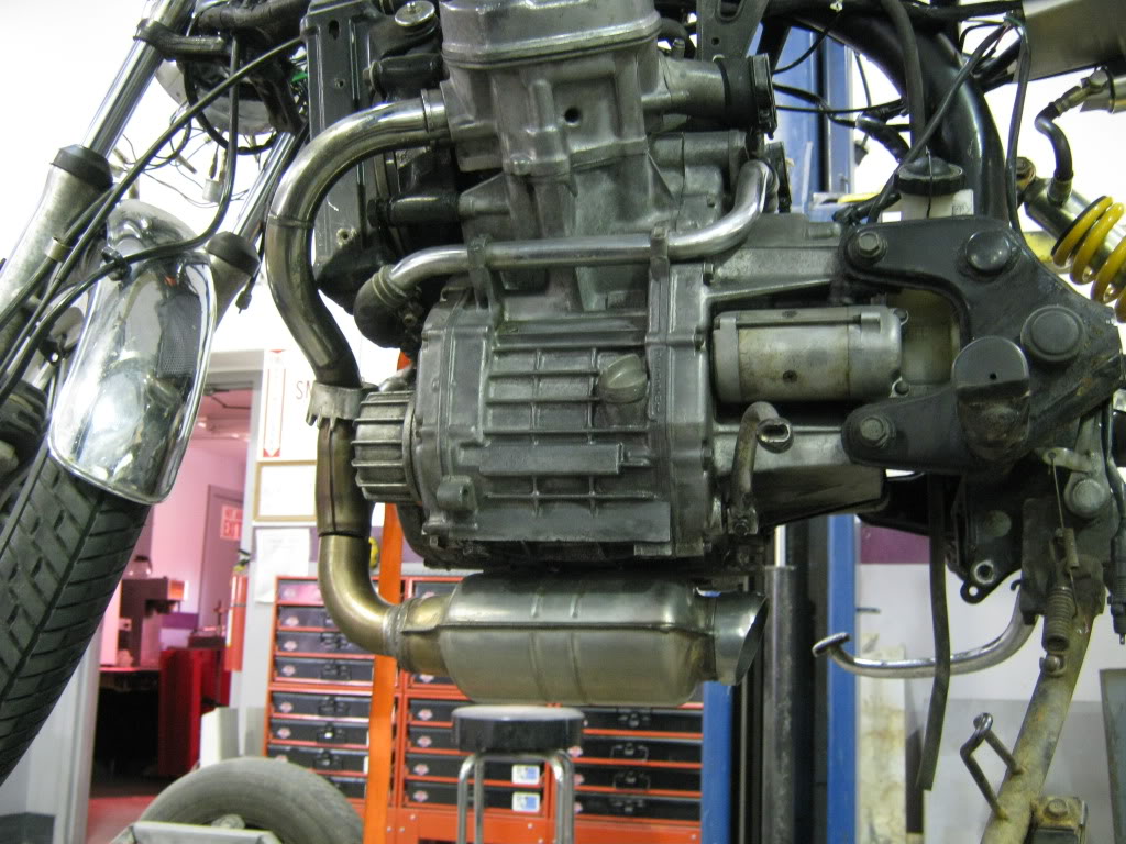

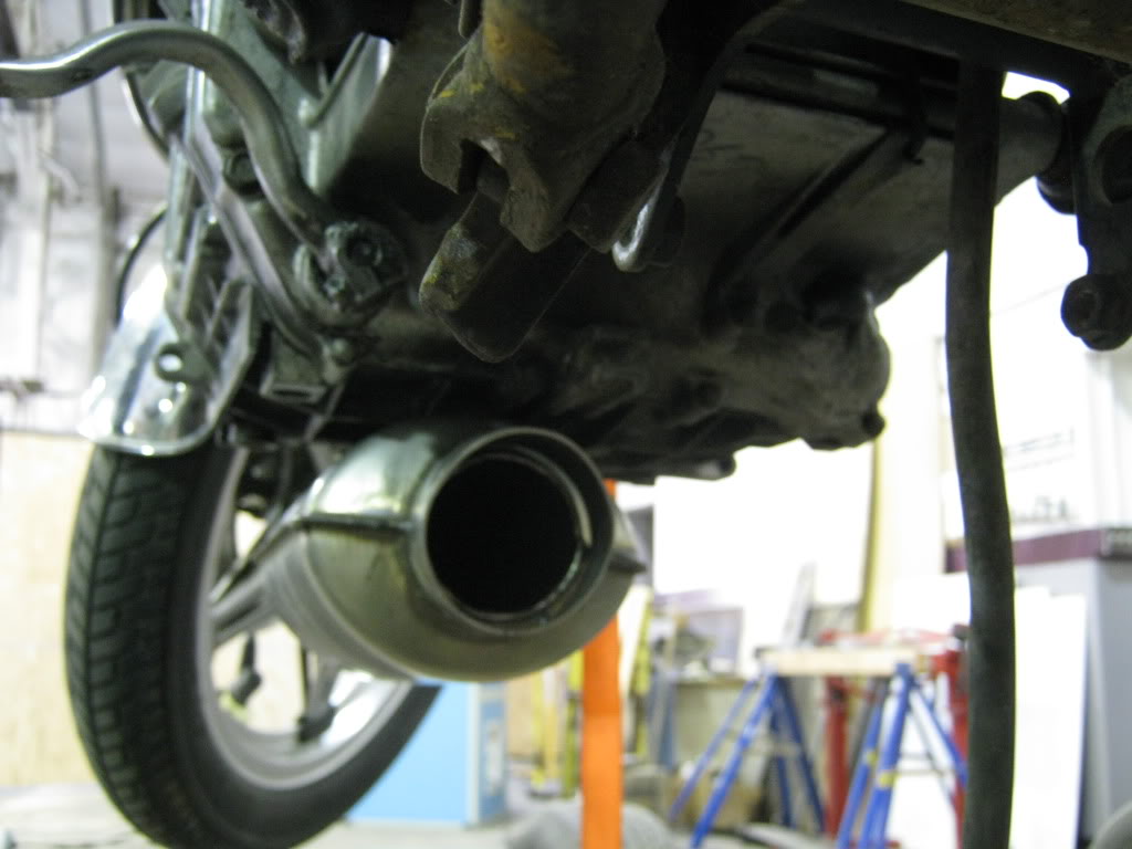

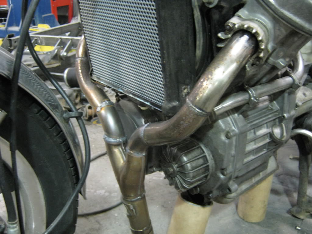

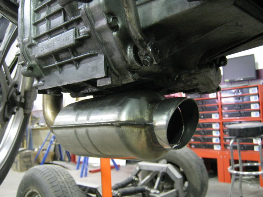

The exhaust is coming along nicely. I will just be doing a simple under engine can for now.

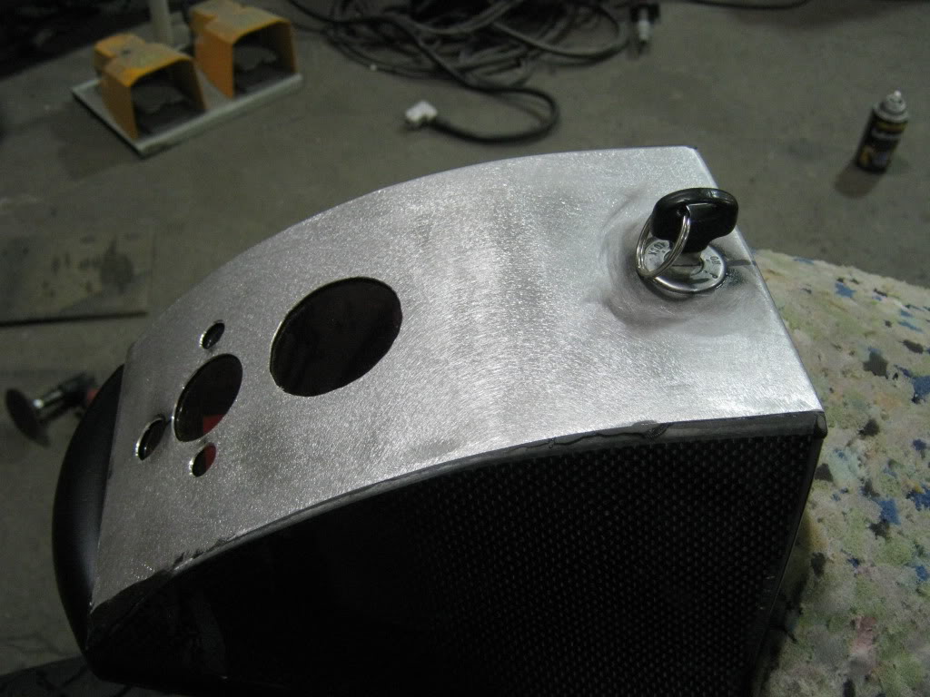

Also I have decided to put the ignition embedded in the cowl. It was very long and I couldn't find anywhere else. Plus I actually think it is cool back there, but maybe I will be the only one.
Old Apr 27, 2010 | 02:23 PM
  #92
Kind of looks like a Saab, with the ignition switch in the console.
Good idea with the exhaust, should be really light.

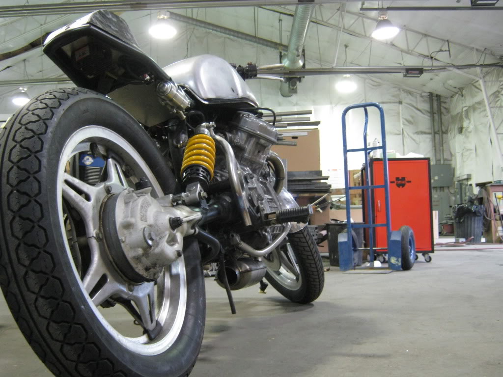

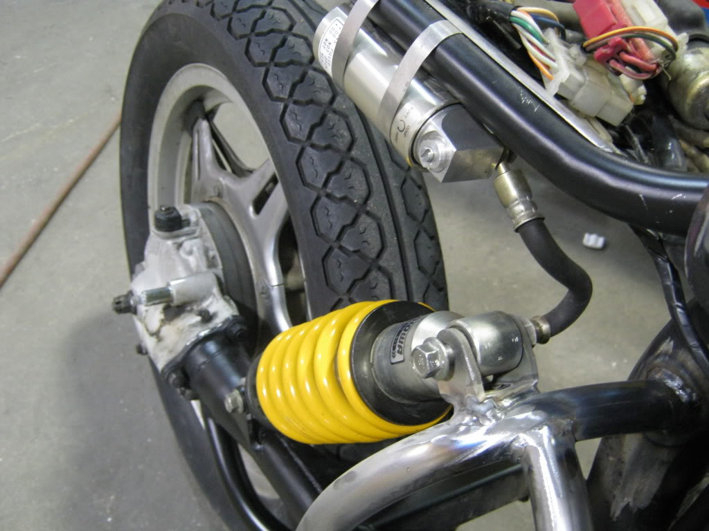

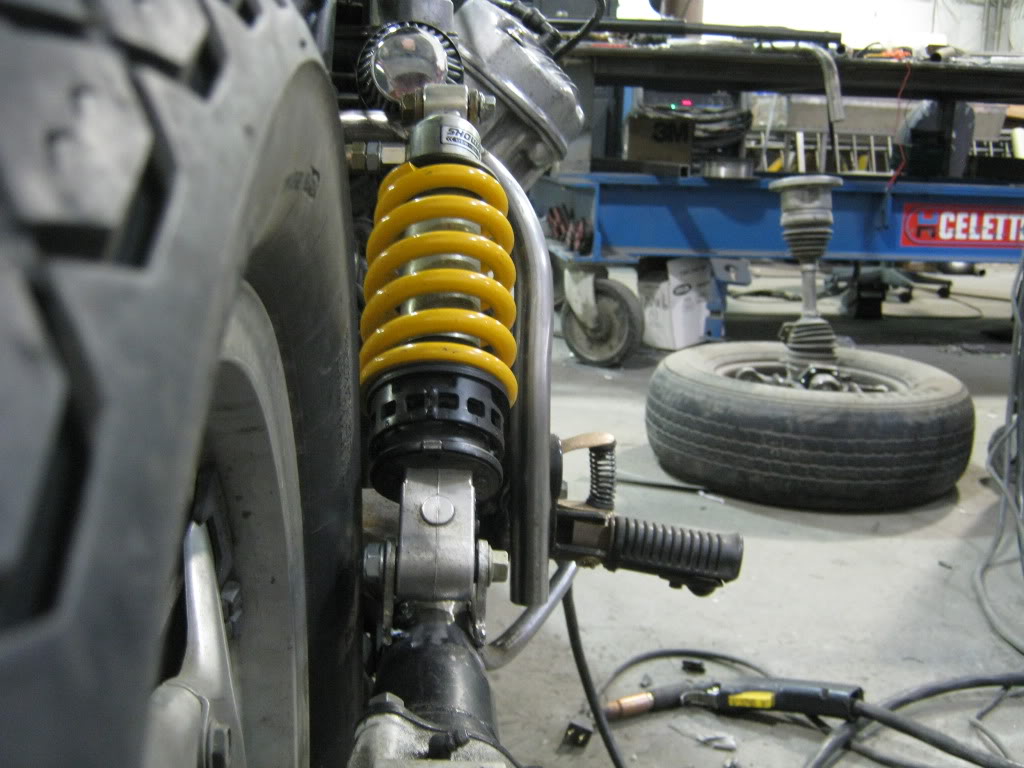

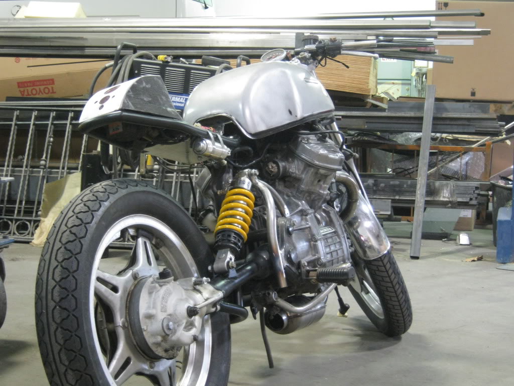

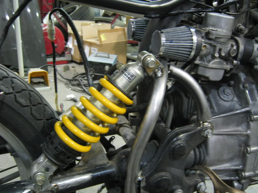

Well initial trial and error is done on the shock mounting location time to weld her up and road test.
Old Apr 28, 2010 | 06:14 PM
  #96
Little_Horse's Avatar
2nd mouse gets the cheese
Posts: 1,697
From: Beaverton, OR

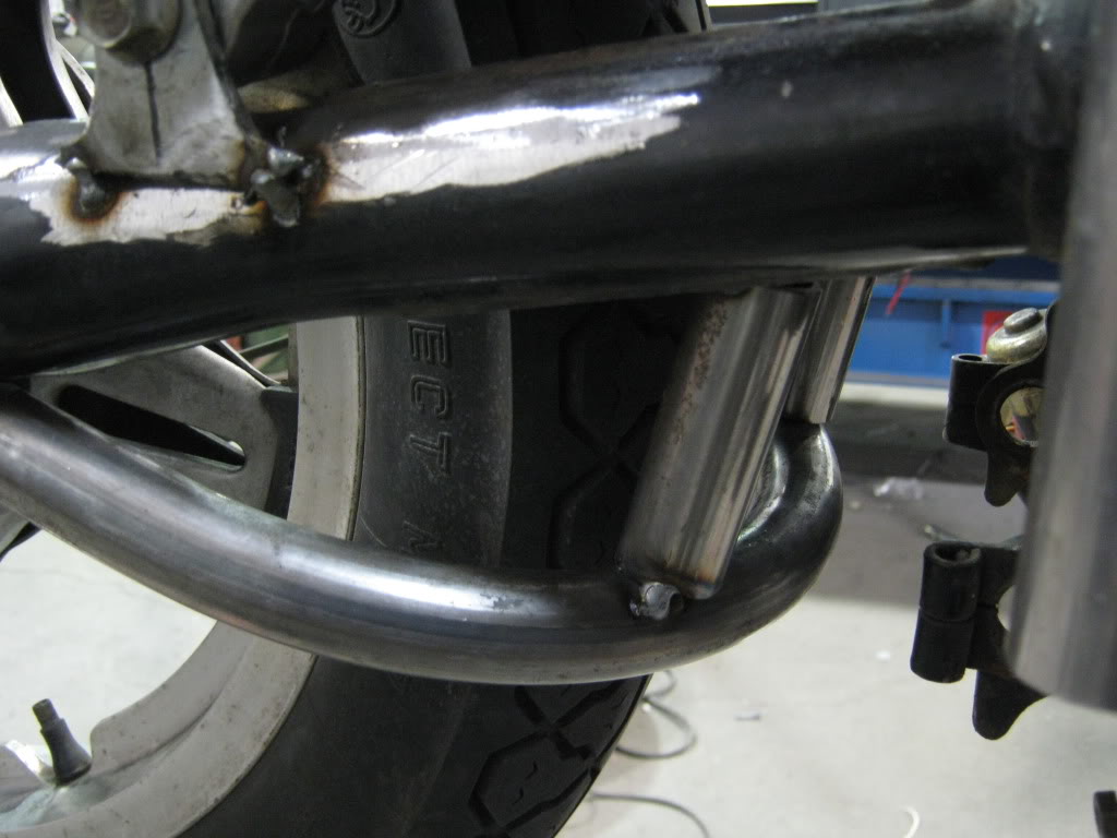

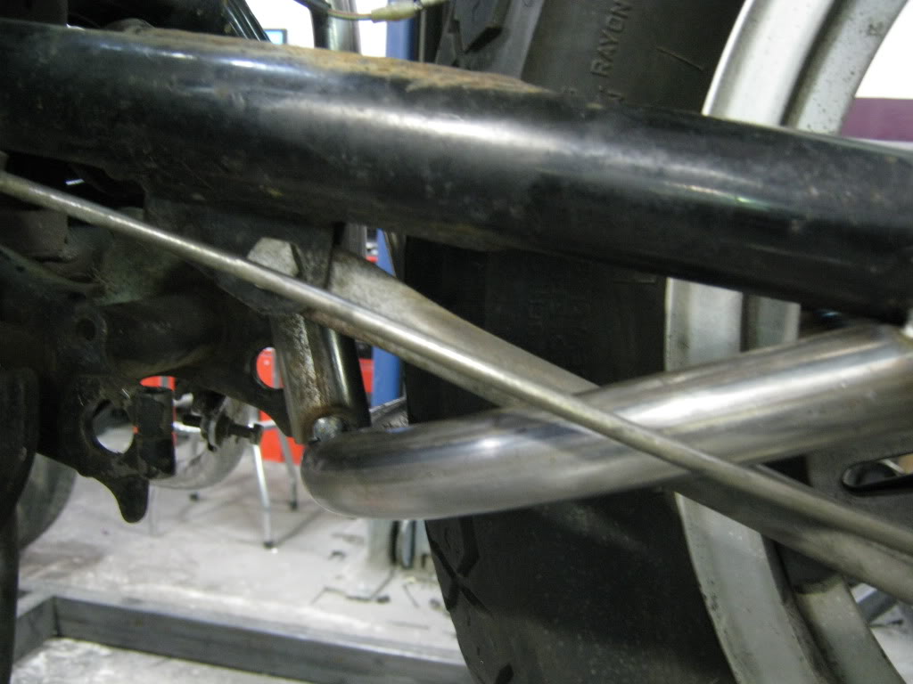

My swing arm brace is going to have to go under rather than on top of the swing arm. Not enough room up there with the shock and all.

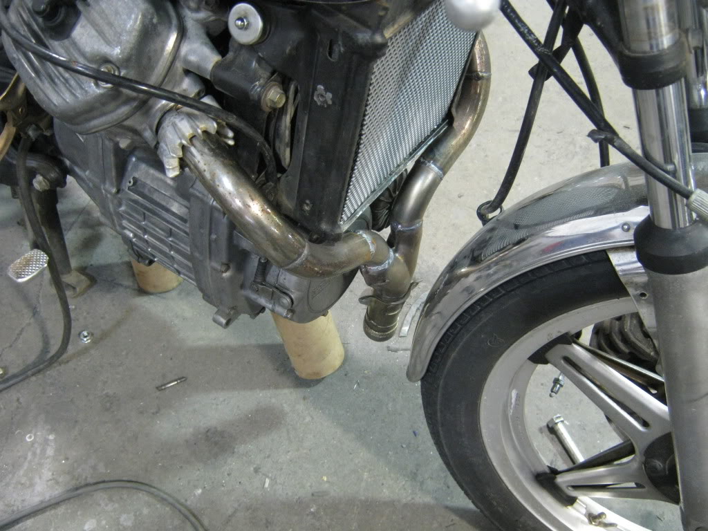

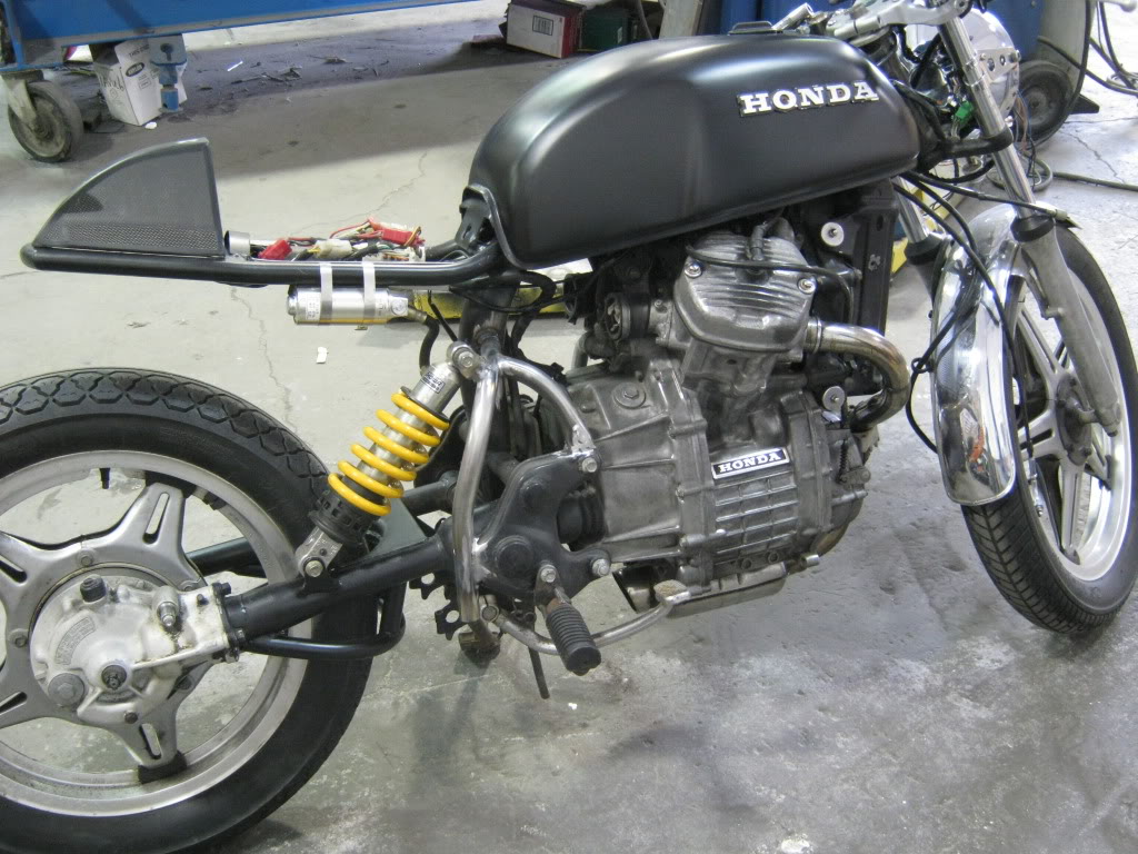

So here are some more pics of the exhaust and of the brace. Some things are just tacked in place so don't panic. I need to remove the rear wheel so I can weld up the swing arm. Then paint it. The exhaust is done other then a few dents I will blend out hopefully, I have a feeling the exhaust is love it or hate it, but it is very light and keeps the look of the bike very compact which was the goal with this one for me. After that it is on to the details left undone. Brake lines back on and new fluid. Shock fluid replaced Wiring to finish blinkers to install all little stuff that I probably won't post then first ride yehaw.

Old Apr 29, 2010 | 04:22 PM
  #98
The exhaust looks good.
But I guarantee you will need to rejet with those K&Ns. I tried a K&N in my '78 with the stock airbox, and went back to the stock element a week later, because it had a big mid range flat spot. That was with 2 into 1 exhaust that it had when I bought it.. At least the carbs are sitting right there staring at you, unlike on the VTR. Rejetting would take about 10 minutes per carb, including R & R.
Old Apr 29, 2010 | 05:29 PM
  #99
Posts: 1,697
From: Beaverton, OR
I expected to need to fiddle with jetting, hopefully not too much of a nightmare but you are right the carbs will be very easy to pull.

love where you're going with this. i will say that going through all this work it's a shame to see you stick with the stock seat. i liked what you were doing before.
also, that exhaust is very much like what i'd like to do with my cafe cx500 when i get around to it. a few questions if you don't mind.
- what can is that and what are it's measurements?
- how much ground clearance do you have with it?
- could you click a pic from the side at a distance so i can see who the under-engine can looks?
- i've never done headers before... where did you get the piping, what size is it and what is the material?
where are you going to put all your electrical and battery?
really can't wait to see this completed.
Old Apr 30, 2010 | 02:20 PM
  #101
Posts: 1,697
From: Beaverton, OR
LOL the stock seat thing was totally a joke just to point out the hilarity in how huge it is.
The can is a resonator found on alot of Audi's. I used the stock headers but changed the directions they point. I also ended up using a few elbow from another exhaust that happened to have the same material as the stock headers. Ground clearance is still good, probably seven inches to the can so plenty still. The size of the additional tubing is 1 1/2 in OD. I am going to put the batteries anywhere where they are almost invisible to the eye. I have a few options here but I will need to fiddle most likely. The electrical bits go under the seat and the R/R goes under the cowl.

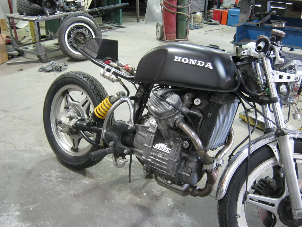

So today I did a very fast bodywork job on the tank and cowl and hit them with some flat black paint. I will let my sister get her newbie niggles out on cheap paint. Then after summer she can figure out what color she wants and I will have my painter do it right. No grumbling people it goes stealth for now. I can make a statement with it later.

now with a little paint

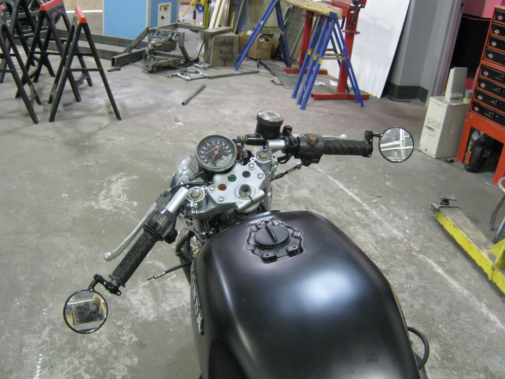

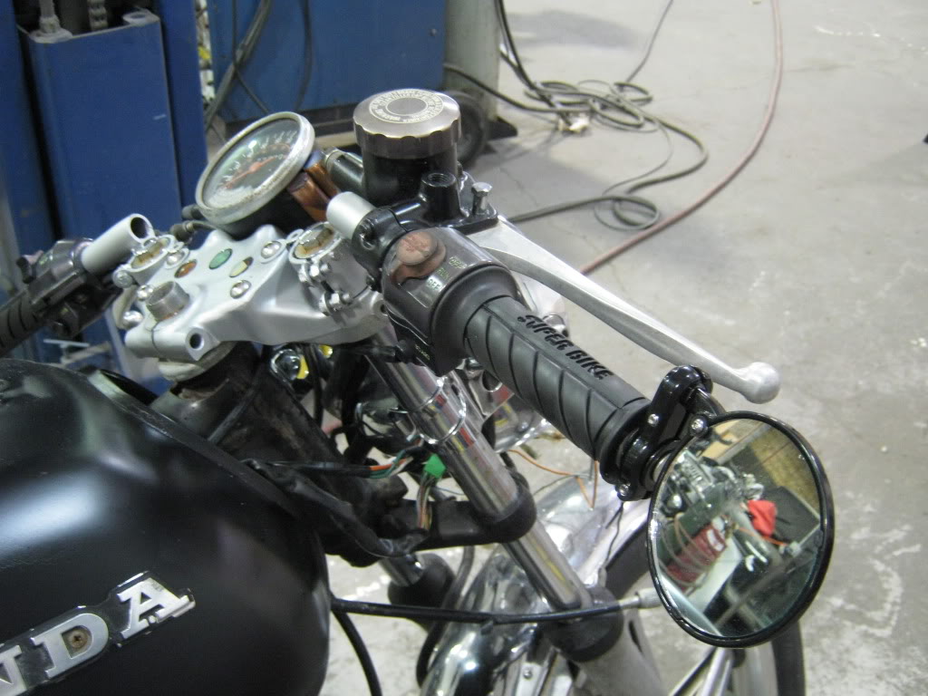

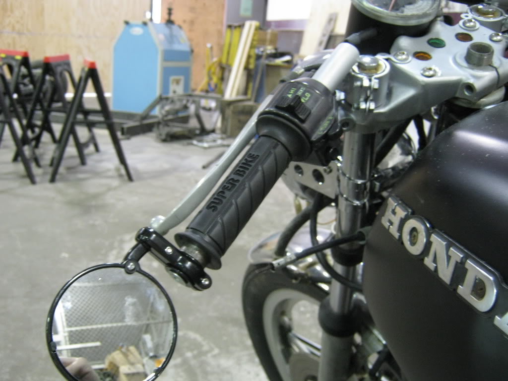

Alright I finished my controls, check that off of the list woot!

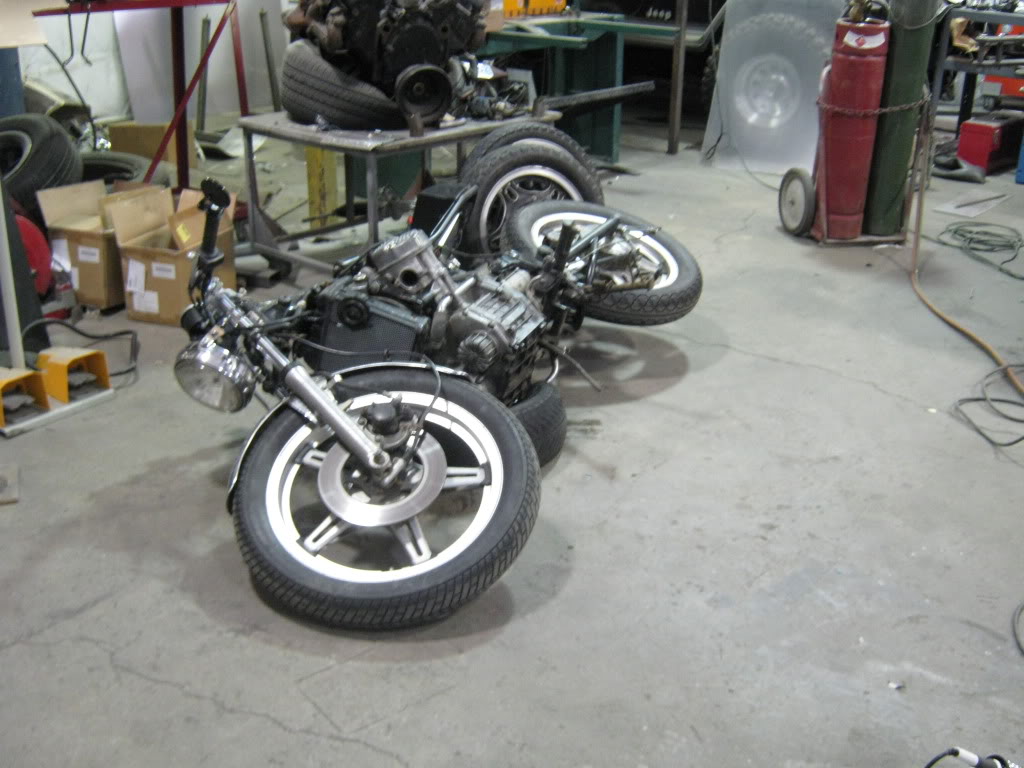

Old May 6, 2010 | 02:04 PM
  #117
At first I thought it fell and was but then I saw the tire and realized you were teasing us.
Old May 6, 2010 | 03:52 PM
  #118
Posts: 1,697
From: Beaverton, OR
yes teasing... but there was a good reason for it to be on its side that I am not happy about

Long story, ever have something go wrong then in the process of trying to fix it it just gets worse. Yeah I was having one of those. I am replacing my exhaust studs since 3 of the 4 sheered on removal so I needed to remove the last stud that was still in the head, so I heated the head and had sprayed some lube in there, and I start removing the stud only to have it sheer right on the head. Ok no big deal I can use an easy out. So I drill it out put the easy out in it, and snap the easy out breaks buried deep in the head. You can't drill it because it is harder then the bit. So anyways I ended up having to grind the edge of the mount until I could get the old stud and easy out out of the head so I laid the bike on its side on a tire and thats that. Then I welded new material on the head, now I need to drill a new hole and tap it to be done. So like 3 steps back.
Oh and the radiator has a hole in it too
