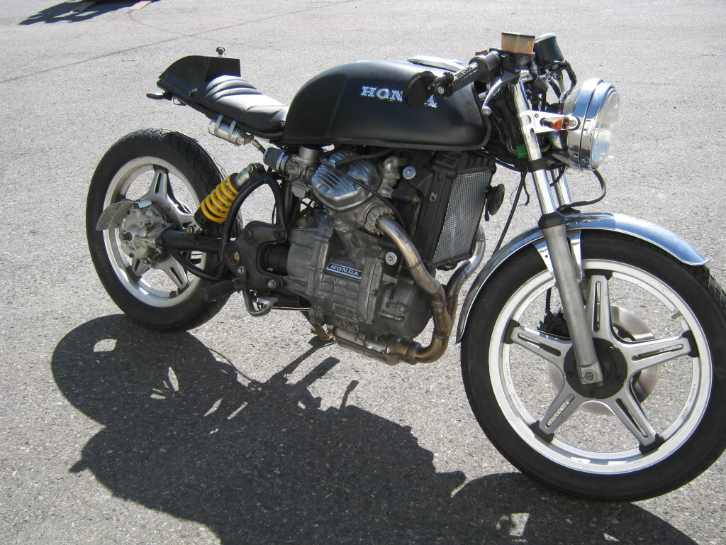

Been riding her here and there and she works awesome! The suspension feels good, tip in is well very fast. Had her up to 80 mph no shakes or shimmies. Seat is comfortable and so is the reach to the bars. Rear shock seems to be working great. I am excited, even the jetting seems pretty close.

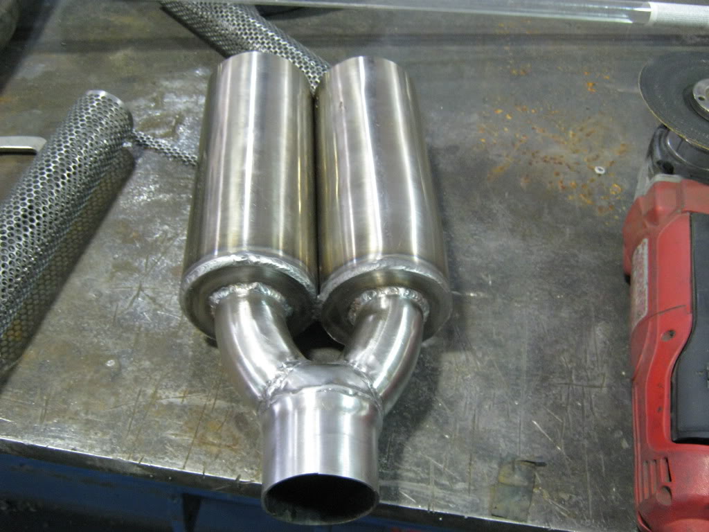

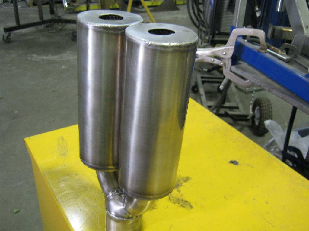

I haven't put the silencer on yet but here are some shots. Double tube glass packs.

I am pulling my hair out now. The exhaust is too loud still even with the extra packing. After some discussion with Springbubba I am beginning to think the length of the exhaust is an issue. I may have to make it more standard exit. A shame since I really like the way the under engine looks.
Old Jul 16, 2010 | 09:32 AM
  #204
Swagger's Avatar
Just peeking....
Posts: 3
From: Oregon
Swagger is on a distinguished road
Looking at your setup, I'd say it's a volume issue (no pun intended). There's just not enough internal volume to do the sound damping you need but still allow decent flow. If you resort to extra baffling or packing them you cut flow. Improve flow and it's gonna get even louder.
I think you can still make an under engine system work but it'd going to take more muffler than you have. The way the bike is currently set up, you have lots of room under there for a pretty large muffler. Hell, with your abilities, it'd be easy to fabricate one to suit your needs exactly. Get crazy and weld up the inner baffles and your perforated tube with three or four individual chambers and a little stubby exit right by the back tire. Rivet an aluminum skin around the structure and some stainless wool packing. You'll be able to support far more flow than the engine is capable of and it'll be quite livable as far as noise levels are concerned.
If you're careful the unit doesn't have to be too awfully heavy either.
Add a 3-bolt flange at the headpipe and a couple straps to support if from the bottom of the engine/frame and you're dialed! Hell, make it look like a belly pan!
Old Jul 16, 2010 | 09:52 AM
