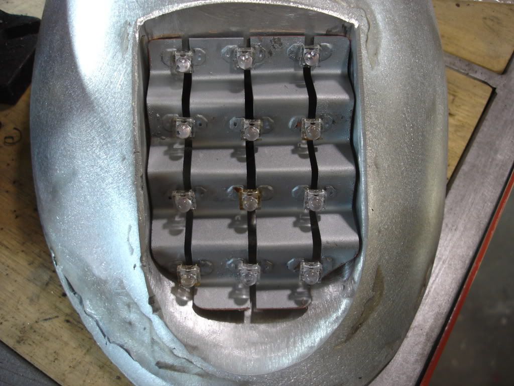

Project cowl and tailight
Here is a shot of the tail light cut out in the rear cowl. Still a little rough but with a little mud work and a plexiglass cover for the LED panel it should look awesome. I have decided to run a clear lens with the LED panel the same color as the 3in stripe I will be running down the tank and cowl. Now all I need to decide is what color the stripe should be silver or black. Remember as of right now I am planning on a base color of pearl white with semi-gloss black frame.

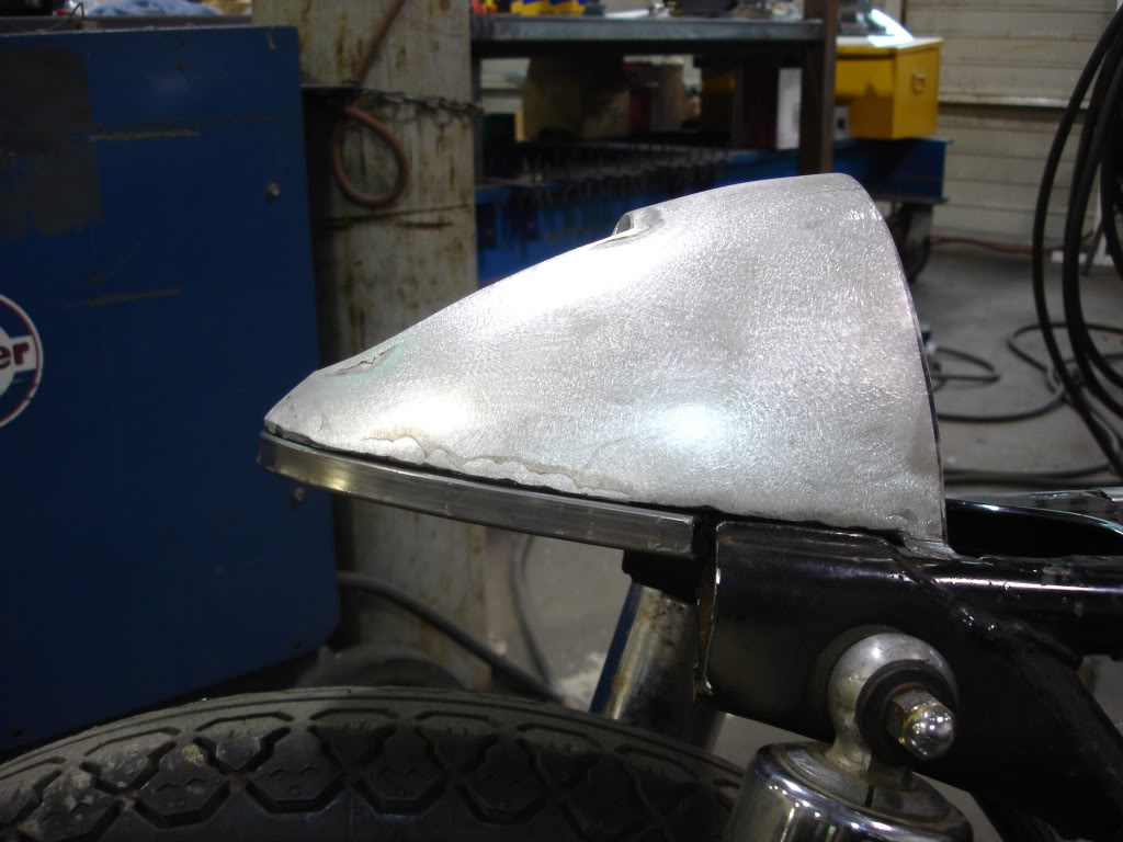

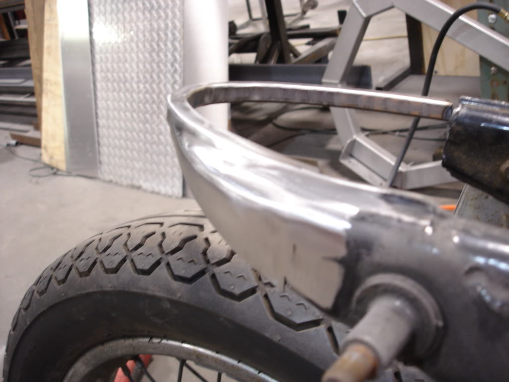

Started the frame to cowl transition.
I will box it all in and make it look finished.

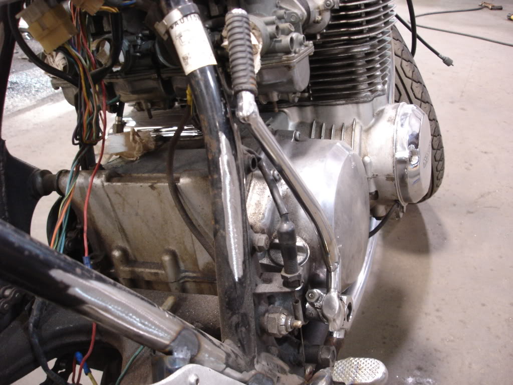

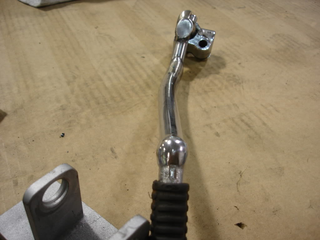

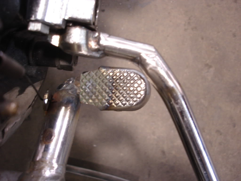

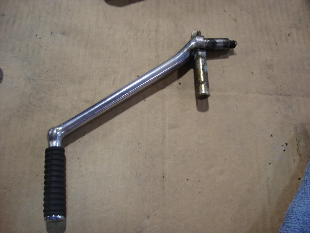

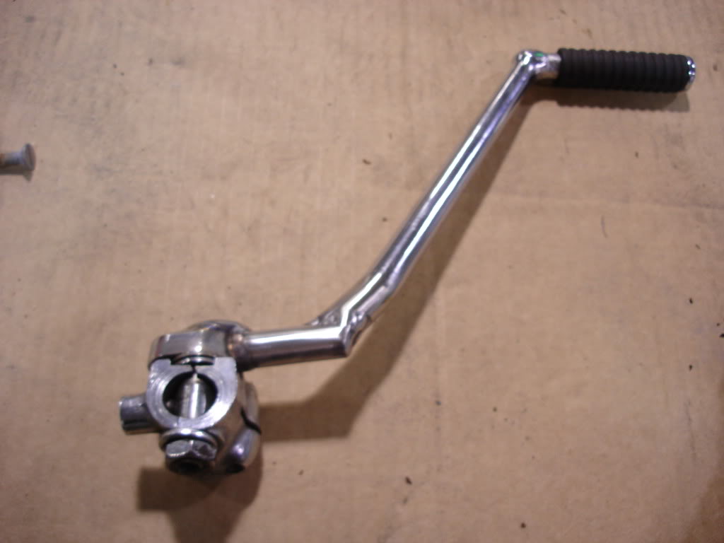

Back to the kicker
So I ended up revisiting the kick start clearancing issues I was having. So the fix I ended up going with was a mix I moved the brake pedal pad in closer to the bike about a half in. I raked the brake pedal down more aggressively by making a stop for the pedal that only allows it to pop up to the height I wanted. I accomplished this by make a adjustable screw stop that you won't see unless you look for it. I then cut and welded a relief section into the kick start to allow it to be further out when in the start position. This however created a clearance issue with the engine cover. So I rotated the kicker on the shaft back a few teeth. Problem solved there except now the kicker is pushing into my shin when on the bike. So I clamped the kicker down to my work bench and slammed it 5 times with a 20lb sledge until it curved enough to just about touch the frame and viola no more shin hit and I can start the bike without folding anything up. The end. Here's some visual aids.

Blocking in the rear frame

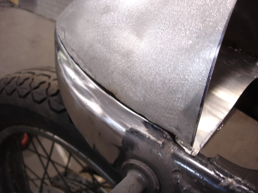

It is what the title says just building in sheet metal to blend the transition between the frame and cowl. Sorry about the blurry pics, stupid old camera.

Nice going on the brake lever and kick start! I'm glad to see that you figured out a solution to the clearance issues. The cowl end of the bike is really coming together. I am really enjoying viewing each day's progress. Get a better camera.

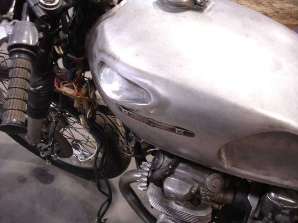

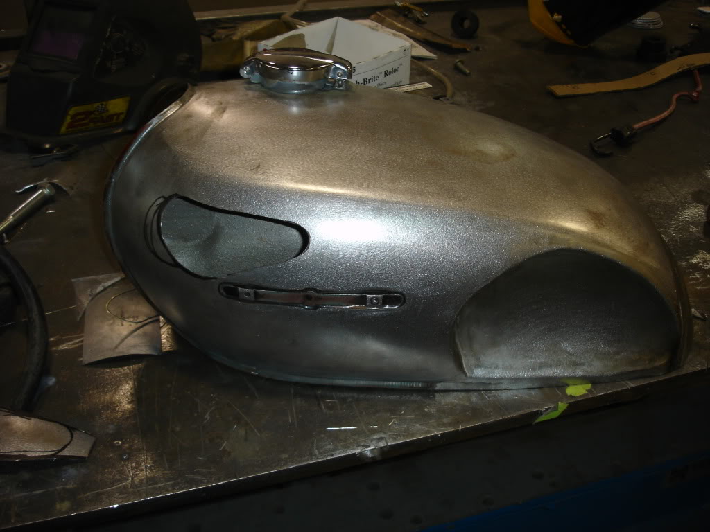

More on the tank

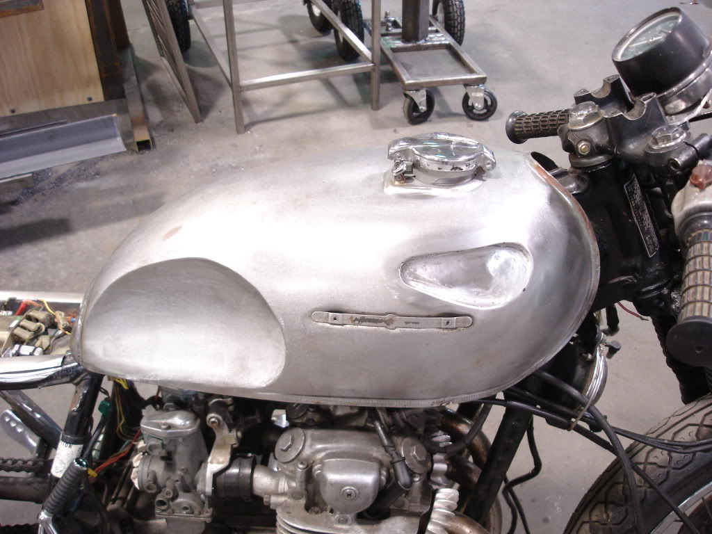

So I started my clip on cut outs, I have one side done and is now waiting for finish work, bondo sand and paint. I still need to do the other side then I will have it ready for paint soon.
Here I have cut out the tank and now I need to hammer out a replacement negative.
This is with it done.

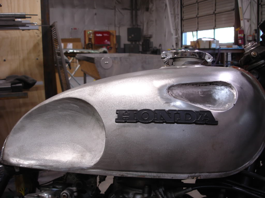

Tank done!

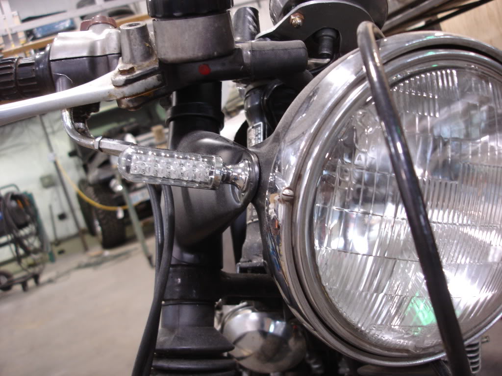

So the metal fab is done on the tank, I finished the other clip on cut out. My LED blinkers came in so I mounted the front ones to see if they look right with the bike. I think they do. I have been pretty busy the last few days, that's why there hasn't been as many pics. I should have some more later. Enjoy.
