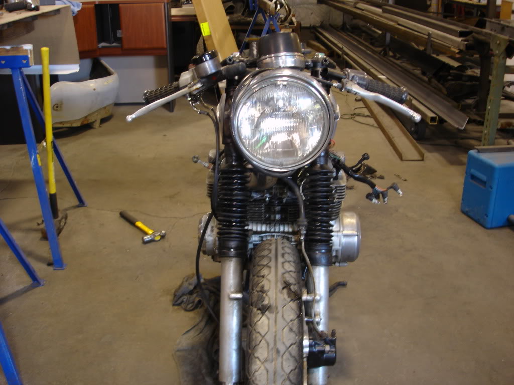

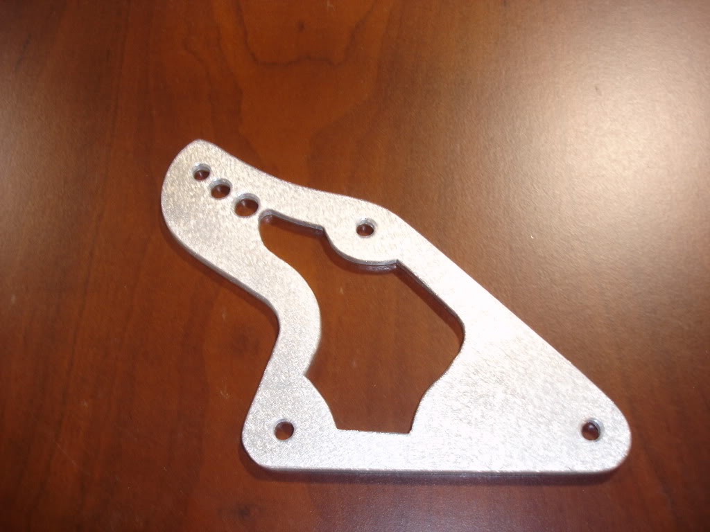

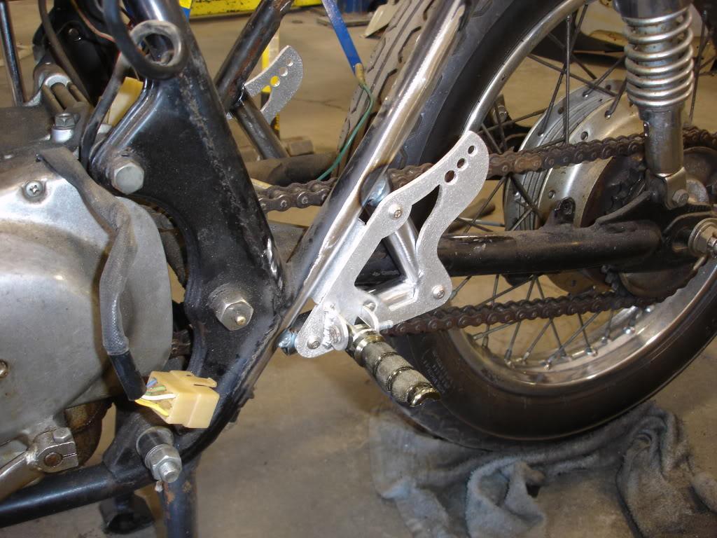

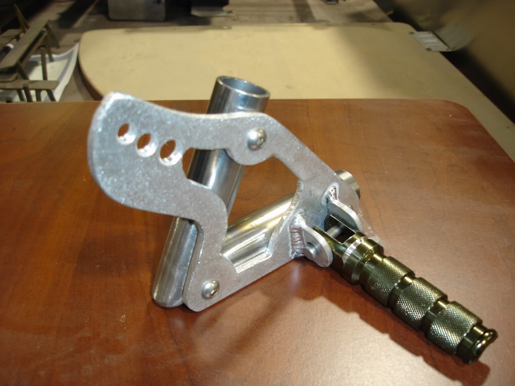

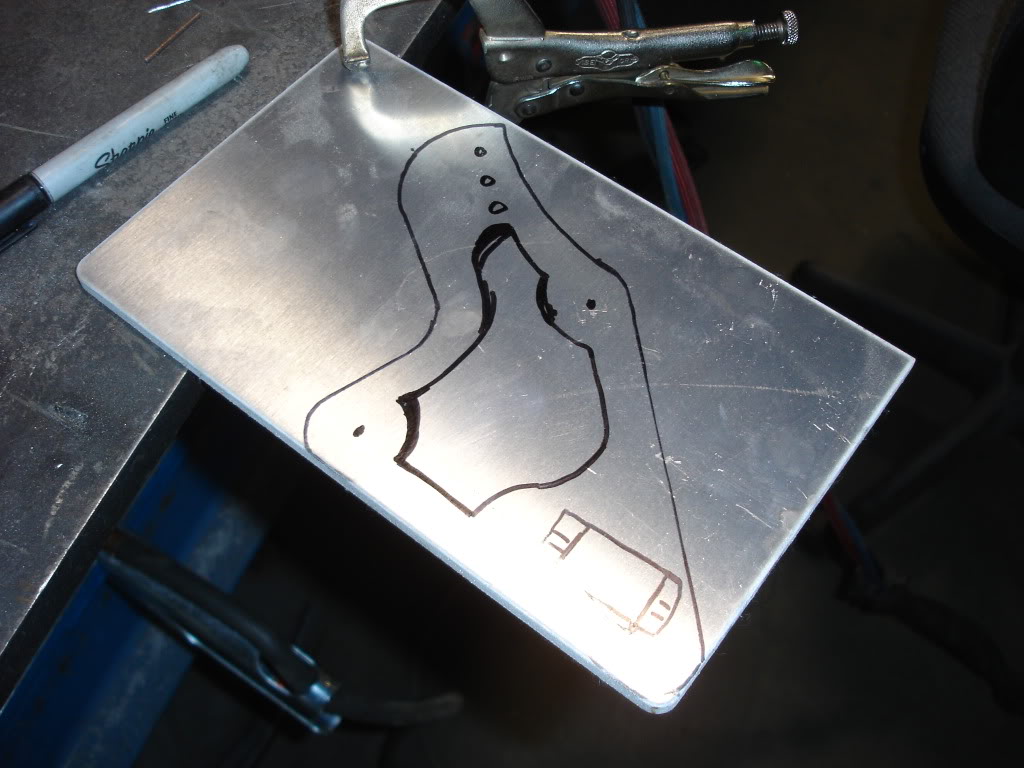

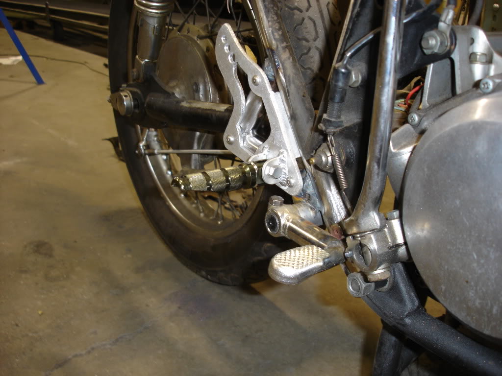

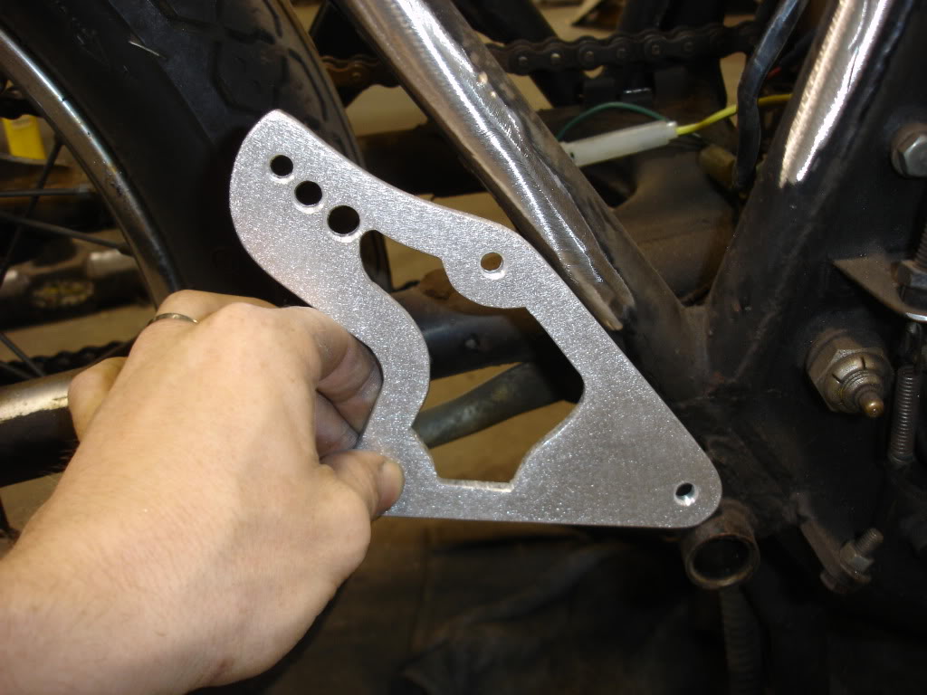

Rearsets started
Started my rearsets today. Cut from 1/4" 4042 Aluminum plate sanded and filed into shape. I wish I had a mill. Also fixed up the brake arm and pivot.

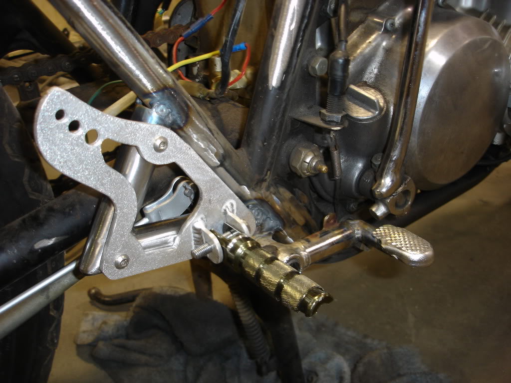

Looks great. One question though: the tab for the footpeg, is that large hole causing a problem? What kind of finish will you go for with the rearset, or will you keep it as is?
It just needs a bigger bolt which I was able to find larger one later. So I built the brake pedal and mounted everything up, now I have a clearance problem with the kick start that the only cure for is going to be a quick release brake pedal. I can't figure an easier way without making a totally different kick start arm. Oh and I will probably polish the rearset all shiny like.

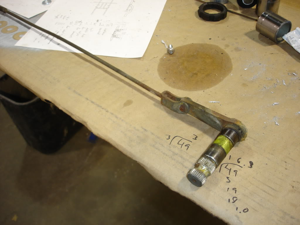

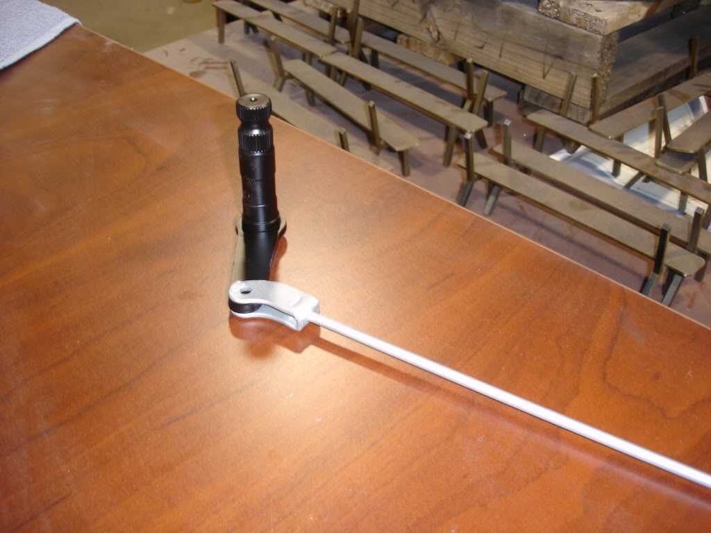

Thanks surfer. So I finished the other side, now I need to make a shift linkage assembly from scratch. Woo hoo, then on to a tank seat and cowl. Also I will be fabing up the inside assembly to hold all the electrical bits under the seat.

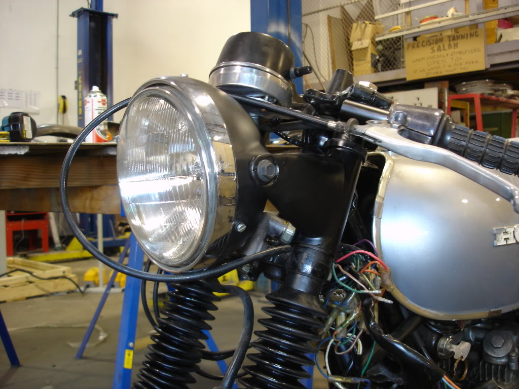

headlight is mounted, but the gauge looks funny so I will need to make a new bracket that holds it lower. Ignore the long clutch cable it won't stay.

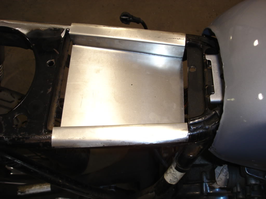

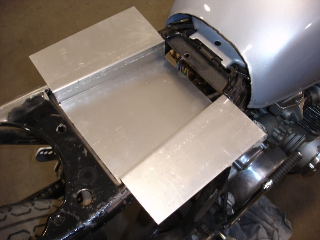

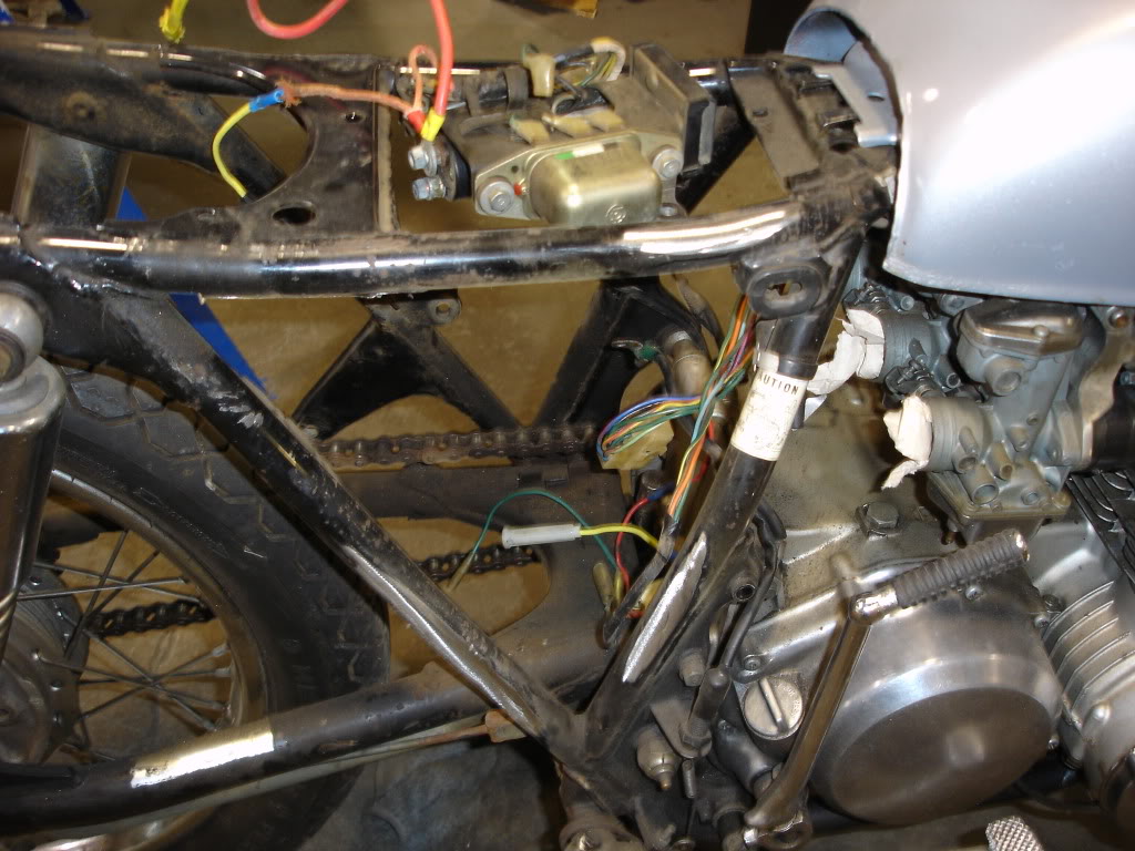

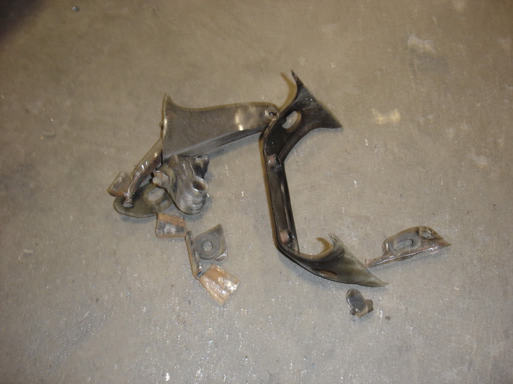

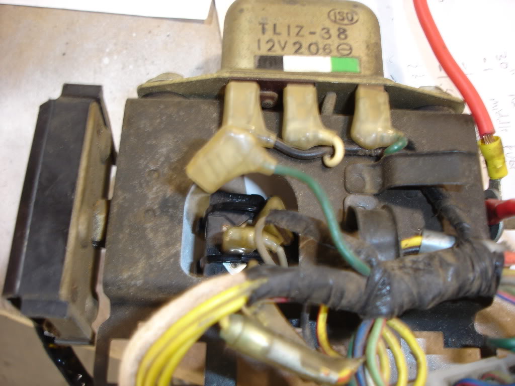

here we go again, so I took this mess of electrical...

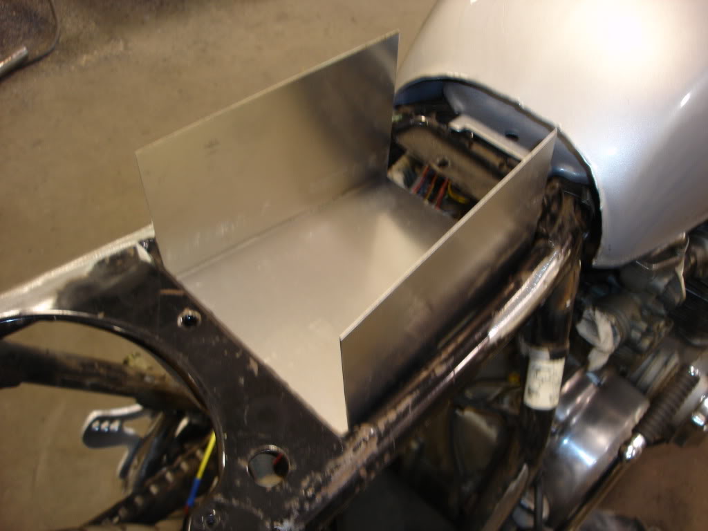

tore it all off of the bracket it was on until it was individual components then I made a tray...

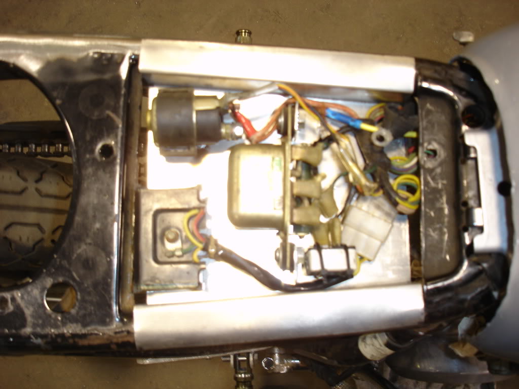

made some mounts attached them to the aluminum basin and finished like this.
then the seat pan will cover it all up. What do you think?

I'd say you sorted that electrical nicely!
Old Aug 28, 2009 | 11:20 AM
  #47
Little_Horse's Avatar
2nd mouse gets the cheese
Posts: 1,697
From: Beaverton, OR
thanks I wanted to leave a little room for things like accessory relays among other things. Next on the electrical checklist is finding space for a battery.

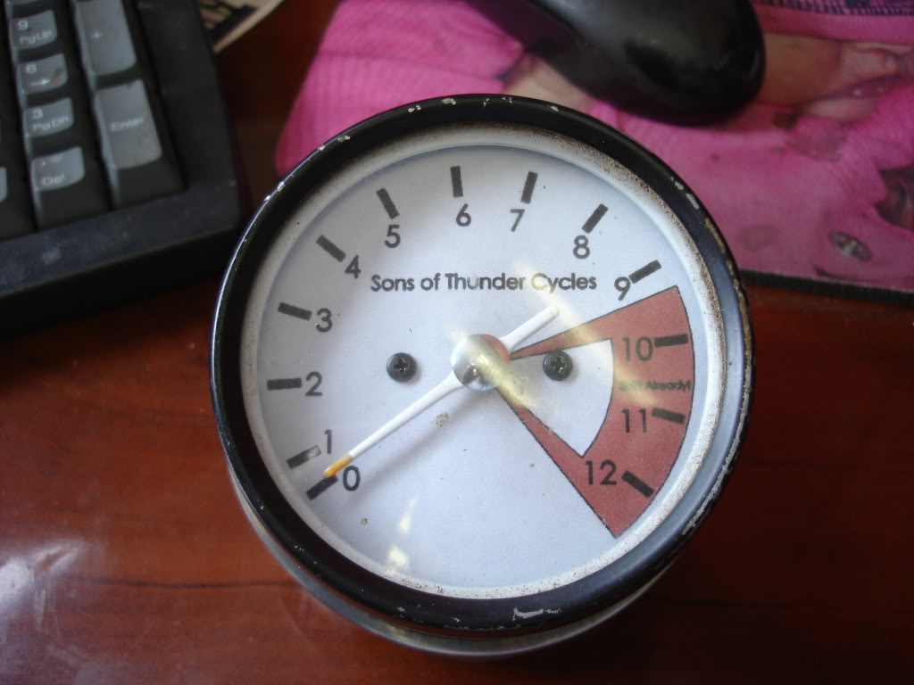

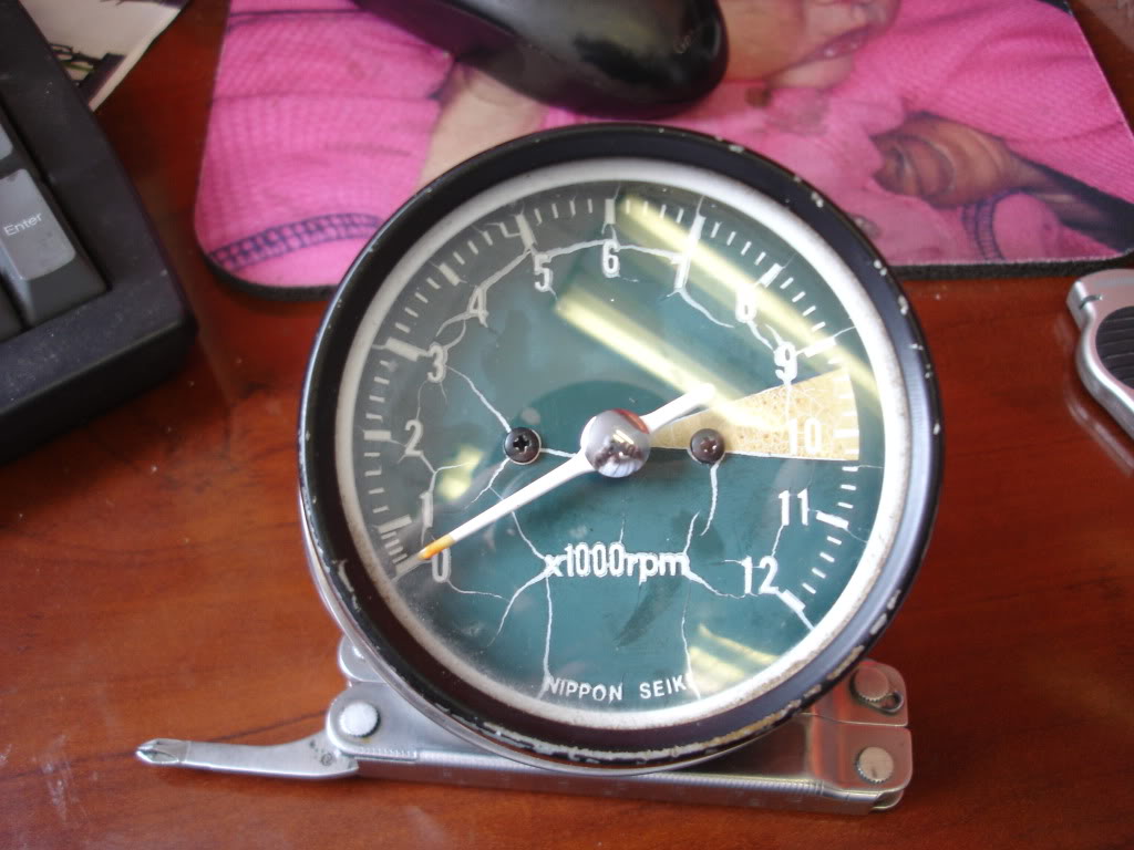

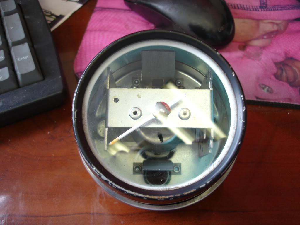

Need advice.
Alright so opinions would be nice on this, I could go either way.
Here is the gauge now.
I can print a new face on sticker paper so I have two options, on white sticker or on clear. This is the gauge without a face so I would make a plexi face and put the clear sticker with numbers on it. So imagine this photo with numbers and that would be what you would get.
Or same thing but with a white backround like this
Please help me decide thanks.

I like the white...nice work!

Or... (And I'm doing this mainly to confuse you... ) You could print a black dial on the white sticker and leave numbers/lines unprinted and white...
I thought about that too. I will be able to fit about 6 versions on one printable so I will print multiple versions and see which one I like the best.
