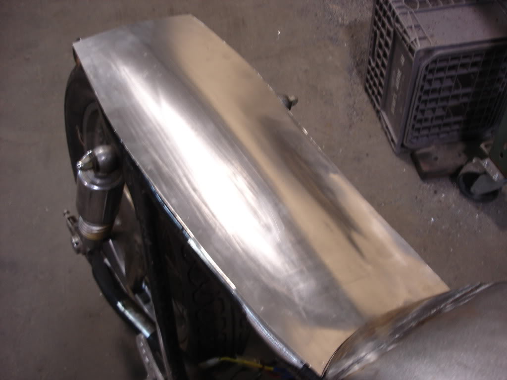

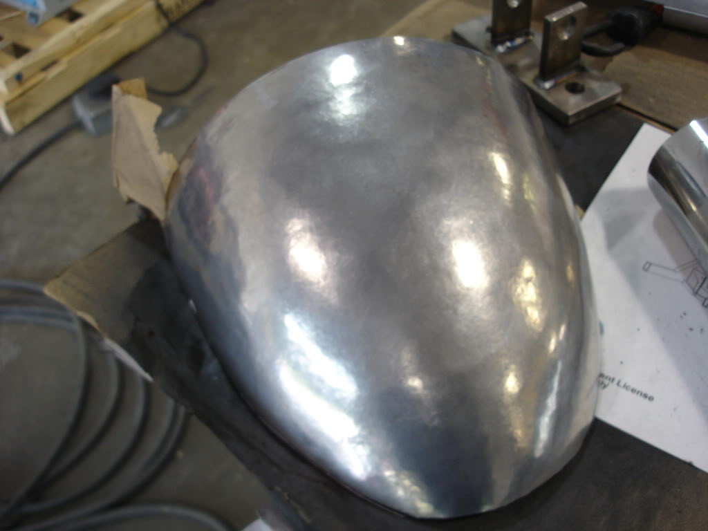

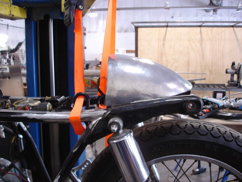

So I started on my rear cowl, planished hammered out to this shape I will smooth it some with the english wheel.

that cowl is sweet bro, you gots talent thats fo sho!

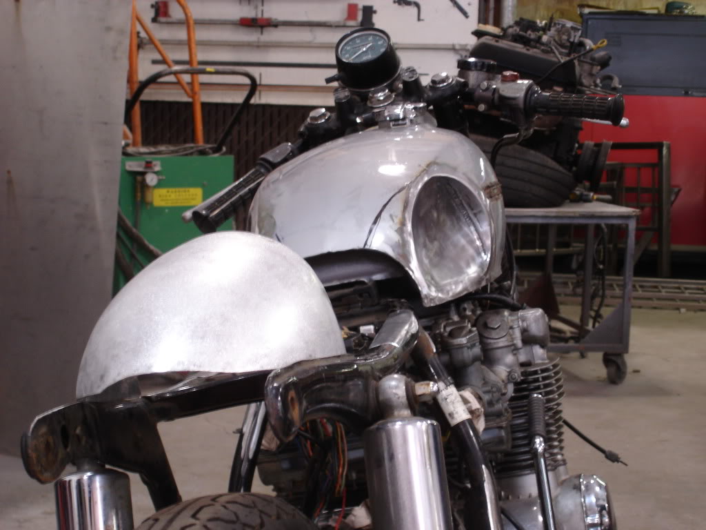

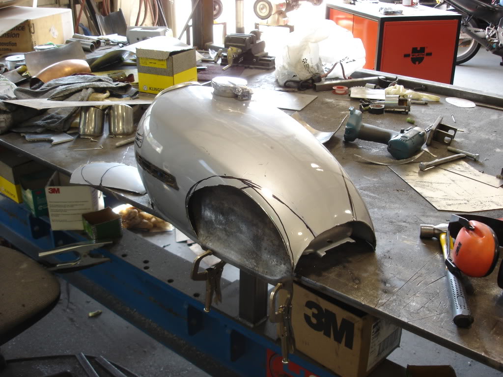

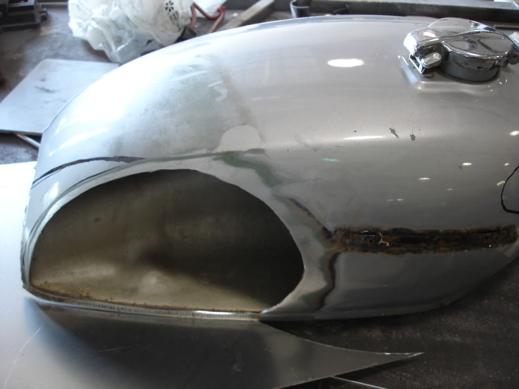

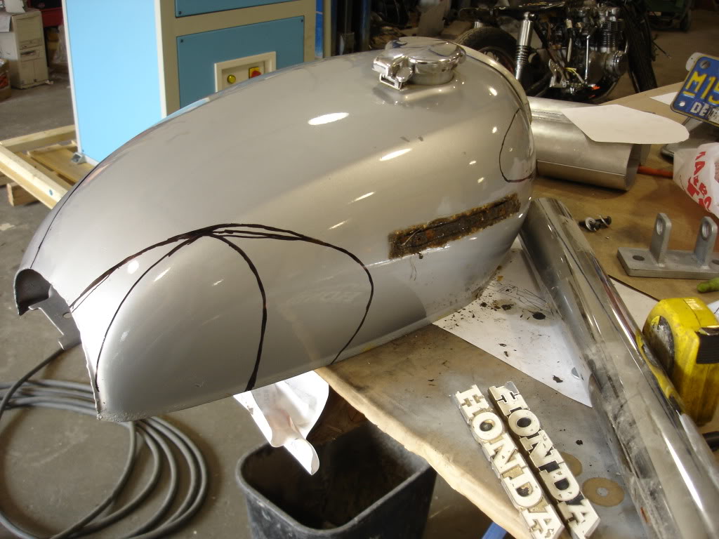

Well I decided to modify the stock tank for now. I may still build an aluminum tank later, but for now I will just modify the stocker. I can always sell it later anyways. So here is a few shot of the process. This will take a little while but should be pretty cool when done.
then I cut that section out
then hammered a piece of steel to fit in there like this.

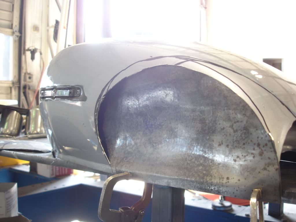

Finished the knee cut outs, next will be clip on reliefs in the tank.

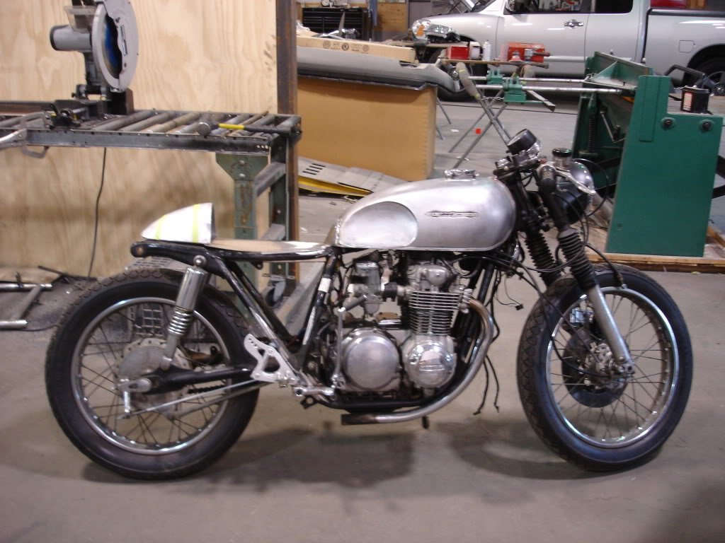

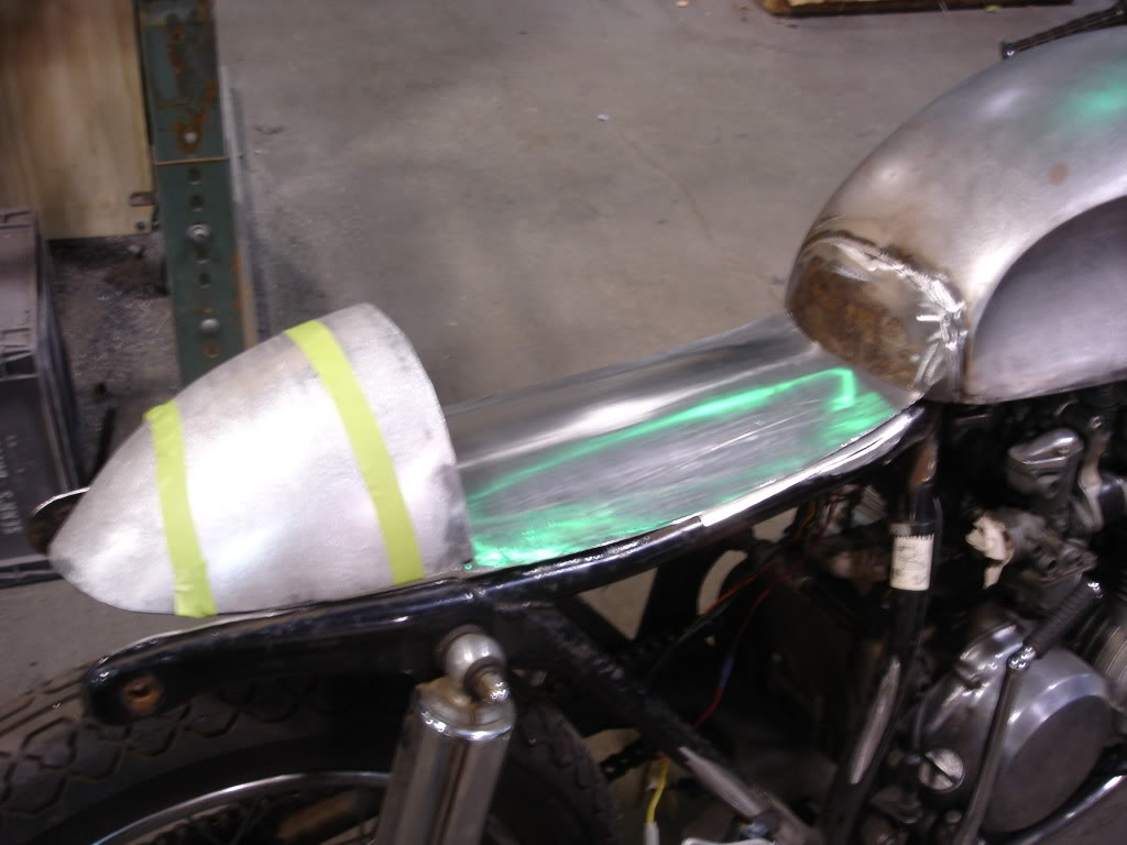

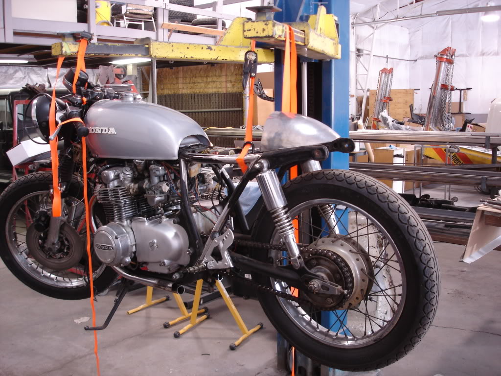

So I started the seat pan, I still need to attach it to the bike, the I will make a contoured foam seat and I may possibly make the cover as well although I may farm that out so it will look better.

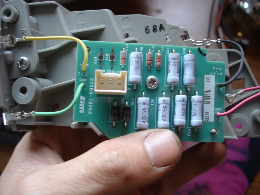

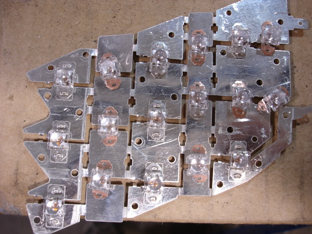

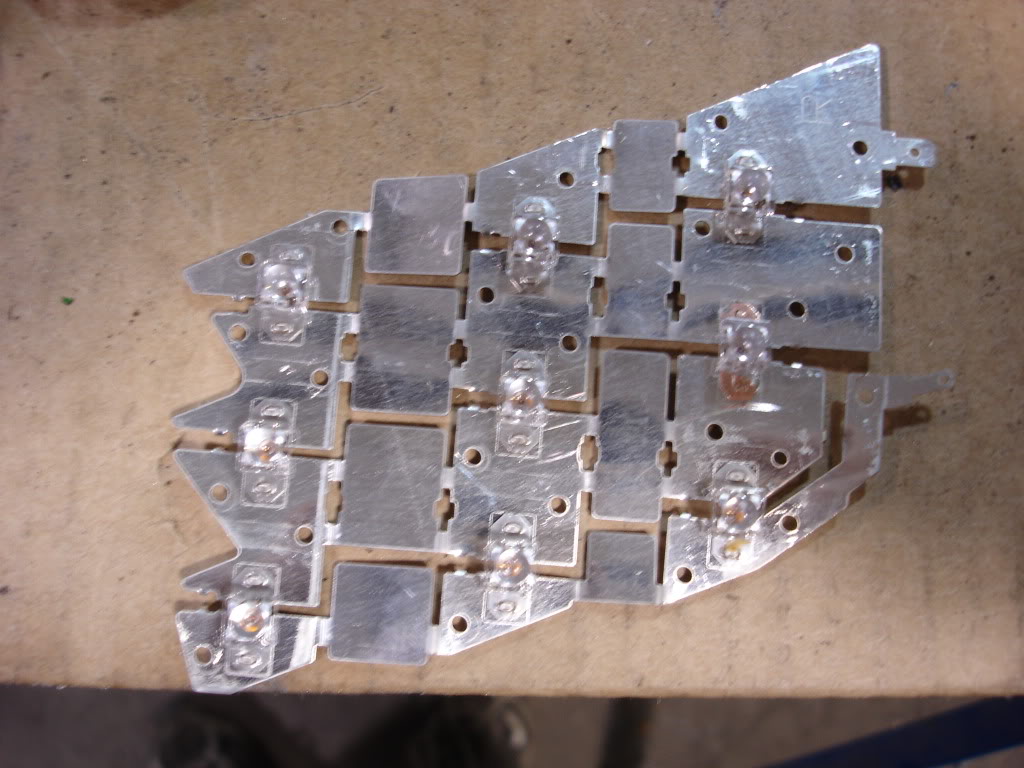

Alright so the gears are turning and since I can't seem to find a tail light I like I am going to fabricate an LED tail light from some scrapped parts off of wrecked cars.
Here you see a LED circuit board. I like this one because of its simplicity. There are two independent loops accounting for 4 wires -+ very easy. The plastic housing it is on is ugly and will not work in the tail as there is no way to evenly distribute the leds. I remove the circuit and the LED board from the plastic and am left with photo 2.

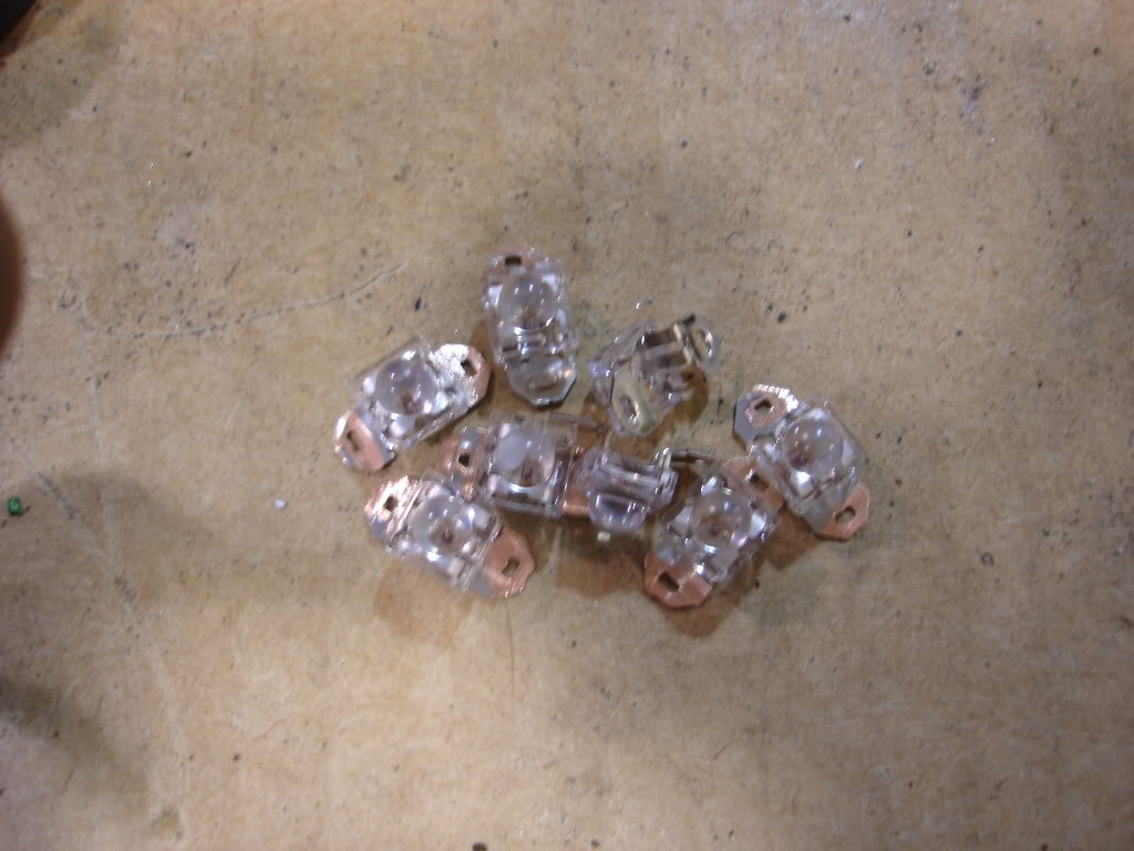

I will then take some extra LEDS I ripped from another tail light.
Then I will mount them to the other board for twice the LEDS.
After all this I will mount it to a formed piece of plexiglass and will then have to either find a red plastic or cut red plastic from a wrecked light for a cover. More to come later.
Cheers

What it looks like with all the LEDS

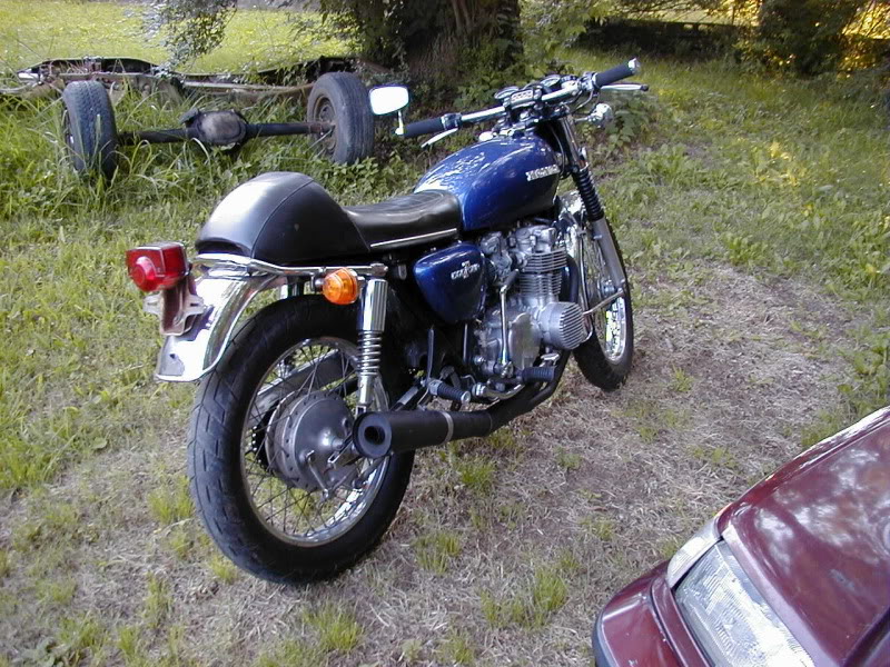

Heres my 72 cb500 I used to have. wish I had kept it. need to see if the guy still has it I might try to buy it back.
