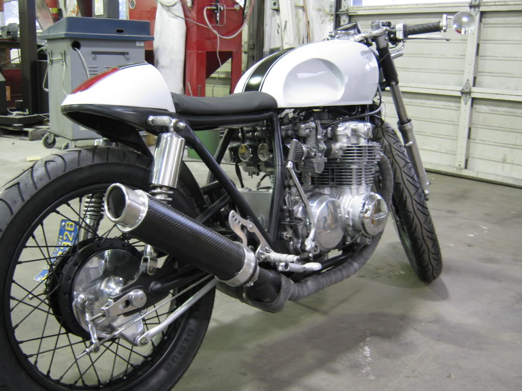

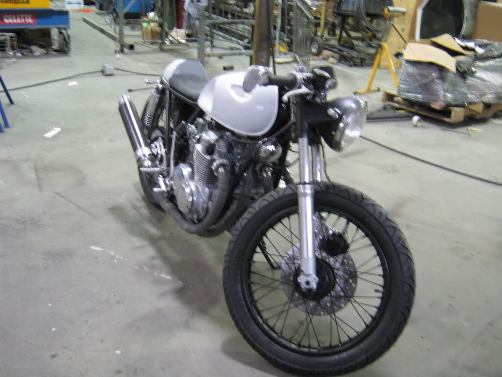

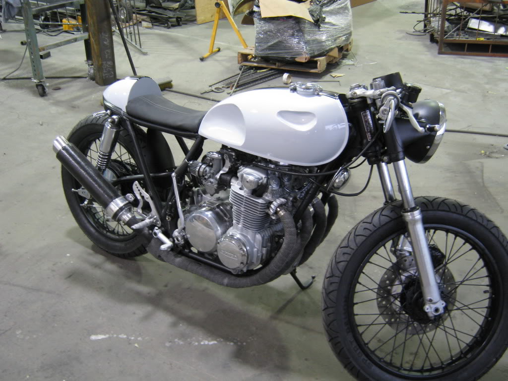

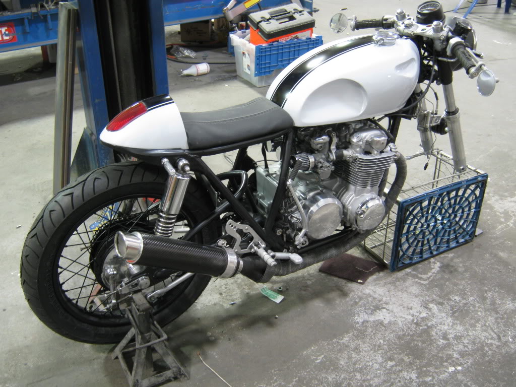

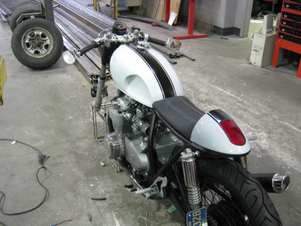

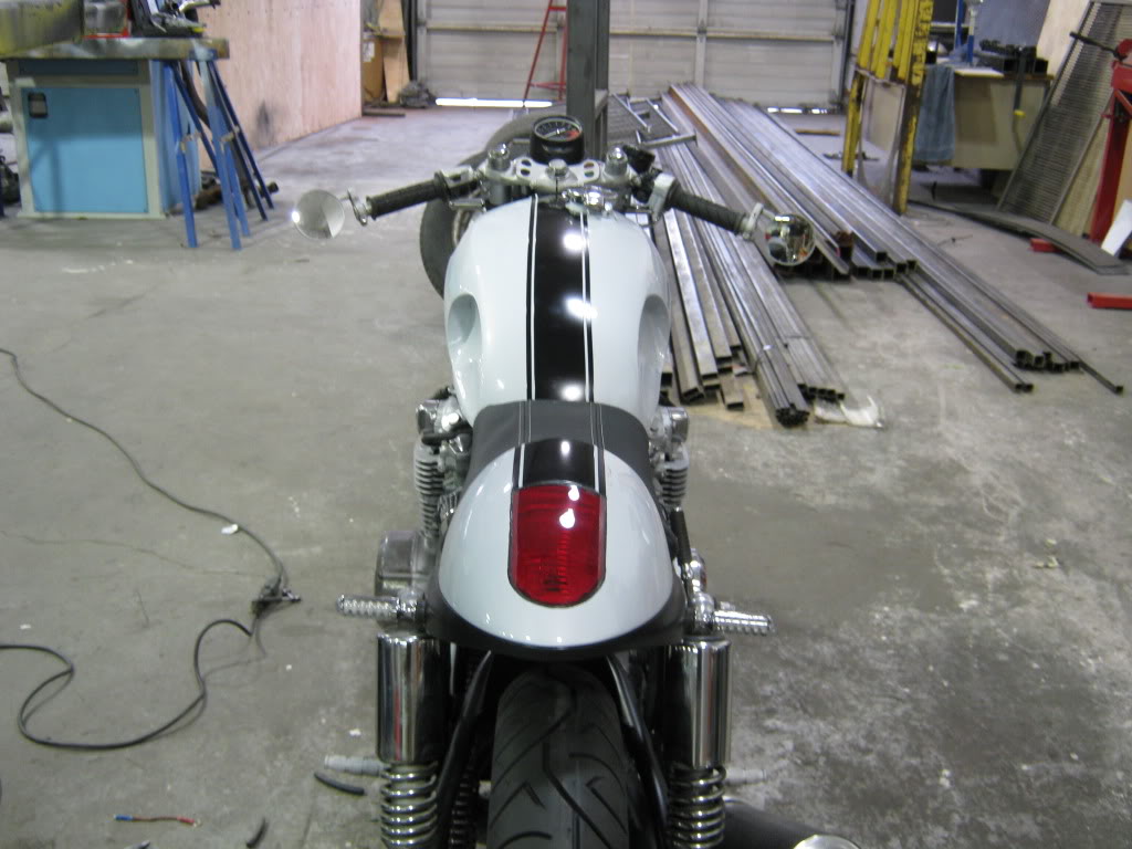

oh yeah!
Old Feb 6, 2010 | 01:28 PM
  #392
That is looking sweet....

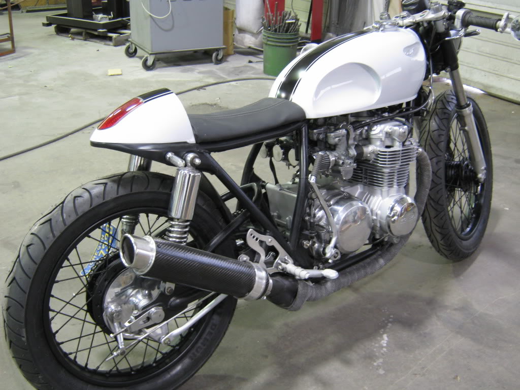

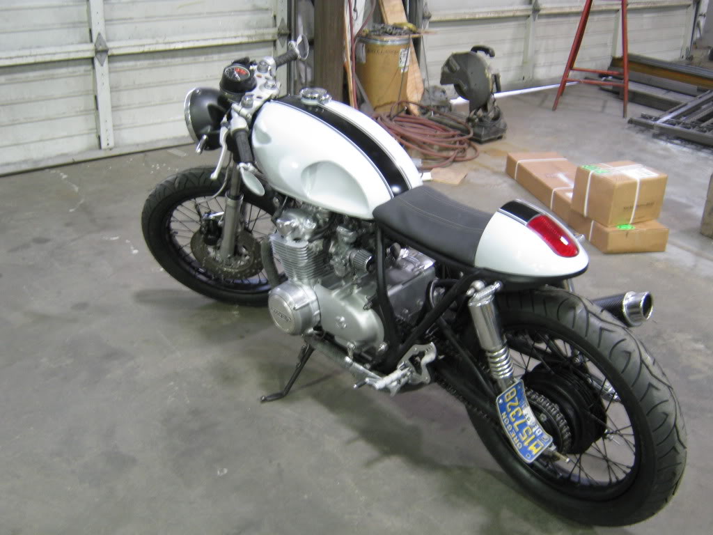

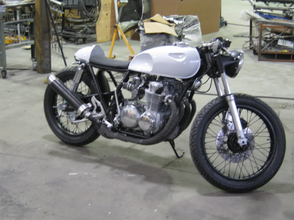

Here you go, it just needs the exhaust mount fixed and the speedo magnet attached and it 100% done with the build, not tinkering maybe but building yes.
Old Feb 10, 2010 | 09:06 AM
  #411
Little_Horse's Avatar
2nd mouse gets the cheese
Posts: 1,697
From: Beaverton, OR
Old Feb 10, 2010 | 09:33 AM
  #412
Nice! Congrats!
When will we get the ride report?
Old Feb 10, 2010 | 09:59 AM
  #413
Posts: 4,517
That's a beautiful thing! Congrats it's really really nice.
