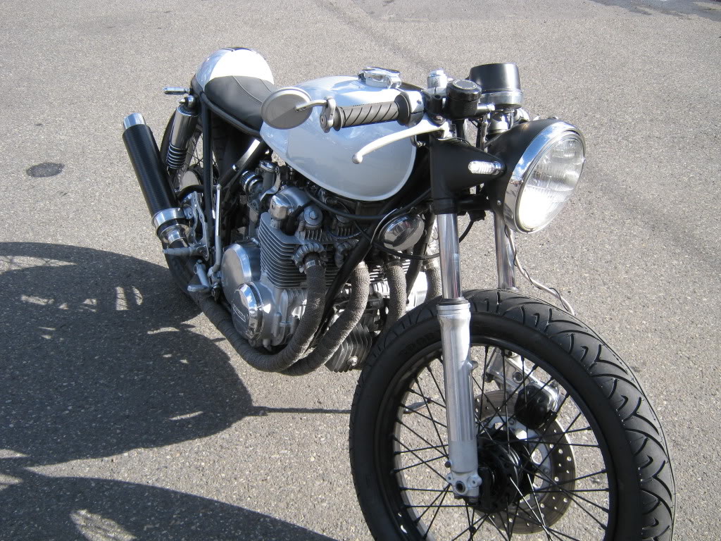

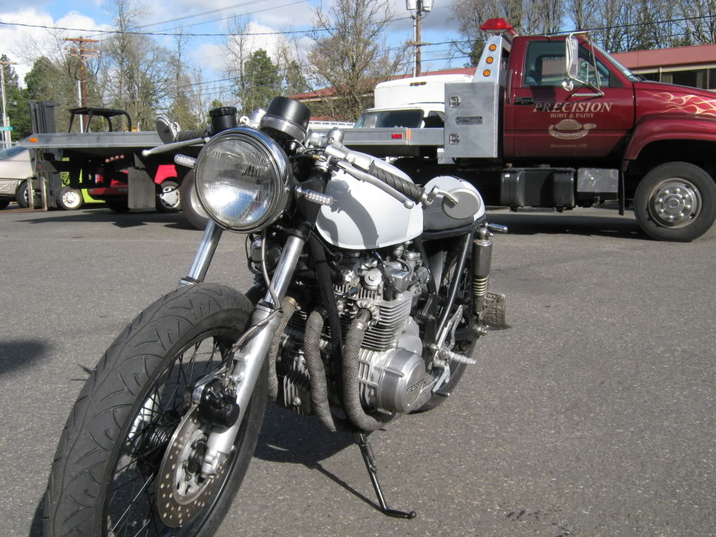

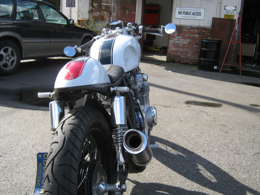

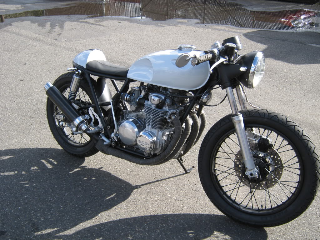

The bike looks great in the sun. The other day I rode it on a road with a couple of turns. I will have to get used to not having any roll on power on exit. The bike has really slim tires so it drops in with almost zero effort which is also something to get used to. Its fun in a kinda old rat ta tat way.

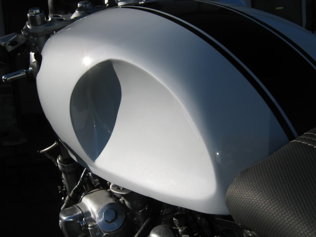

I will someday get some shots with the bike and hot women since its so requested . Until then I finally captured a shot that you can see the pearl in the paint... if you squint.
