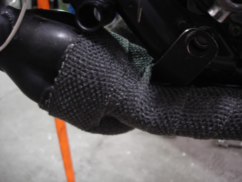

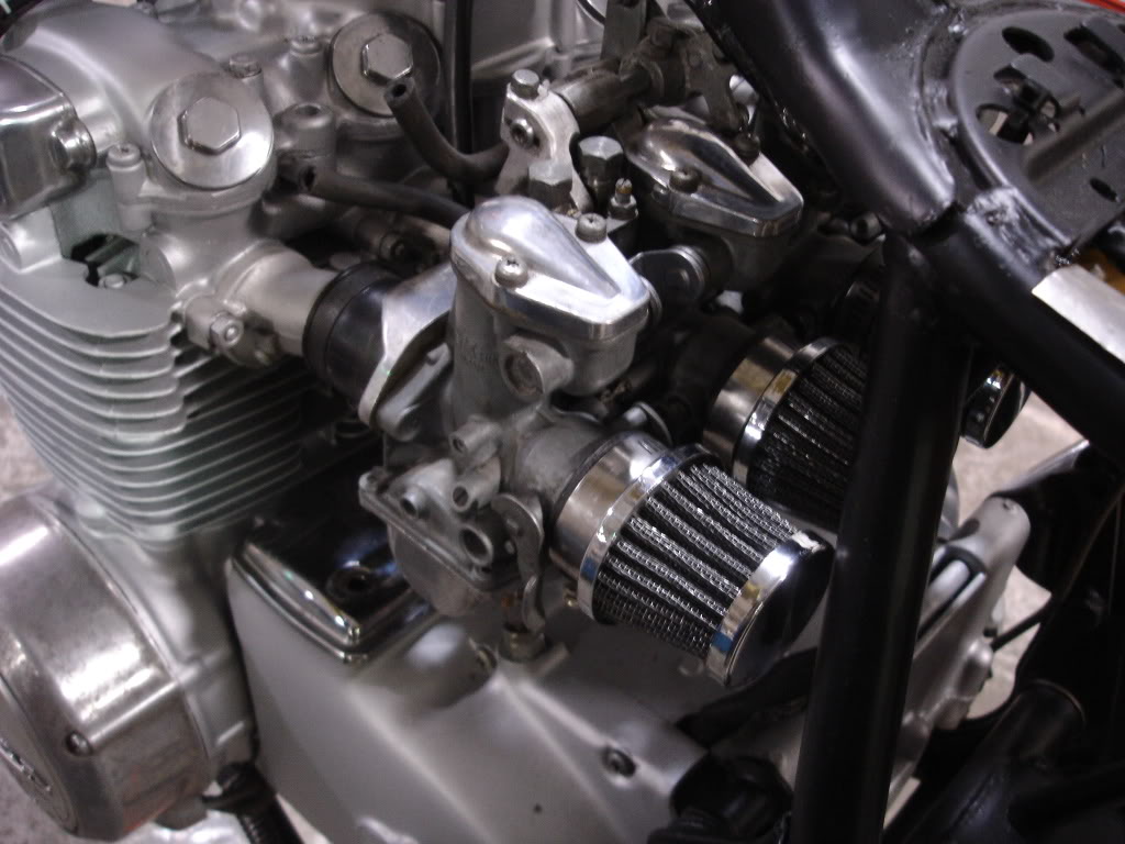

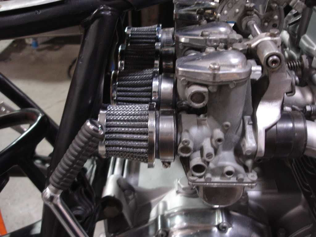

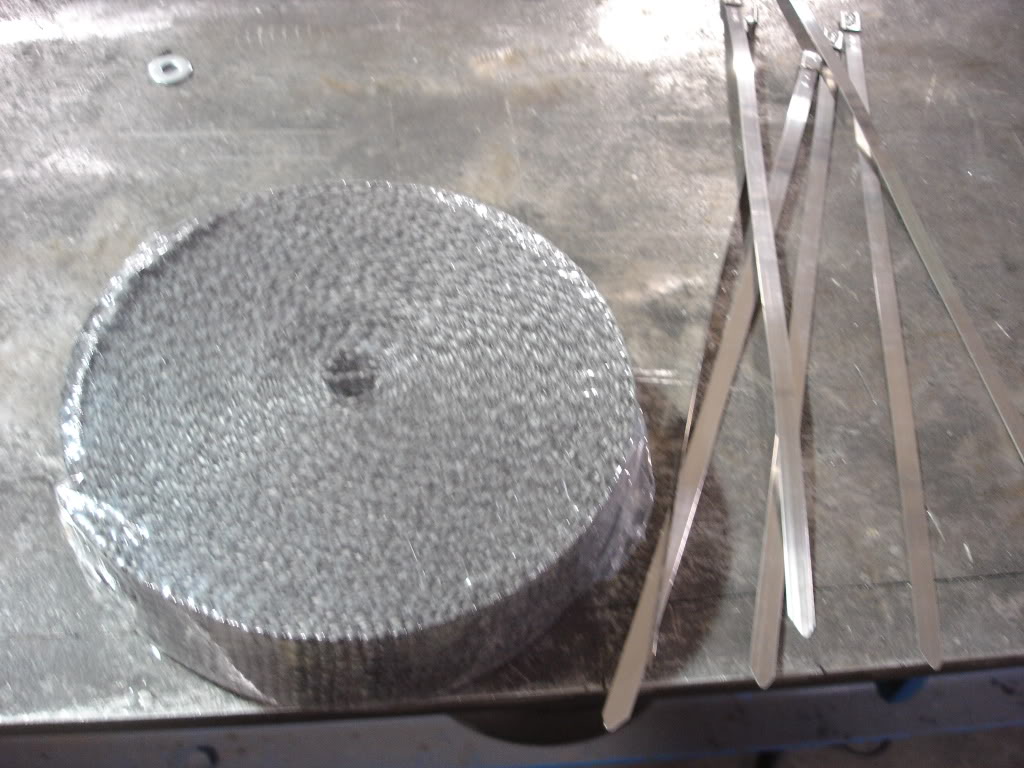

Well some parts have been trickling in. I received in the mail my four pod filters, and my exhaust wrap. I will try and wrap the exhaust on my lunch break, so I can put a few pictures up. Hopefully 50' is enough to do the whole thing. At any rate here are a few shots of the filters.

Exhaust wrap and stainless ties.

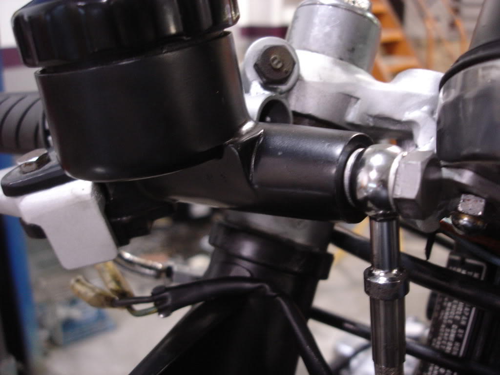

Project brake line upgrade

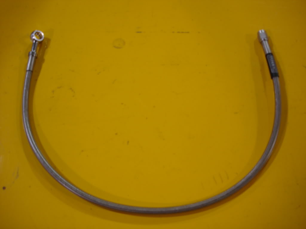

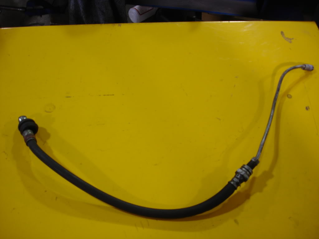

Alright so here is the deal. The old brake line is cracked beyond use. It is different then most motorcycle lines in that it has one banjo fitting at the MC and one 8mm 1.25 thread end for the caliper. This complicates things, they don't carry a continues line for the bike to avoid using an automotive solid line like in this pic.
So I bought a car line from something that uses a 24 in line, forget what car but baxter auto parts hunted one down for me. Its a braided line with one banjo and a standard thread end (whatever that may be). The idea here was to use an adapter made by the same company as the line, to alow the caliper and line relate. Problem is no one makes a metric to english adapter, go figure. Here is the new line.
Now for the solution. I got lucky in that one of the adapters that threads into the new line was aluminum, and so is the caliper. So I welded the adapter to the caliper with the correct threads up. Now they relate and I can have a spiffy looking stainless brake line for $34 including the adapter, instead of $50 + for a custom line. Pics of the caliper are coming soon as the paint dries.

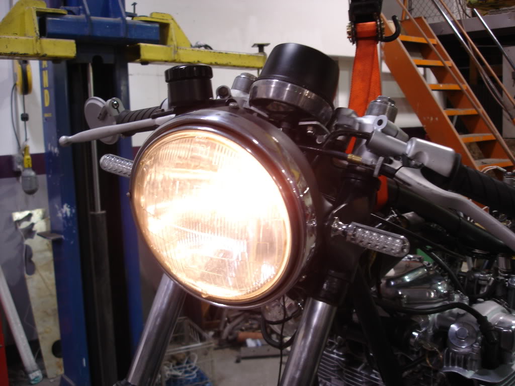

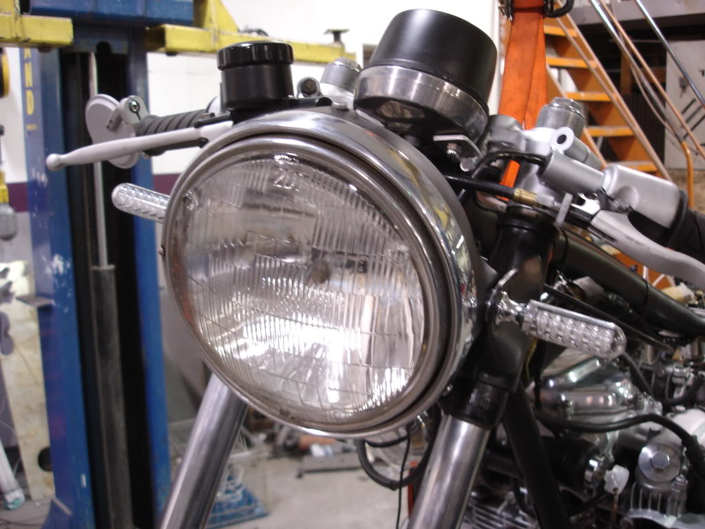

So I have all the electrical working, I won't be able to tie any loose ends up with the tail light until I get the cowl back, but the front is done.

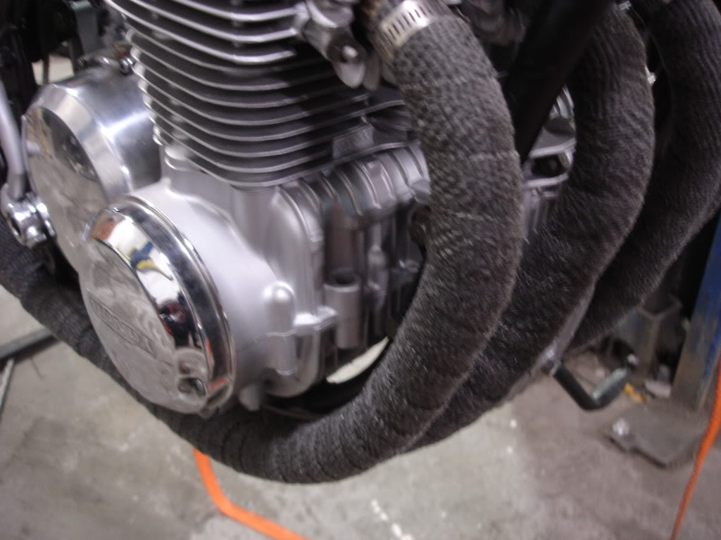

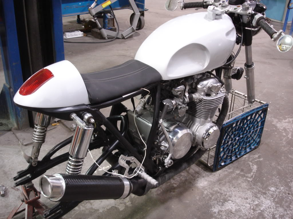

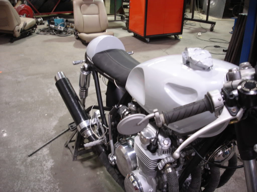

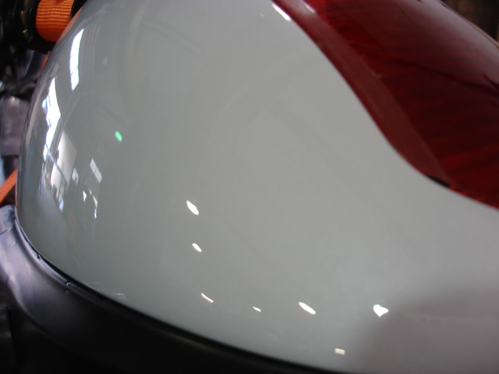

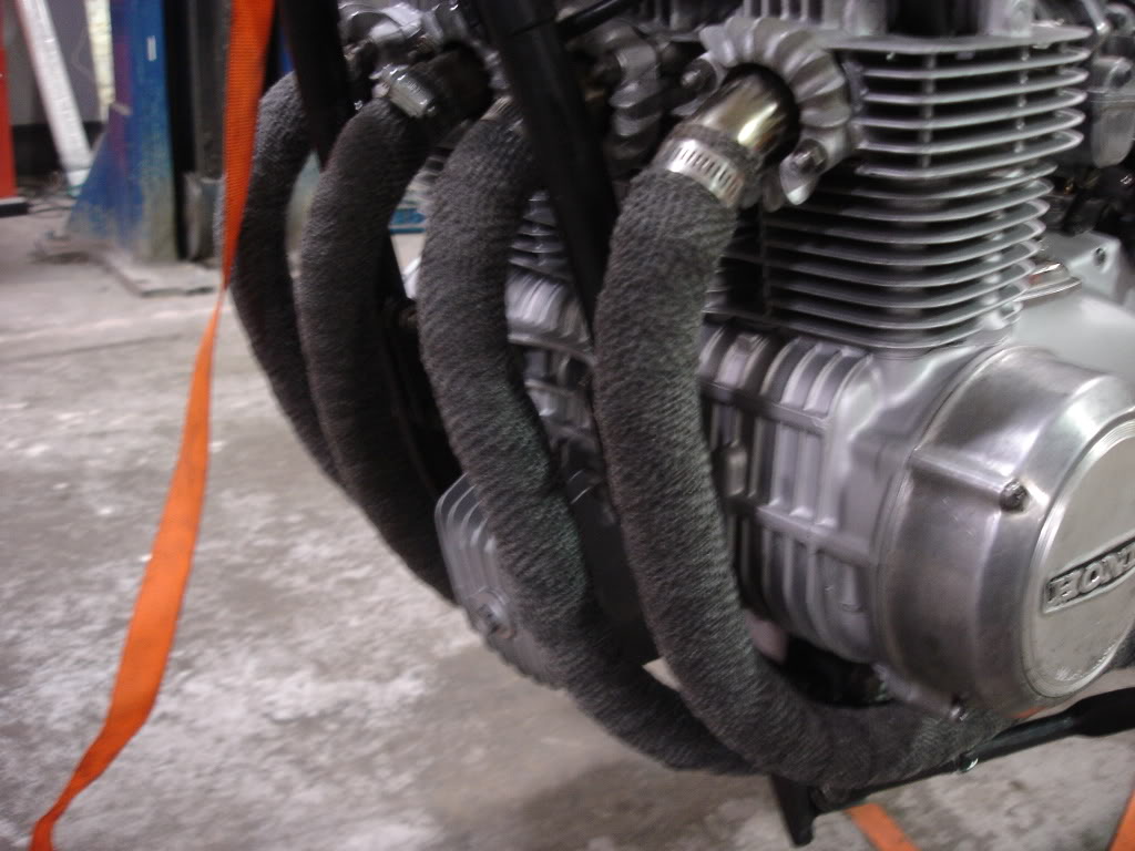

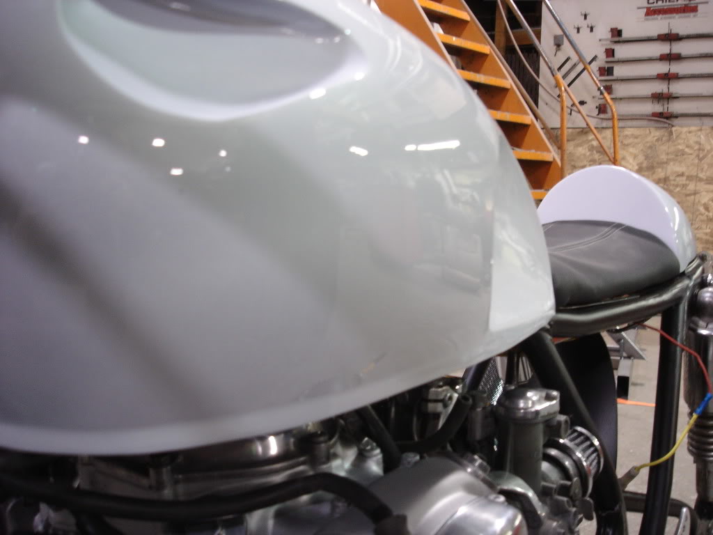

Lots happened today. I rolled into the shop to wrap my exhaust and found my body work painted the ghost pearl white. Its missing the stripe but I am posting a couple of shots anyways.
Exhaust wrap

Pictures by the way dont do justice for the color. In low light it looks silver and in bright light it looks white. It has metallic pearl flake, its smaller then metal flake subtle but to the eye you can see it, just not in pics. Its too bad because I would love for you all to truly see how awesome the color is.

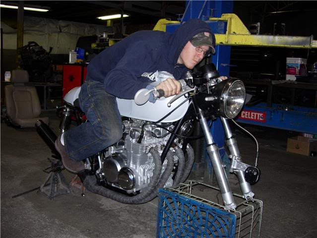

Anyone see anything wrong with this picture .
yeah, you definitely got too much weight forward for where the forks are located on that crate, and you're probably exceeding the speed limit of that garage your in. Looking good partner.

spladle160's Avatar
Posts: 380
From: Warrenton Virginia
You look sad even though your sitting on what will soon be a really cool bike. Oh wait I know it's the chicken and the egg, you were planning on riding the bike to go pick up your tires lol
You're wearing white socks with brown shoes. A definite fashion violation.

spladle160's Avatar
Posts: 380
You only figured out anti-gravity for the back half of the bike and are forced to use a milk crate up front for now.

PUSHrod's Avatar
Posts: 530
From: Central Fl.
No George Lucas 'StarWars' logo on the tank of the sky cycle.

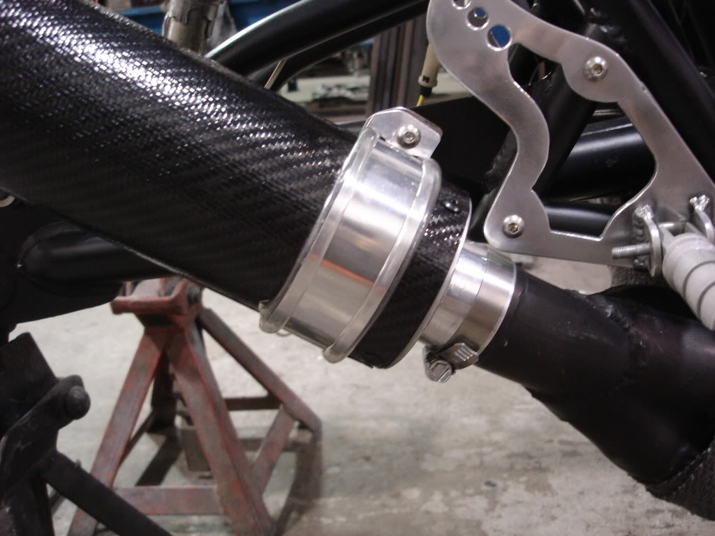

Exhaust clamp has been sorted.
