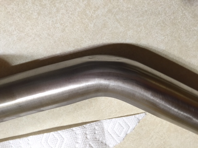

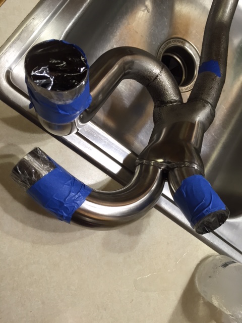

So I followed the dialog on the forum to take the dent out of the header I bought from Capt Chaos. I wrapped the dented area in a towel to insulate it from the surrounding tube using blue masking tape to secure the towel. I then used Saran Wrap and blue masking tape to secure all other outlets but one. I then filled the header until the the water extended about 6" past the dent on each side. I then taped up the headers last entry/exit with Saran and blue tape then into the deep freeze! The unpolished pix were shot by Capt Chaos to show the dent. I then cleaned up the header the after shots show the dent 99% removed I am soooo happy with the result!
Were the edges of the dent creased, or just rolled in?
So I finally got the pix downsized to comply with the forum attachment manager.
As you can see the header was actually dented twice. The first one was a small oval dent right at the bend. The second was a bigger smack that left a large part of the radius flattened... Being that is was a compound dent the results are amazing, I am very happy with the results, the forum advice and knowledge and having a big-*** deep-freezer (sub-zero temp)
