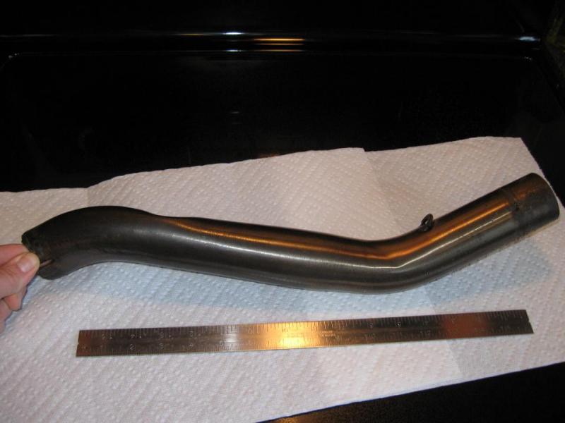

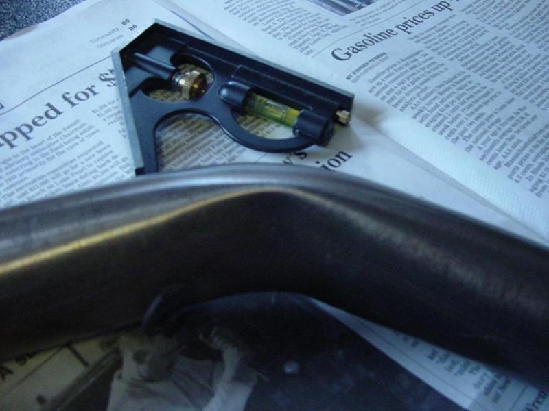

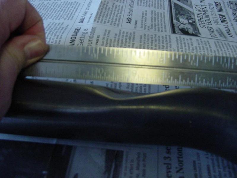

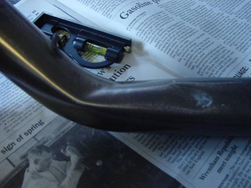

I know this is an old thread but it got my interest. I had a bent mid pipe and figured I'd give the ice method a try and post a few pictures in case someone wanted to give it a go.
The pictures of the "Bent_pipe_x" show the damaged pipe. There are a couple large dents and a substantial crease at the elbow on the muffler end of the pipe. The crease changed the angle of the pipe so much it not only made it impossible to remount the pipe, it made it useless for the exhaust shop to use as a template when making another.

Old Mar 20, 2010 | 07:51 AM

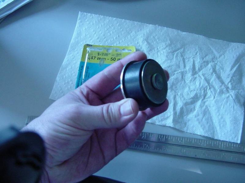

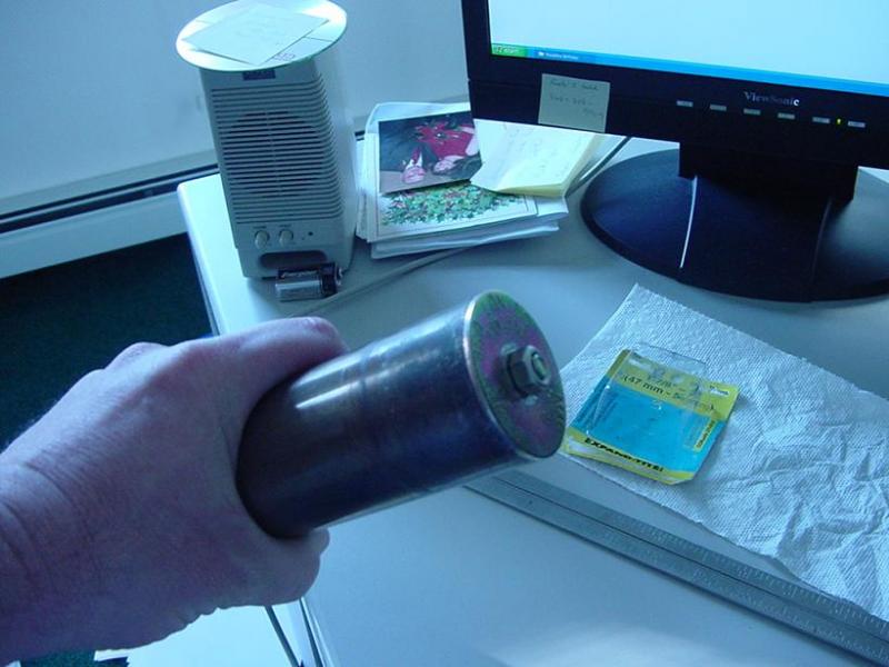

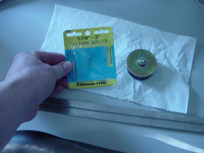

The "Plugs_x" pictures are of the expansion plugs I picked up from the auto parts store. They are < $4 each and do a good job of sealing the end of the pipe. I'd insert the plug into one end of the pipe and tighten the nut until no water would leak out. Then tighten it just a bit more to keep it in place else the expanding ice will push the plug out too easily.

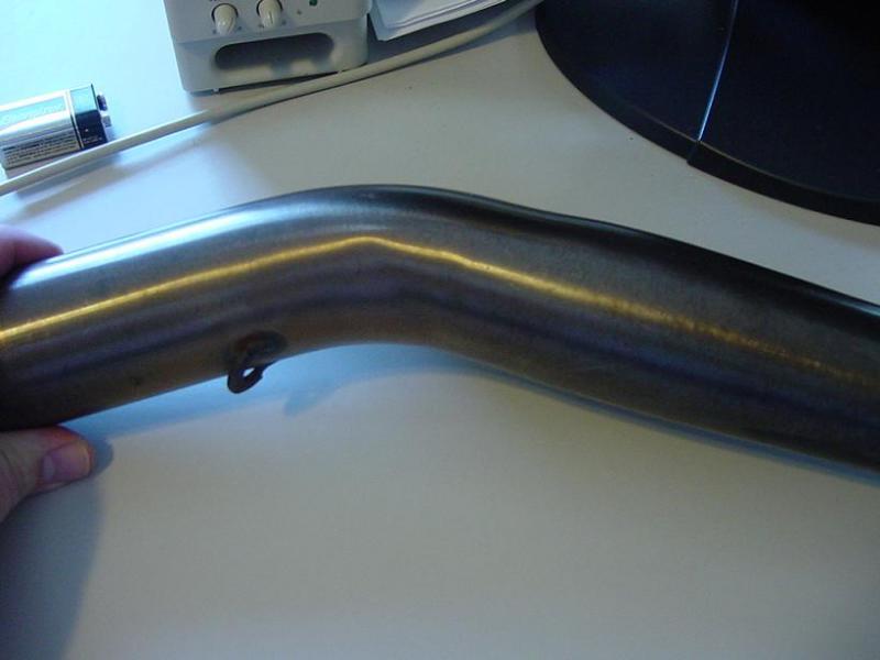

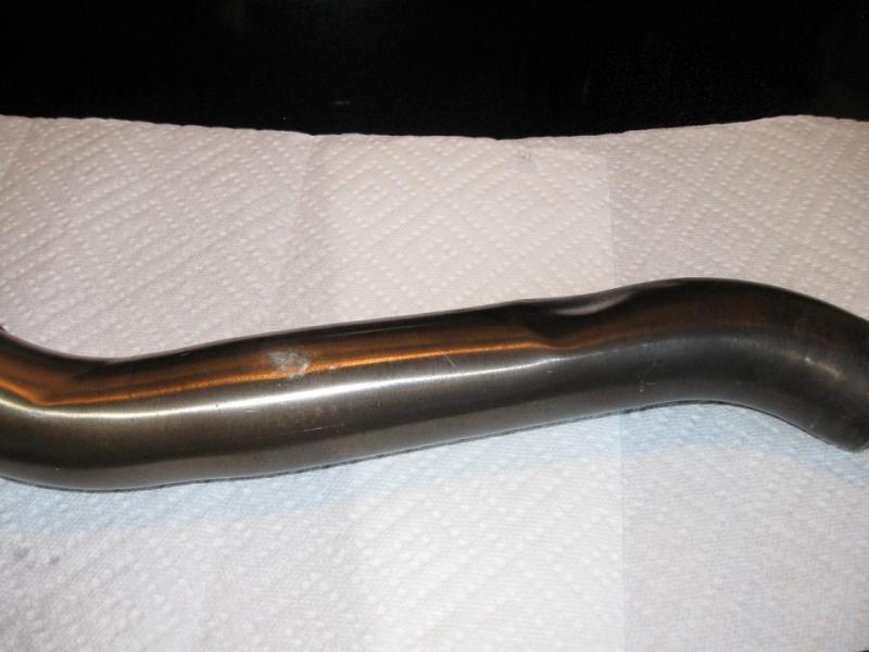

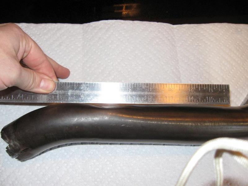

The pictures of the Better_pipe show the improvement after a half dozen or so freeze cycles. After each freeze cycle I'd take the plugs out and let the water thaw/drain before refilling with more cold water. That way you fill the "larger" pipe completely.

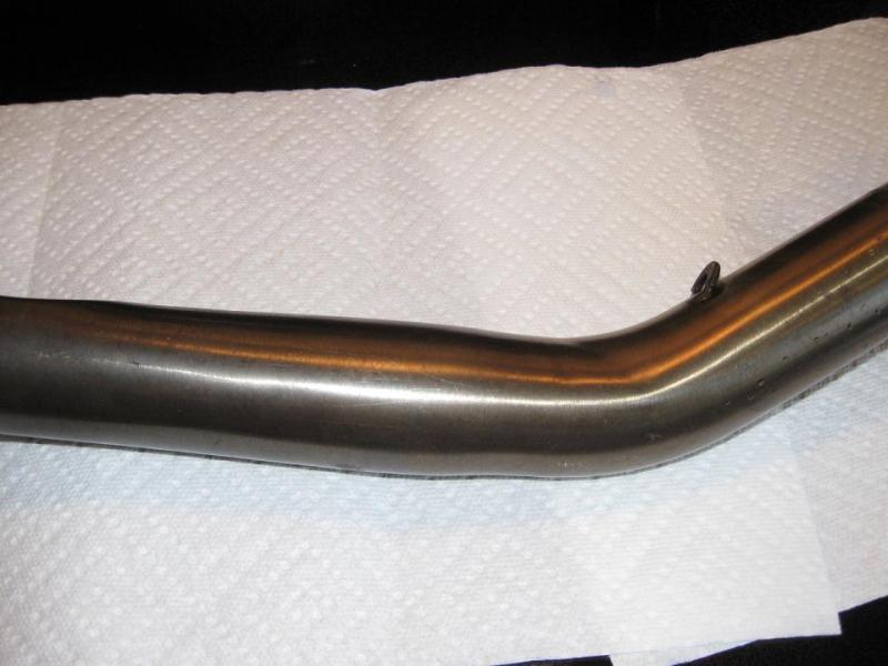

As others have mentioned this approach works but you have to be careful not to push it too far. At some point I imagine the pipe would split. You can see in one of the photos where the last freeze cycle actually began to swell the area just before the muffler end elbow (the end with the ring tab). It managed to completely push out 2 of the big dents, got rid of the crease at the elbow on the muffler end and greatly reduce the dent size at the header pipe end.
Dent/damage on mid pipe. Newbie Q.-better_pipe_5.jpg Dent/damage on mid pipe. Newbie Q.-better_pipe_6.jpg
Dent/damage on mid pipe. Newbie Q.-better_pipe_7.jpg Dent/damage on mid pipe. Newbie Q.-better_pipe_8.jpg
My goal wasn't to use the pipe again, but as a template to give the exhaust guy when bending a replacement. Still, I wouldn't hesitate to put it back on the bike in its current condition. The small dent near the header pipe end is around a 1/3rd its original size and is small enough that I doubt it would greatly affect performance. When mounted, the dent would be hidden from view as it would be facing toward the shock linkage.
