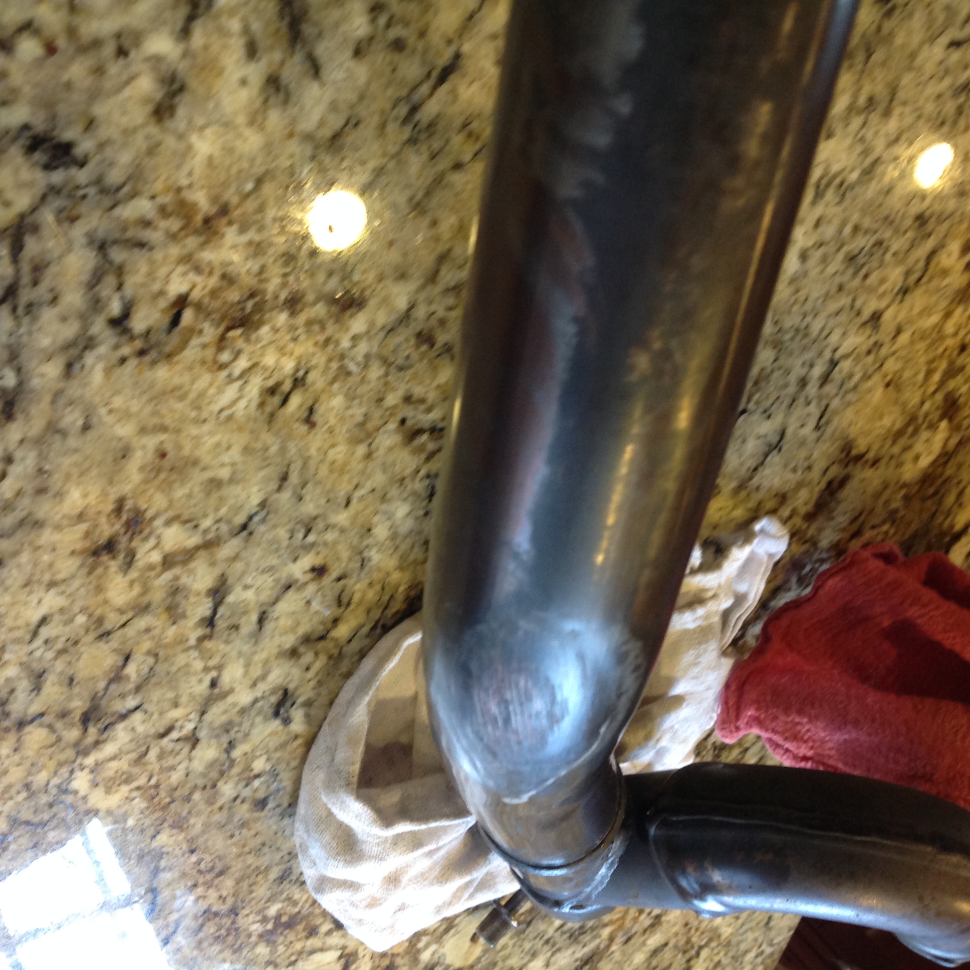

Now You See it Now You Don't
Header pipe dent removal-image.jpegThis forum is one of the coolest thing to ever hit the world. Did the throw it in the freezer trick.
Old Feb 15, 2016 | 05:10 PM
Dantheman's Avatar
Joined: Jan 2016
Posts: 2
Dantheman is on a distinguished road
Dented header front cylinder
This is the before pic

Well I'll be darned! What a great idea. I've got a very similar dent to yours Dan. May be one day I'll give this a try.

wow! when i started reading my skeptical mind immediately judged this as hocus pocus. then all the reports of successful repairs and i am transferring this file into the "strange but true" folder. nice tip.
