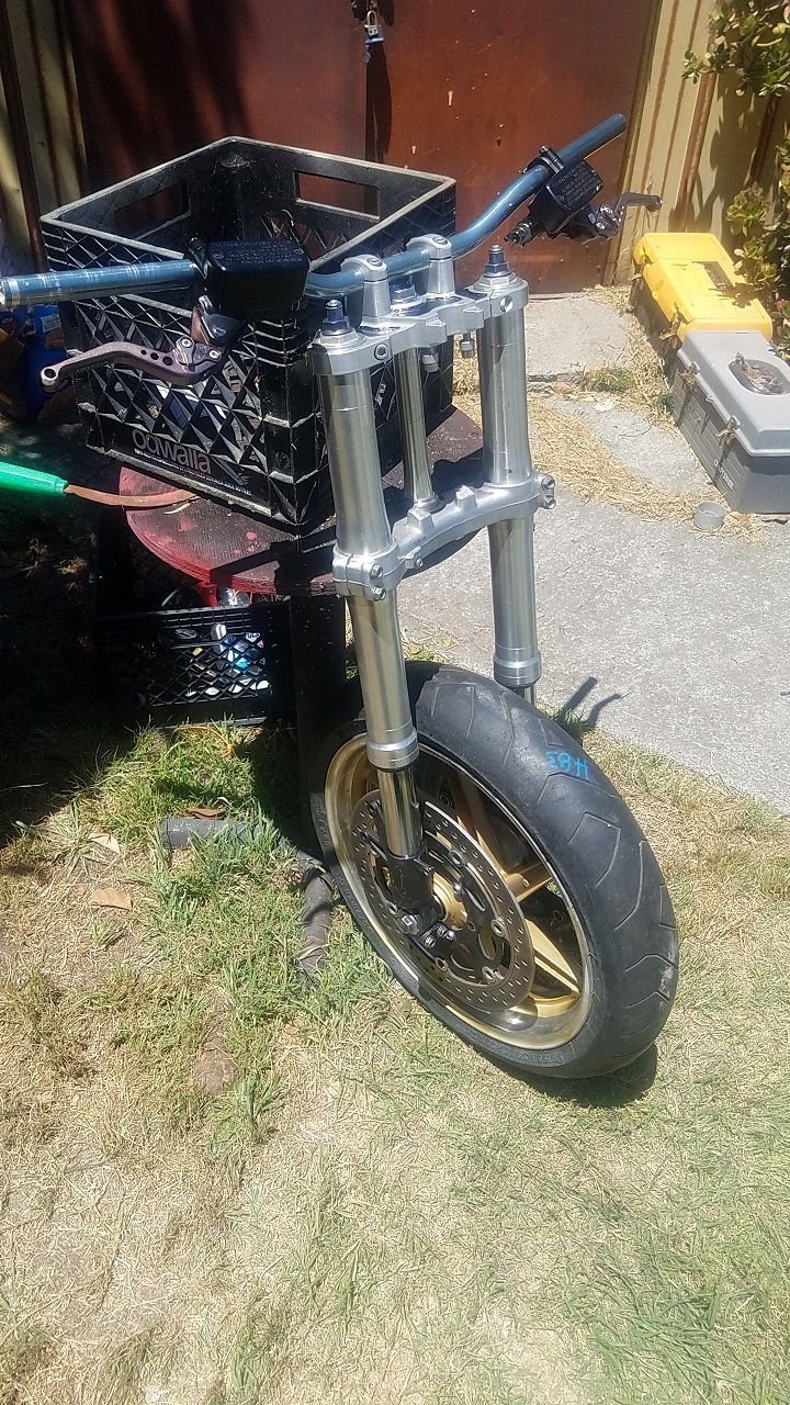

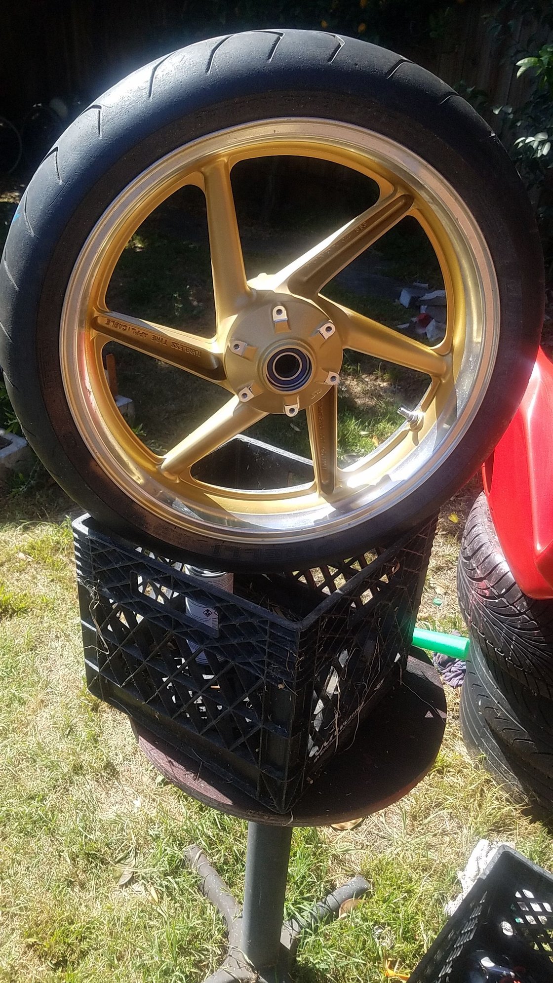

Not sure how much HP I will get from the gold wheels.... But I got em...
RC51 front
CBR900rr rear

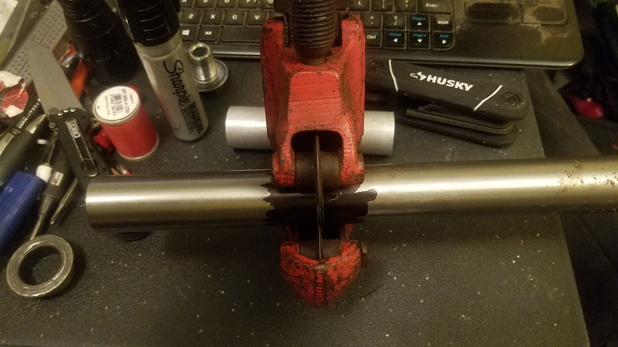

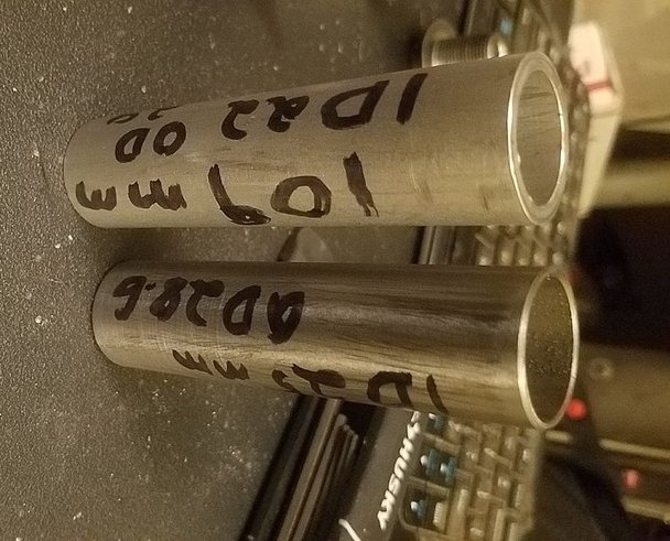

Had a hard time finding the spacer I needed to run the 954 bearings in the rc front wheel... Then it hit me... One of my other hobies is bicycle building, and I had a threadless stem tube that is 25.4 id and 28.6 od... Perfect... Out comes the tubing cutter, and BLAM!!! Spacer...
1 1/8 chromo bicycle steer tube
RC on the left, "Custom" on the right..
Now I am ready for the front end swap.....

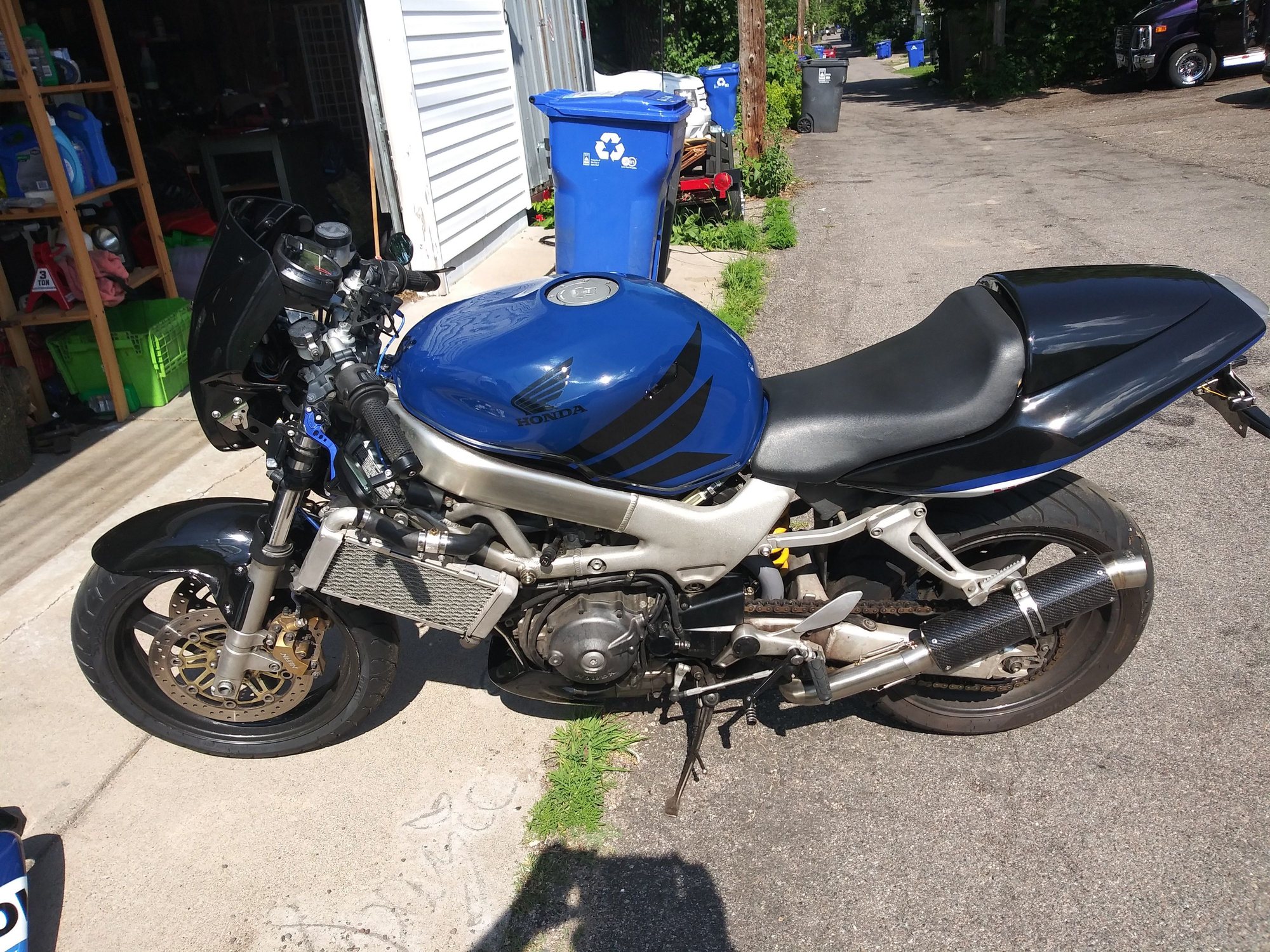

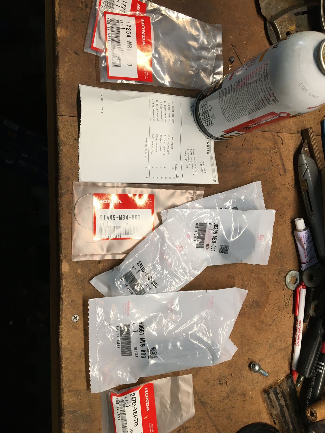

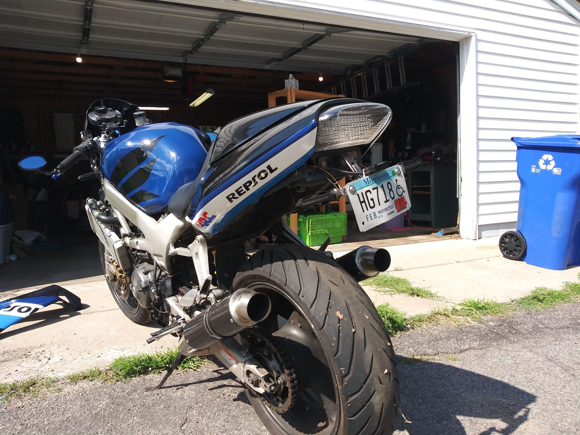

I got some smalls to replace some stuff that went missing when we went down. Replaced both front signals and realized I need the hole grommet. Then I couldn't find the chin fairing hardware. Won't be long she'll be back on the road.
I do have an oem Superhawk decal for that import panel. And I bought a new Cortech tailbag and mounted it. Still need to buff the paint. I'm excited to try the new M4. I have yet to ride it since that went on.

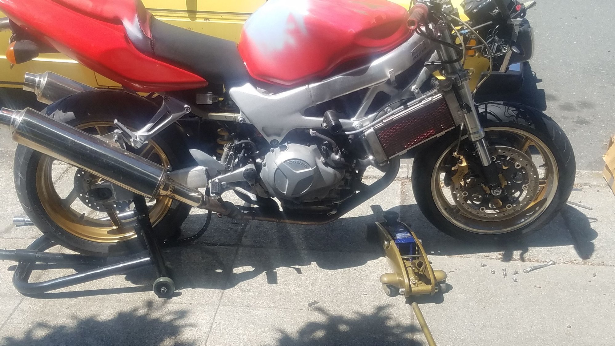

(what I did to my superhawk yesterdayyesterday)Back wheel was wrong, and I didn't notice until yesterday... So I am only half done..

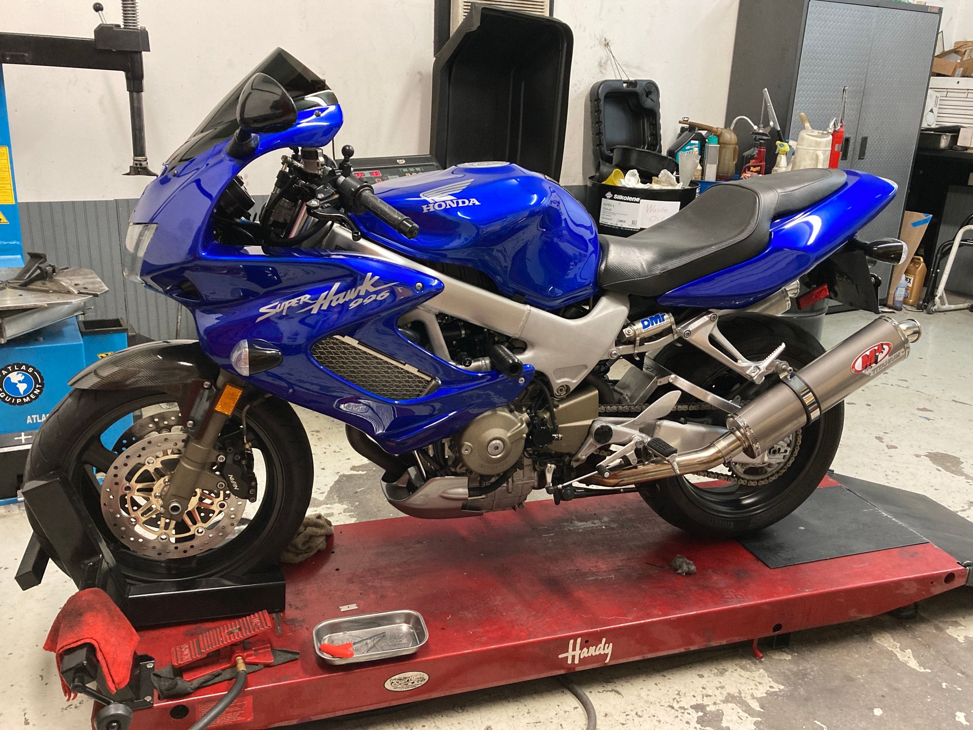

Shakedown run today. The M4 is nice. I had the front wheel come up a little in 3rd gear going down hill.

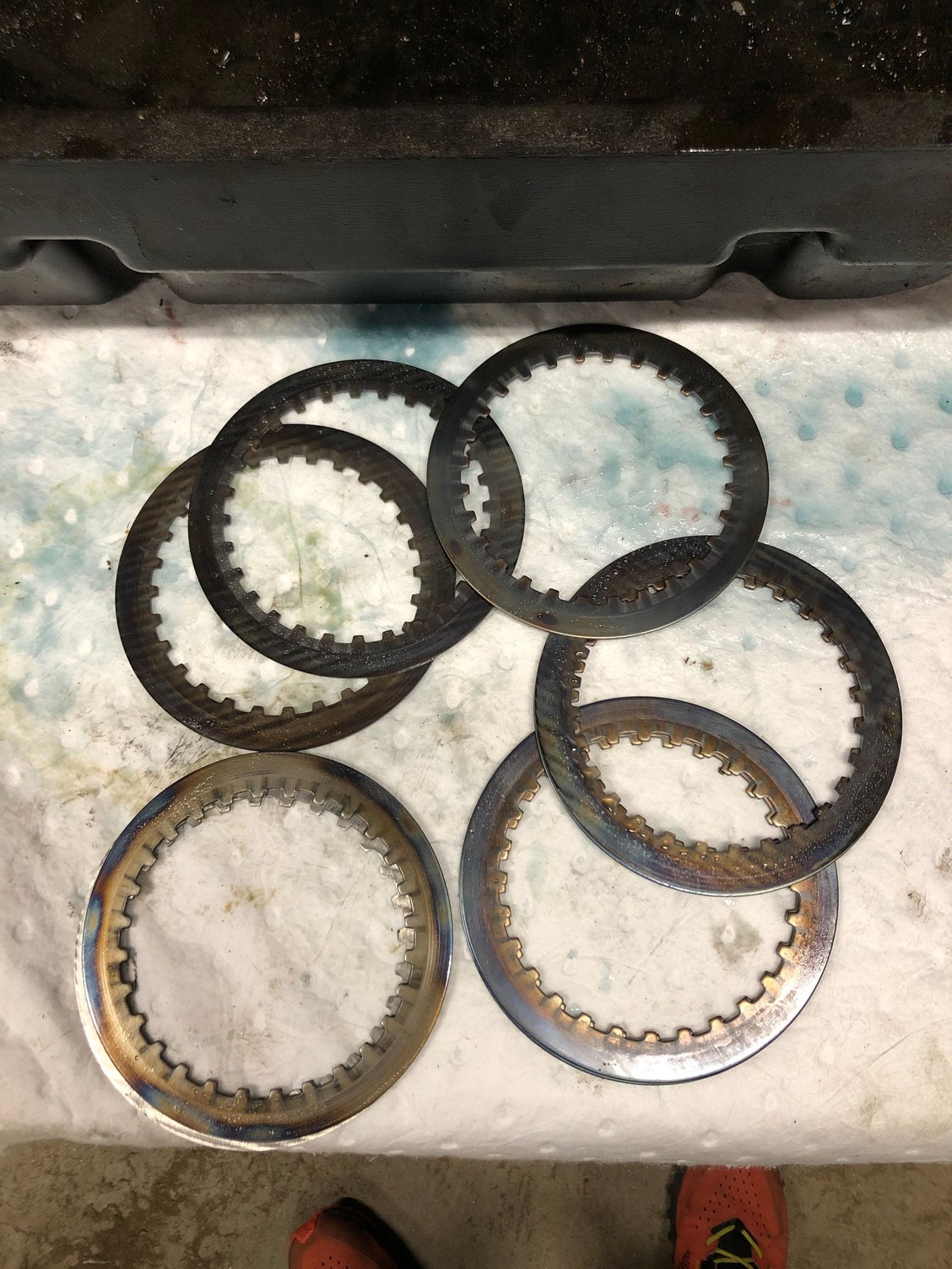

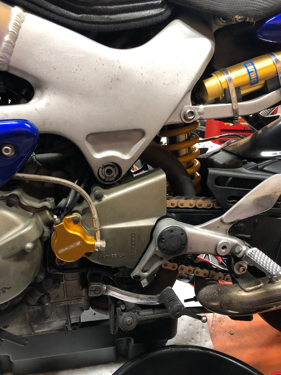

Changed my clutch plates (steels and friction), springs and a fresh oil/filter change. Also installed a new gold Oberon clutch slave cylinder. Look at that lovely bluing on the steels 😁
EBC kit?
Old Jul 6, 2020 | 05:22 PM
  #2448
YoshSuperHawk's Avatar
Posts: 62
EBC kit?
I put the Barnett Kevlar clutch kit in. The blued steel drive plates were OEM and the frictions were also. The frictions looked brand new 🤷🏻‍♂️

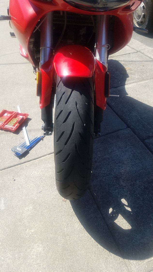

Started off the morning by getting intimate with my valvetrain.... Valve adjustment, and tensioner adjustment, along with a set of plugs. Ended the day by adding an Aprilia rsv1000 front fender... Much smaller than the rc51, or cbr part. Even came in red...

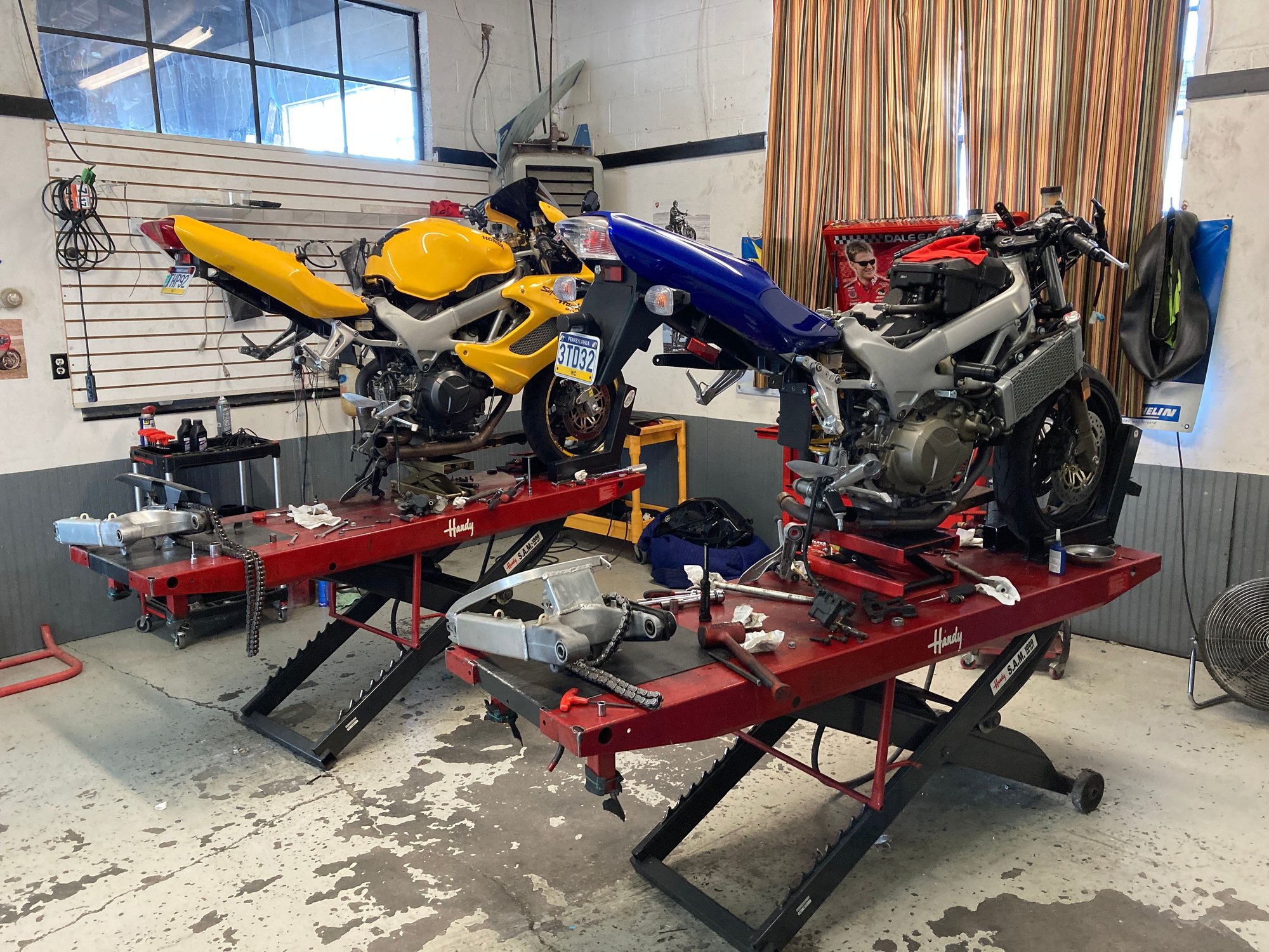

I worked full time at that bike shop for several years and I’m just a part timer now. Boss went on vaca so I took over the place. Wish I had 1 lift let alone 2!

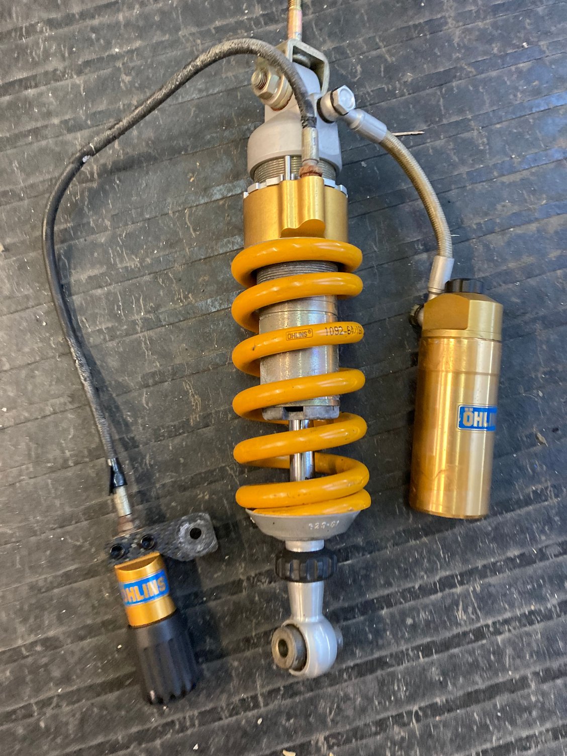

Progress last night.
After swapping this to blue, it felt like a pogo stick, so I put the DMr unit on till I can get it rehabbed.
Fresh Kriegers! And brandy new F4i shock (and fork springs).

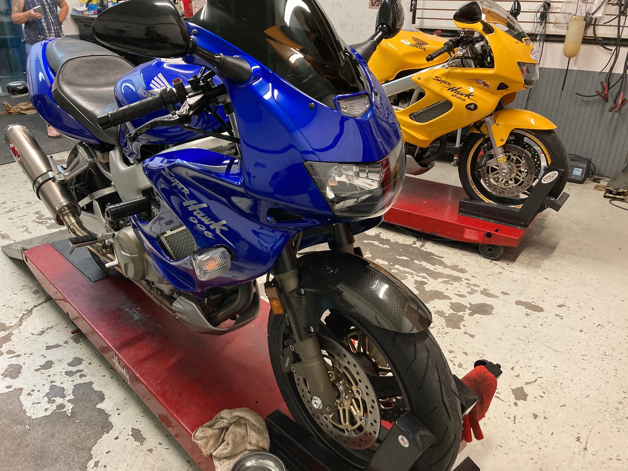

Unfortunately this chain is too short for the larger rear sprocket. Looks like I’ll be ordering up a replacement.

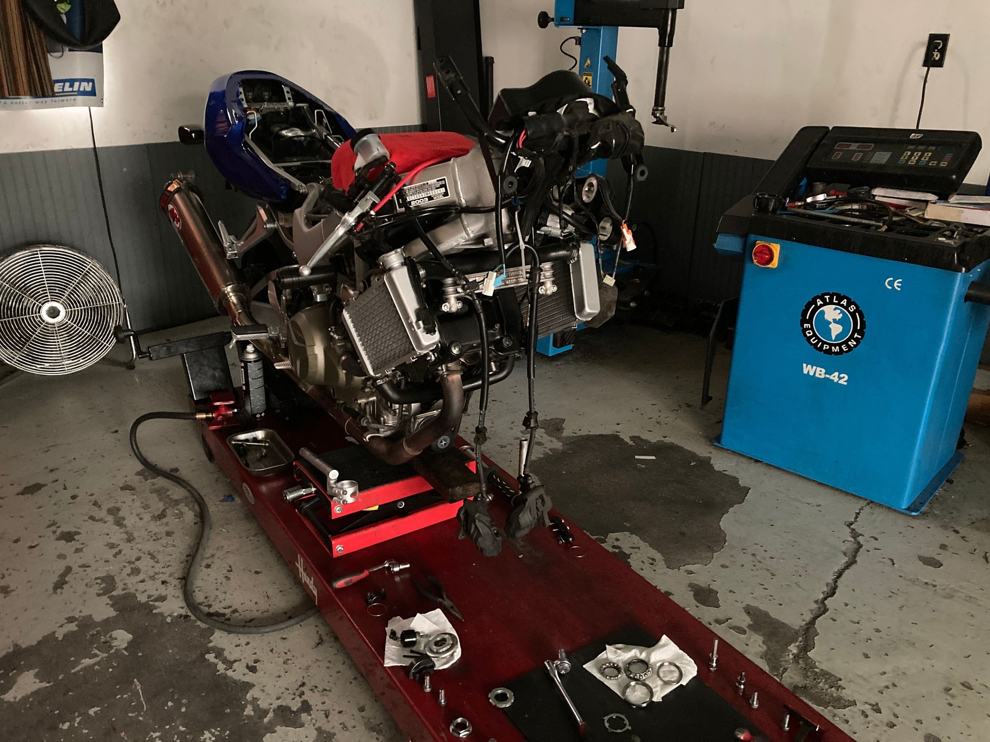

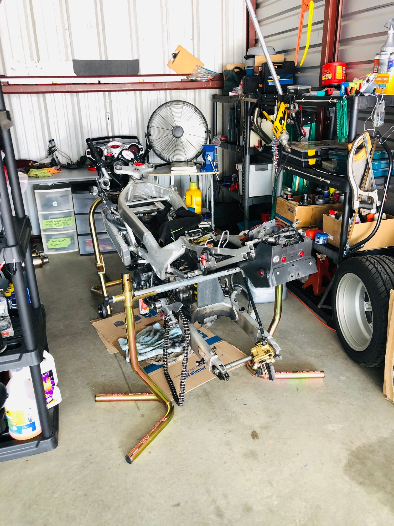

Dug it out of the back corner of the shop, washed it, and tore it to pieces. Its time to get back on the SH........
I have not ridden anything but our trainer bikes for more than a year for test rides after service.
Went to work full time during Covid, after hours working on the training fleets, and just had no motivation to work on my own bikes.
After 9 years, of coaching, fleet mechanic, and fleet manager I resigned from the training company. And like that I walked through the shop........and wanted to build.
