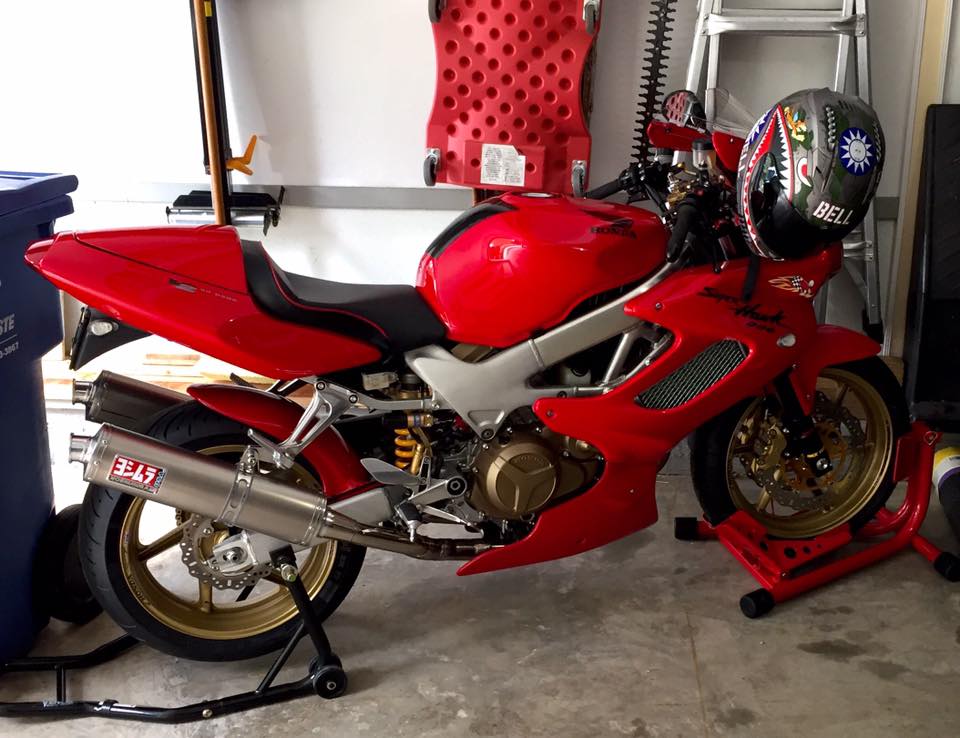

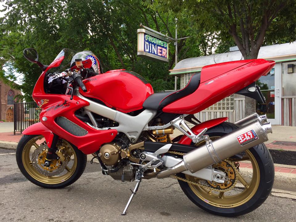

Put a 70 mile shakedown run on the VTR last week The thing just runs incredibly well right off the shop floor.
The sag needs to be set front and rear. I fear that I may have gone about 2-3mm to high in the rear ride height, but I won't know until I set the sag. The spring rates are so far really perfect (thanks to Ducati Wizard Mike Weber) and the damping is really nice too (thank you again Mike Weber) the bike is firm, yet supple and compliant over bumps and transitions.
The carbs are working very, very nicely (thank you
Jay Morrison and Jack Flash), it fires right up idles nicely, pulls crisp and clean off the bottom, cruises at 3-4.5K RPM without any surging, and accelerates at any RPM without any drama at all. No carb farts, no popping on decel.
Brakes are great too with plenty of stopping power. I would like a little firmer feel at the lever, but I think some of the issue may be my hydraulic front brake light switch, as they have been re-bled and the system is air free.
The handlebars are the bomb (thank you Erik Marquez) I made some further adjustments to the angles and they are now very comfortable and work nicely with the Sargent seat
(Thanks again Erik Marquez)to make for a surprisingly comfortable ride.
The bike makes nice noises (Thanks to Captain Chaos and Marcello Castellucci) , and is a hoot to pilot! The guys at my old sponsoring dealer Manchester Honda all came out for a look-see. They thought it was pretty cool! I also took it up to Ducati Central, and Weber gave it the thumbs up!
�� It is BIG TIME FUN !!!!
Last tidbits to do color sand the belly pan, buff it out then mount it up!
Attached Thumbnails What did you do with your SuperHawk today?-19884247_1687058807994833_1548964447185458318_n.jpg

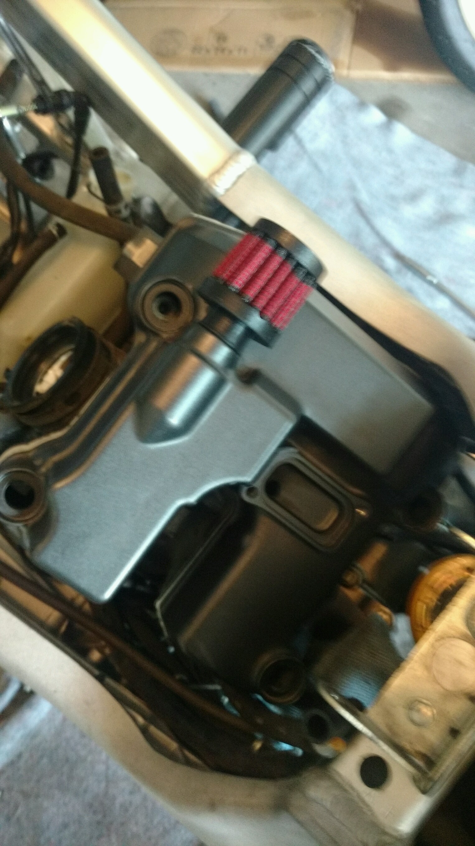

I put on the case breathers for the tops of the valve covers getting my psr block offs on. flushing the coolant system to get ready for engine ice. placed the vent cap on the carb from the deleting the pair valve and reeds. so quick question for you experienced super hawk peeps out there. are the only case breathers on top of the valve covers?
Attached Thumbnails What did you do with your SuperHawk today?-img_20170713_183327693.jpg
