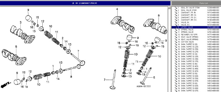

Years 1998 -> 2005 "Lifter, Valve" (item #9) have the same part number 14731-MBB-000, for both front and rear cylinders. Based on that, anyone should work for you. They are highly polished and look like mirrors. Any that are different in color are probably heat distorted and should not be used.

I know the outsides are silver, (and I sent you a pm psyclown I read your post after I posted this) but with some bikes the factory puts in slightly different buckets (lifters) depending on the head. They are size matched. These slightly different sizes are marked by different colors of paint dots on the inside of the buckets. I know some bikes that have multiple sizes but only one is ever listed in the parts catalogs/fiche. I didn't know if hawks were this way.
