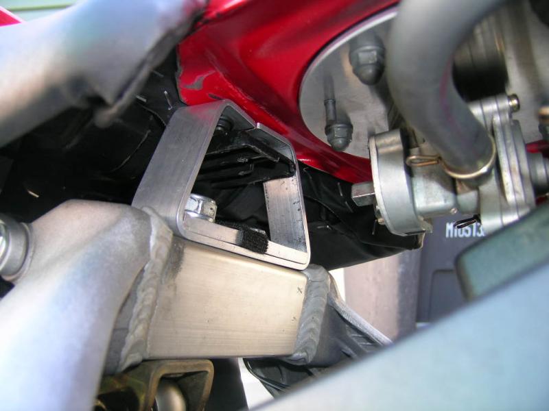

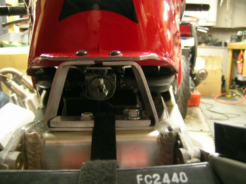

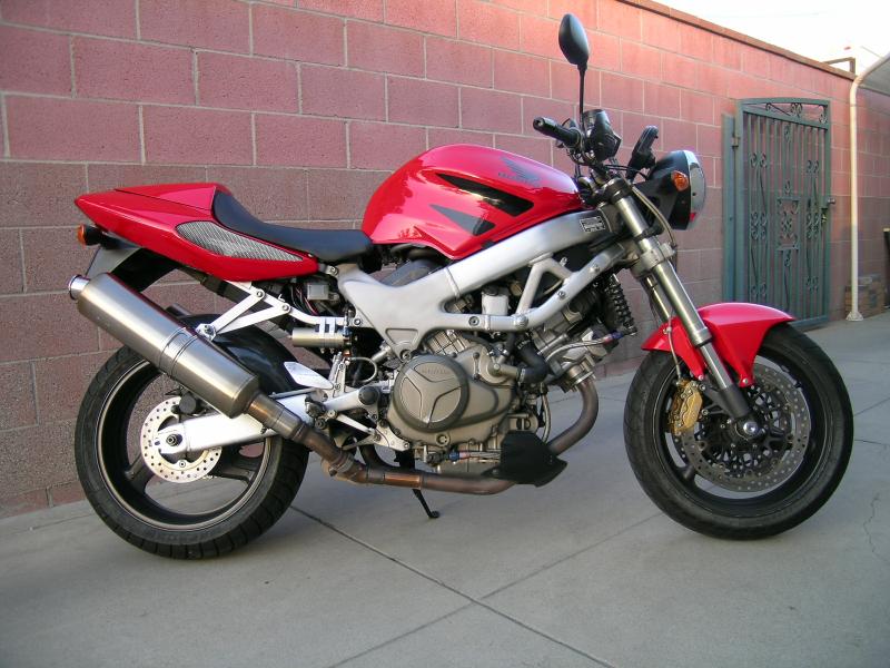

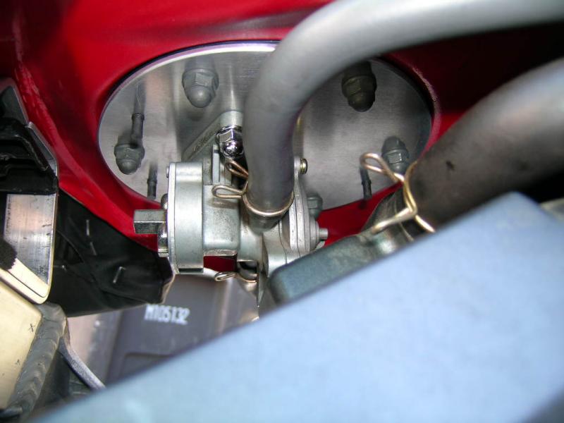

Let me know if you are interested in doing the conversion.
I'm thinking of maybe doing a kit where you supply the stock fuel valve, airbox lid and fuel sending unit and the VFR tank. (98-01 model year because it fits the frame nicely )
I supply the adapter plate and gasket that holds the fuel valve and closes the fuel pump hole on the tank, as well as the rear mount.
I will then modify the parts to make this a bolt on conversion.
The other option is that I sell you my Canadian tank ( teal blue ) I just bought, or the tank that is on my bike right now which does have some small dents in it, but is ready to bolt on.
Here are some pics of my installation.
The rear mount will look more OEM on the kit, the only question that remains will be whether you want the seat raised like I did.
I have no idea yet as to what to charge, so let me think about that aspect and let's see if there is any interest in the kit.
Kai Ju
Attached Thumbnails VFR Gas Tank on SH???-image014.jpg   VFR Gas Tank on SH???-image015.jpg   VFR Gas Tank on SH???-image034.jpg   VFR Gas Tank on SH???-image041.jpg

kai ju,
Just out of curiosity (as I enlarged upward a VTR tank +1 gallon instead), why didn't you mount the petcock 180 degrees (so the vacuum diaphragm faced the rear) which would provide more clearance from the rear cylinder valve cover? Your current configuration makes it easy to shut off the petcock but a lever or wing nut can be bolted right up to the petcock "switch" and would still be accessible without removing the saddle and lifting the tank. Also, without going to your original thread, didn't you have to "trim" the saddle to get the tank to fit?

kai ju,
If you think that I'm going to admit that I drilled my petcock hole in the wrong place, you're dreaming. Also if you look at the petcock hole pattern, it's not symmetrical, so I can't turn it around. The other problem is clearance inside the actual VFR fuel tank hole, which was my original concern, the next one will have more clearance.
I did trim my seat but recently got another stock seat and it fits just fine.....
Hope that answers your questions.
Kai Ju

Kai Ju
Maybe you misunderstood me. I know the petcock holes are asymmetrical. Whereas the hole in the plate that bolts up to the tank MAYBE can be relocated slightly (as you indicated you may do), just that the holes for the petcock bolts in the plate could be reversed 180 with the hole for the pick-up screen remaining in the same place. I thought this would move the diaphragm part of the casting rearward away from the sloping valve cover.
