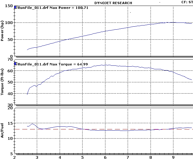

After four an a half month of bent val and redoing the cylinders SH, she finally back up an running. With know issue i can final go riding tonight. plus having a Djkit, Rt1 high, Bmc and Cct manual done. i was able to get a dyno in please tell me what yall think. Also if you had your sh dyno i would like to comp air to your

I think that looks about right. Glad to hear that you back up and running.
