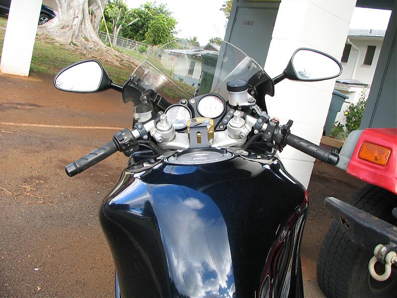

Here's a pic to make it all better...
Old Mar 1, 2008 | 05:05 PM
Posts: 2,223
Nice Greg

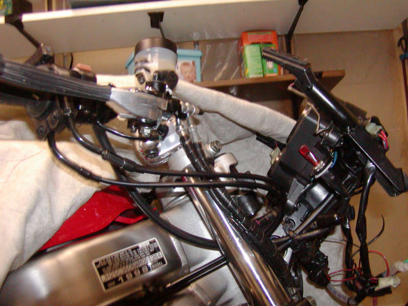

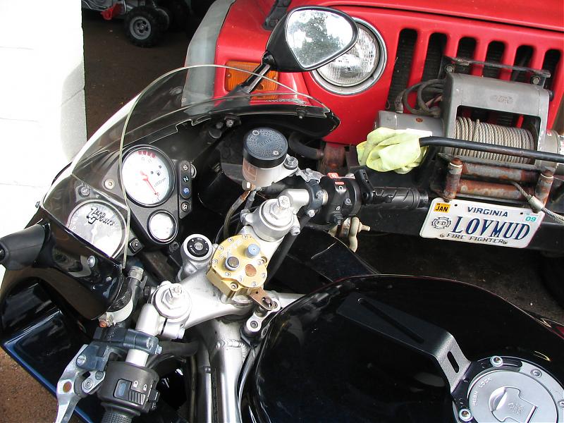

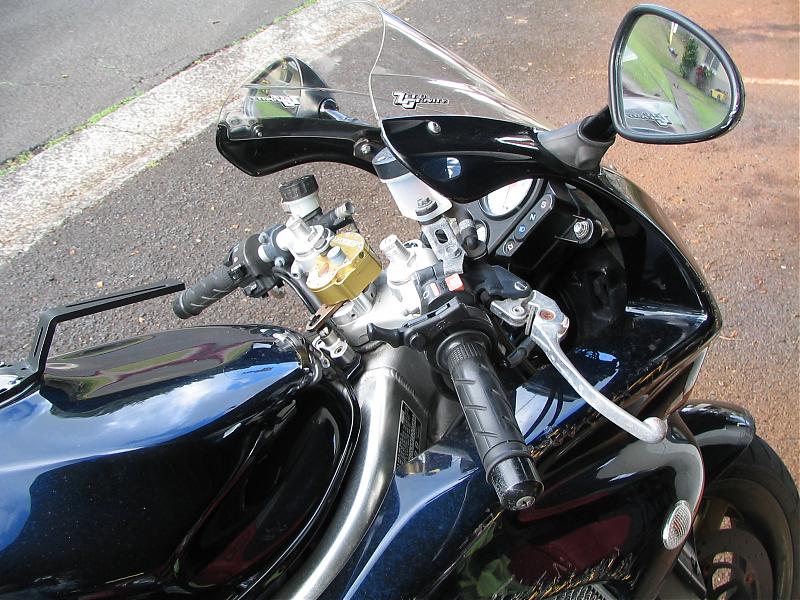

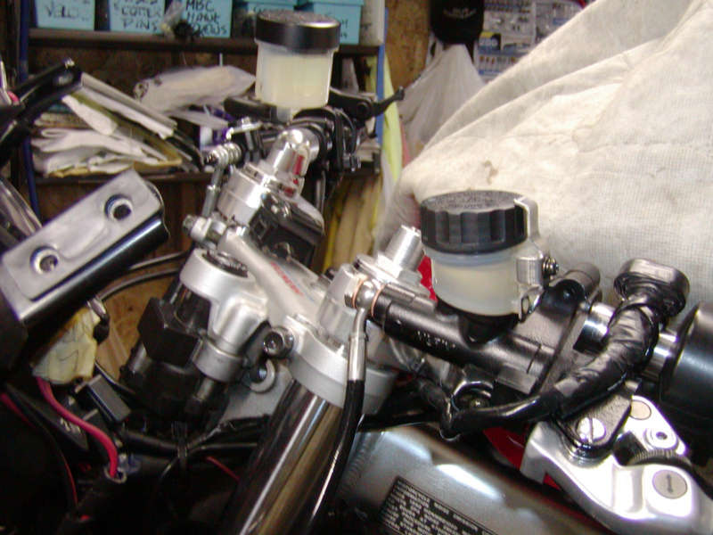

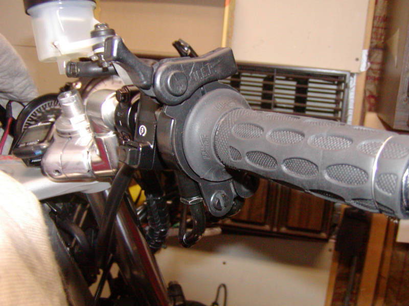

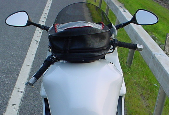

Is the white paint easy to keep clean & scratch-free. Those tank bags that attach to the gas cap ring seem like they put quite a load on the fasteners &/or threaded tank inserts??

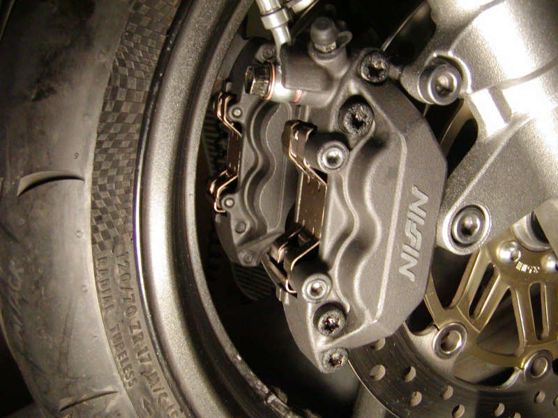

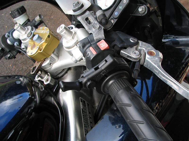

I can't afford the Throttle Meister grip lock but have been using the NEP for many moons (i.e., well before my VTR). Note the F4i calipers which are identical to the 00-01 RC51 but black (I painted the fastener heads). Have yet to test ride the Tommis & MP throttle cables, RC51 with the F4i calis, and the longer HEL clutch line. The Russel brake lines go back to day 1 practically.
No, the paint is actually easier to keep clean since you can see where the dirt is. So when the bike is dirty, it's dirty. But when it's clean, it's truly clean.
Let us know how all the brake mods turn out. Looks like you got everything sorted.
Old Mar 2, 2008 | 11:00 AM
Posts: 2,223
I've had one white vehicle (a Honda Odyssy) and it was a pain to keep clean but our VTRs have a lot less surface area (though you have a lower right) and are not out much in the winter.
How many pounds can your tank bag handle? I use an old CH strap-on and Held mag unit, both which take a lot and you can lean on during long rides.
The RC51 MC seems better now that its matched but still firm with little travel (but maybe better feel). After I sanded the OEM F4i pads using 150 drywall grid (to clean and take out the bedding from the previous owners rotors), cleaned my OEM rotors with skotchbrite (I use diluted detergent and ammonia followed by 91% iso alcohol), it bites like a demon. Still I can't wait till spring to road test everything (though its a 45 today but what a mess at the cemetary for my very close aunt's funeral, whe was a stitch).

Skokie,
I've carried quite a lot with that tank bag. It'll hold 20# easy. I talked to the owner of the company and he said he had a customer test the bag by loading a cinder block (!) in it and ride around. It held up to the torture and no damage occurred to the bike, the bag, or the cinder block ! Usually I don't run that tank bag on the VTR. I have two rings that mount on the tank and one bag. I usually keep the two rings on both CBRs since they both have plastic tanks. The mounting uses three screws and is quick to change out. It's a very secure system.
Old Mar 2, 2008 | 09:09 PM
Posts: 2,223
Skokie,
very impressive. who makes it (just curious as my funds are depleted due to funeral expenses this week and I don't need one anyway)?

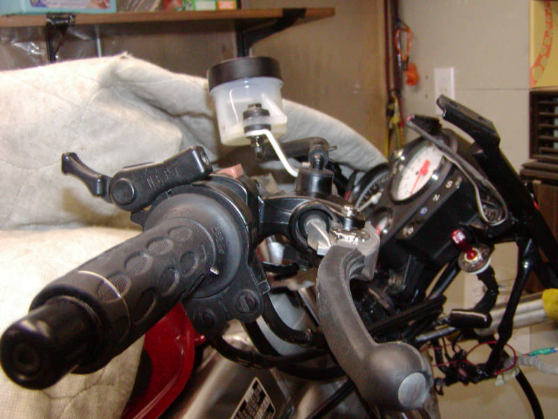

got my throttle lock installed and tested. Im happy, if only to see peoples face when i sit on the back seat of the bike and keep up with them on the road lol
new windscreen and camera mount also up and running now.
