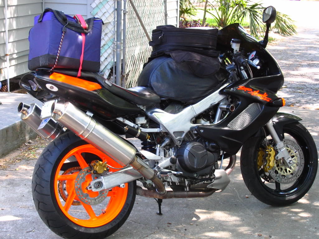

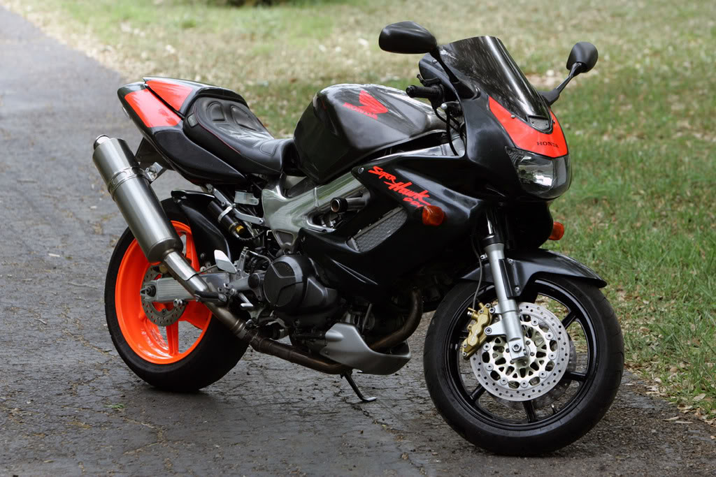

I got 92 hits searching "rc51 exhausts" and here's a link of mine from that search.
https://www.superhawkforum.com/forum...t=rc51+exhaust
NOTE: pics were lost in a server crash. Here's some generic pics of them installed tho'.
