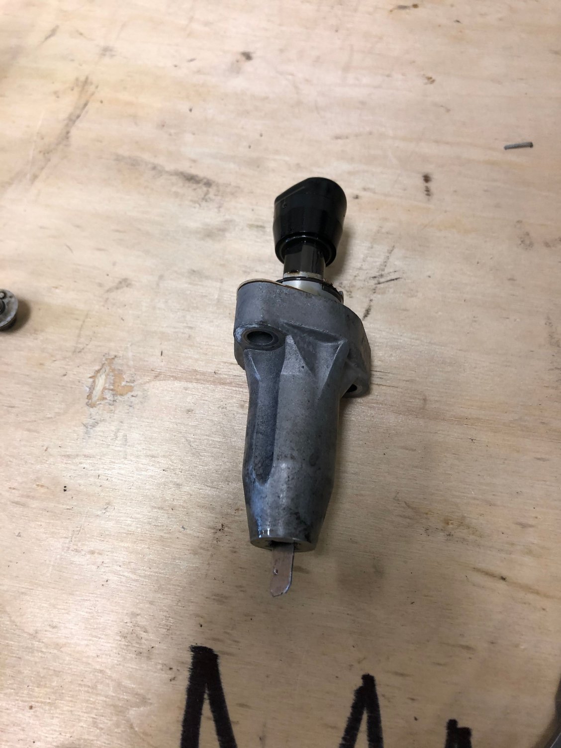

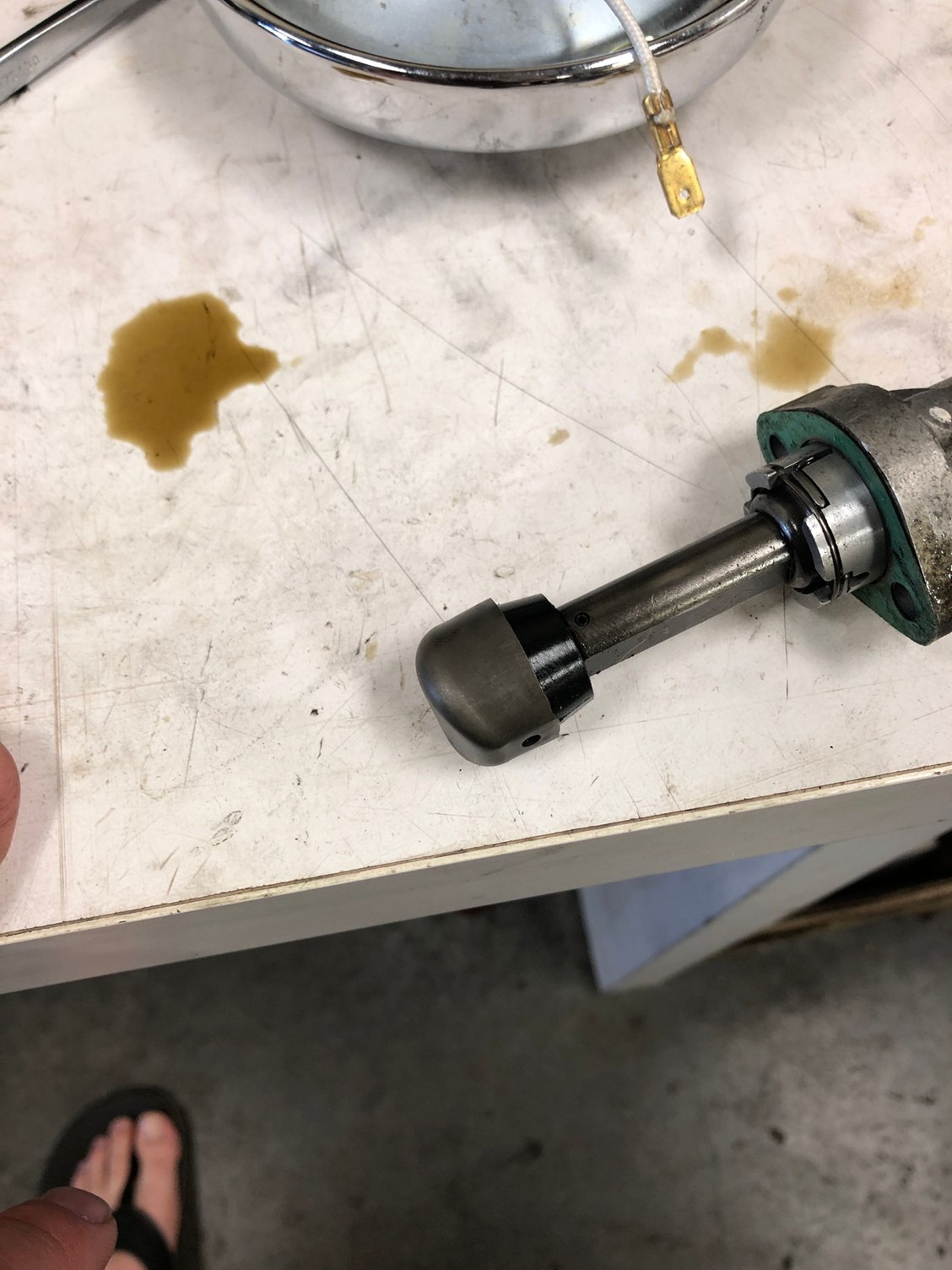

Last summer my vtr jumped time and ate the front intake valves. Flash forward and I’ve purchased a used engine to install, with yosh cams and new tensioners, but when I removed the tensioners, both of them were missing the pad/cap that Honda shows in the parts diagram. On my blown engine, the front was missing but the rear was there. Anyone else have experience with them not being there from the factory or have I purchased a sh*t motor?

They can get stuck when the tensioner gets pulled. Or a PO forgot to put them on when installing CCTS. Shine a torch down the hole / check the oil pan.

I shined a light down before ever pulling them. Not there. Ordered them on eBay today, local Honda shop is pretty slow on getting parts.

Thank you all for helping me answer my question, and for the indoctrination. After removing the oil pan, the caps were not in there, so I'm assuming the previous owner left them out, or Honda never installed them.

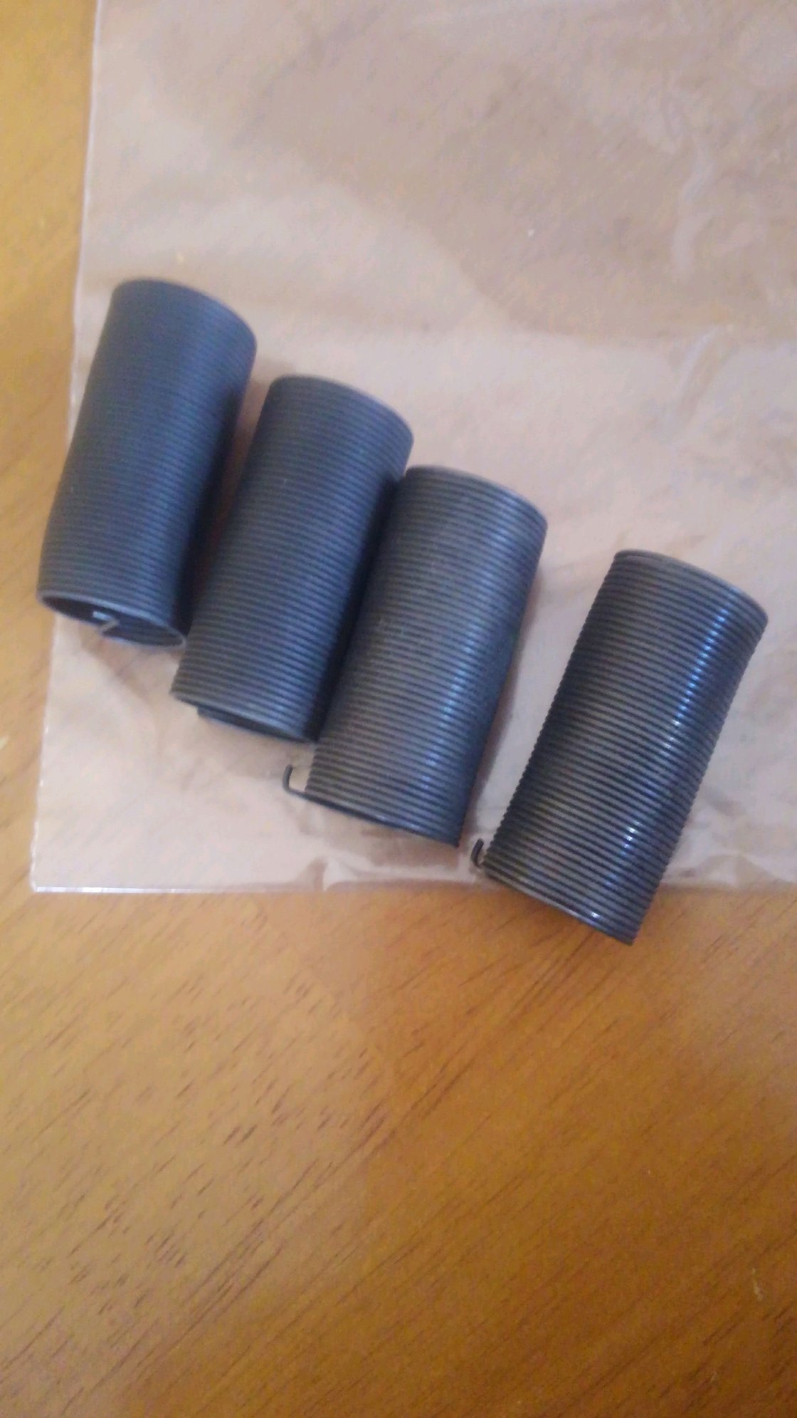

Here's a pic of my springs that have been cryo treated and coated with a transition coating to reduce the thermal effect on the spring while baking in the engine:

What do you charge for a set of treated springs? <=> than a good set of manual CCT's? Not being a smartass, my norm, really would like to know. TIA

2nd this ^^ I’d be potentially interested...and curious to see if they add longevity and more reliability to the factory CCT’s.
