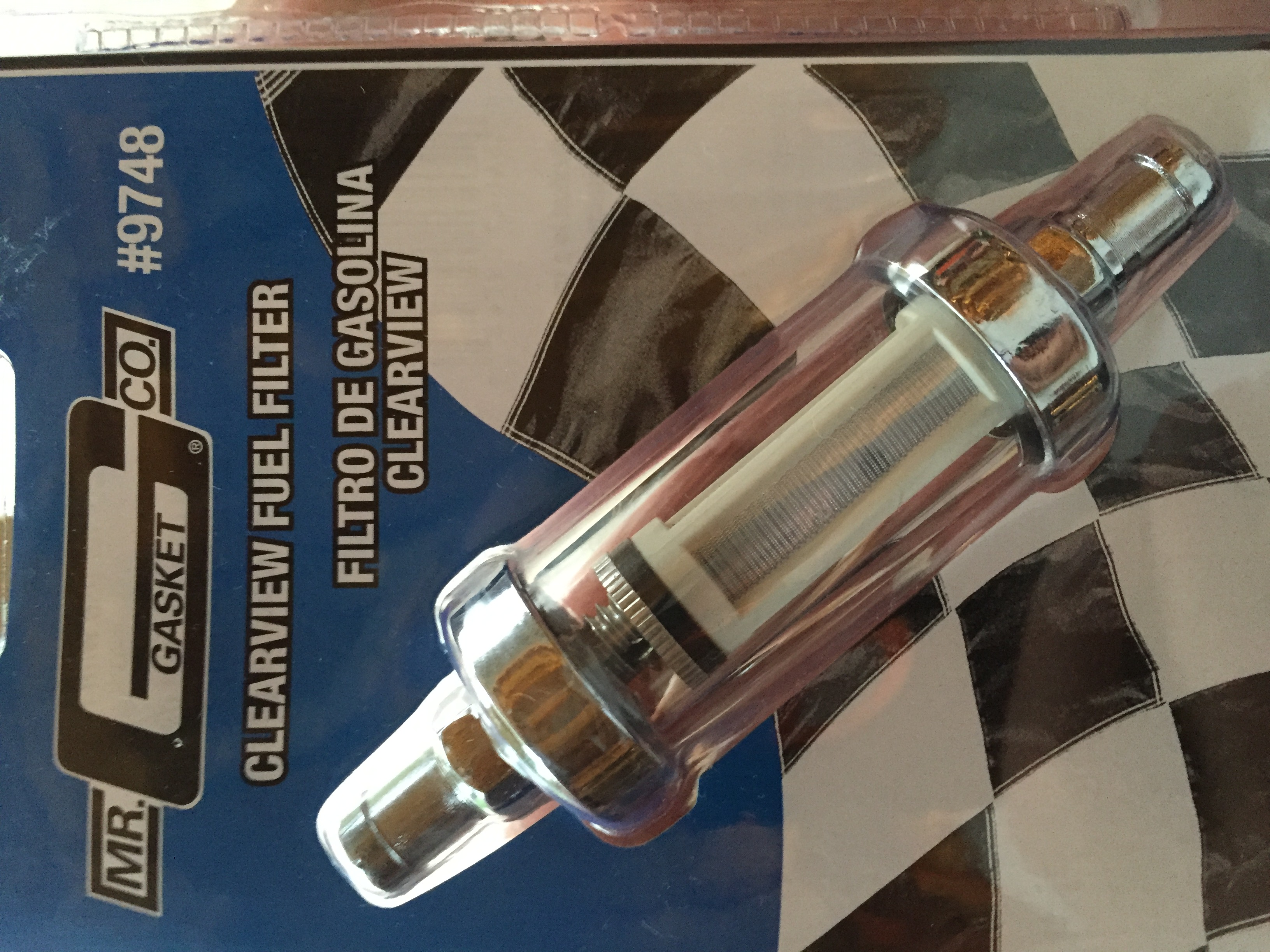

What kind of fuel filters do you have?
The inline paper filters from oreilly's. Haven't had an issue from them. But the issue happened before I installed them

Fastguy59's Avatar
Joined: Nov 2014
Posts: 416
From: Middletown, CT
Try these Crux, nice quality!
