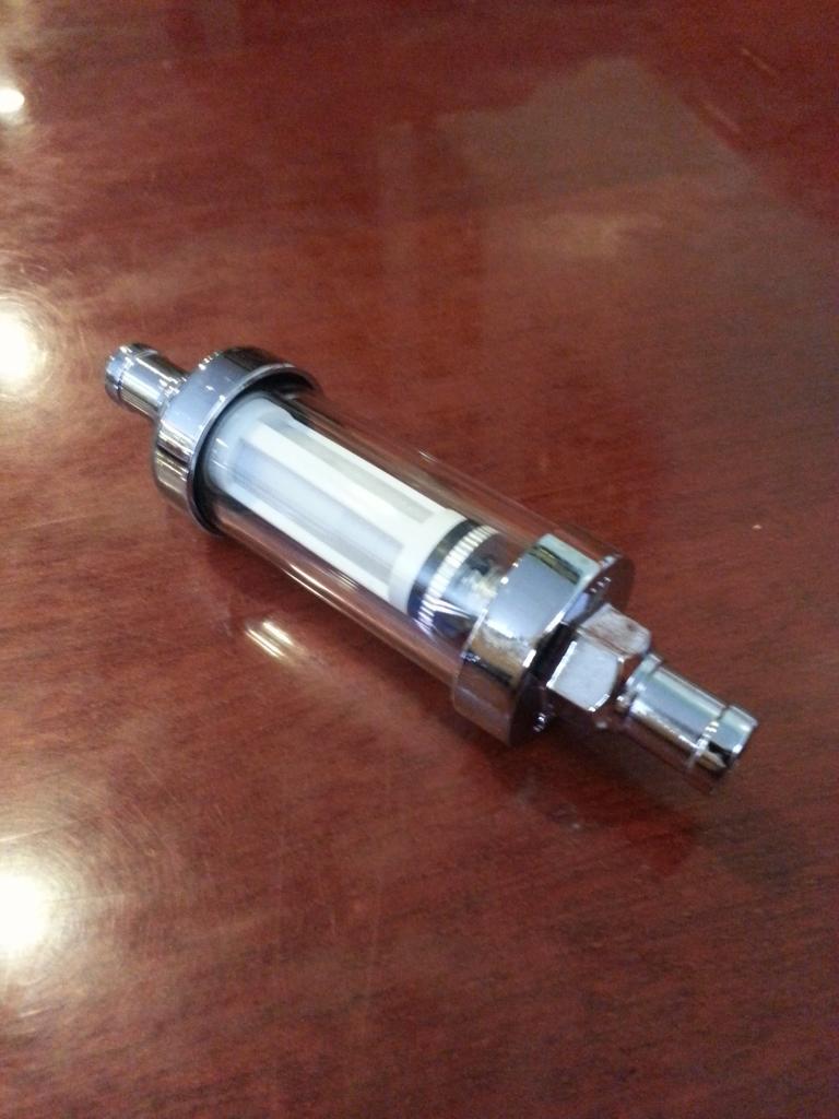

Mr. Gasket #9748 Fuel filters
Gonna give a couple of these a shot (rain coming)

I would not do that. Gravity feed systems, like the VTR uses, should not have a filter.

What's the downside jaimie? Restricted flow? I've added them to dirt bikes and ATVs without noticing any issues

I would suspect that at low fuel levels, you might run into a situation where the flow force needed to flow the filter is marginal. Cavitation at low levels can affect the perceived pressure at the filter.

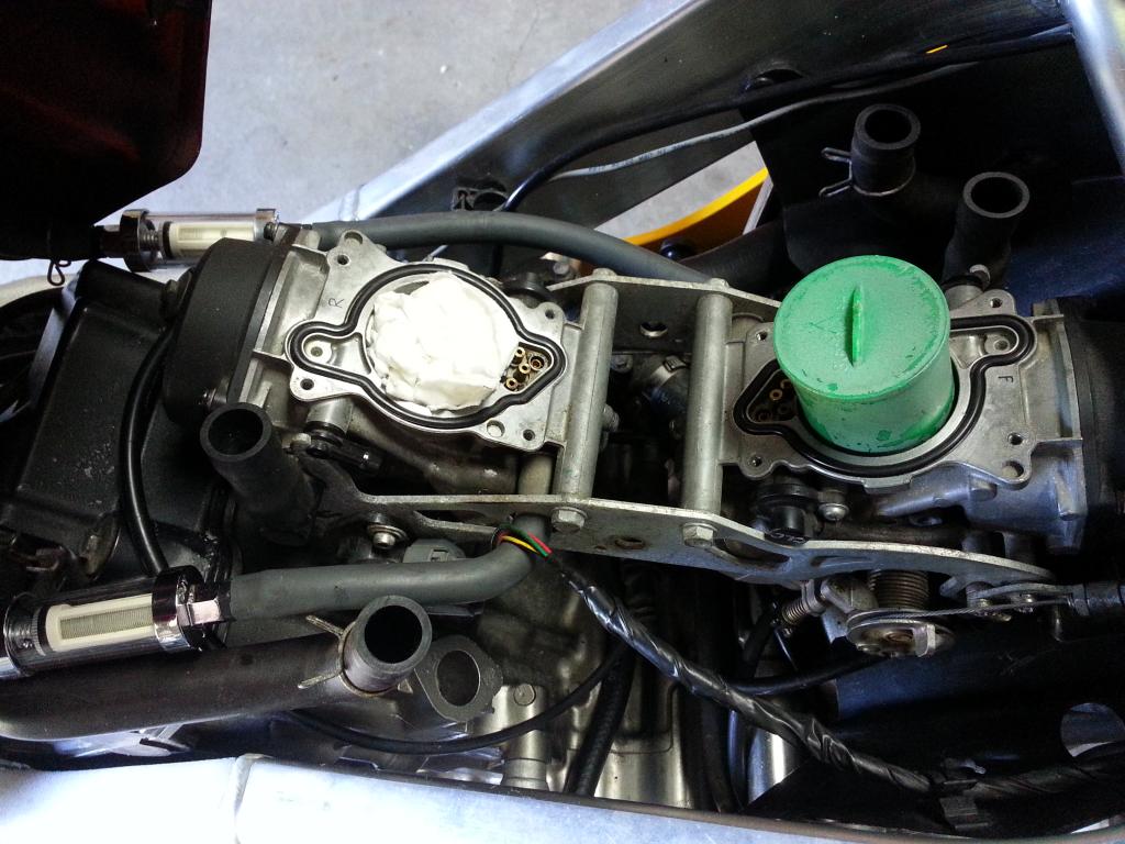

Those are the exact same ones I installed. Haven't had a single problem so far in 500+ miles.
I put them inline with each fuel line running to each carb. I think I have a picture somewhere I can post later.
EDIT: In the picture, the fuel lines are disconnected, that's why they are sitting really low. When you first install the filters, you can watch the fuel flow through them and it moves quite quickly.

If you have a rusty tank or something and need protection against scale getting into your carbs then I suggest using sintered bronze ones. Those are the little cone shaped parts normally used on motocross bikes. Not sure if they have them in the size you need for the VTR carbs.
If you are just concerned - don't be.

This is why I did it, BUT this is just my bike. I took off my tank to hit it with some primer, so I removed most of the fuel and then removed the petcock to get the rest of the fuel out. It was then, and this was after several thousand miles of running the bike like this, that I learned the P.O. removed the in-tank filter that attaches to the petcock. How I never had an issue with my carbs is beyond me.
So, it was order the stock in-tank filter and wait 7-10 days (it was great riding weather), or grab a couple of these filters and see how they do.
Like I mentioned, no problems in 500+ miles, and I like that you can see the fuel and any debris. They have already caught a bunch of crap.
I still have to paint the tank, so I might just order that in-tank filter and install it as well. Not sure if that will be too much restriction though.

FYI, I just installed new jets, and while I was doing this, I noticed that there was fuel leaking from the filters! I found that they had loosened themselves. I retightened them and used a Sharpie to put a couple index marks on both of the filter ends, so I can make sure they aren't loosening again.
For those that have installed these, make sure they are tight.
