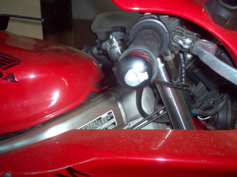

poor bike

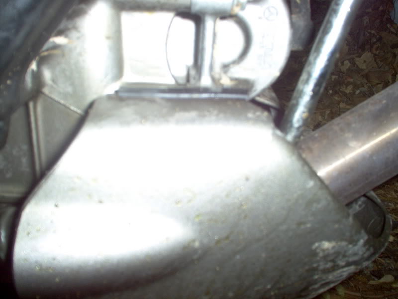

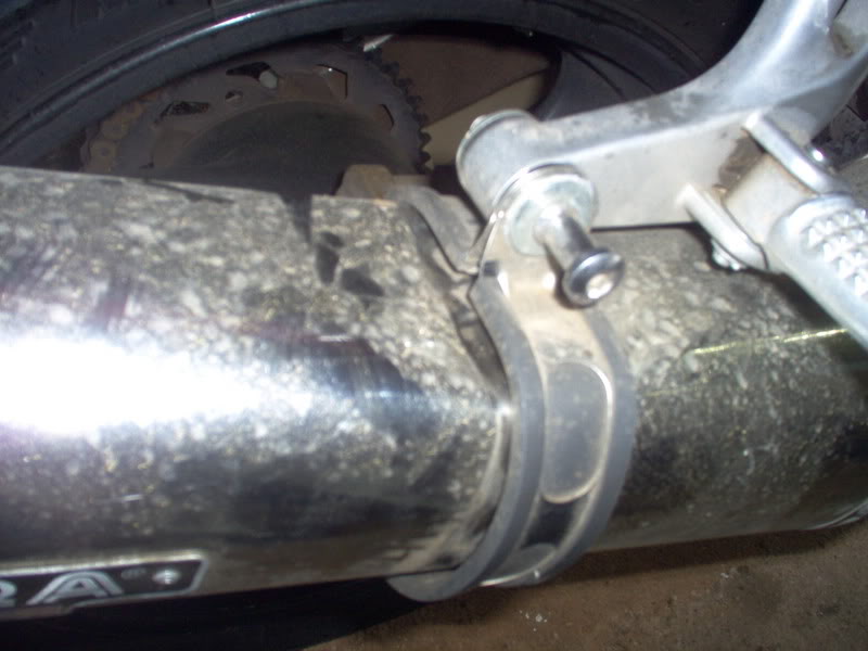

scratched my right side mirror, bar end, cracked the front fairing, cracked the crankcase cover, and dented and scratched the crap out of the exhaust canister

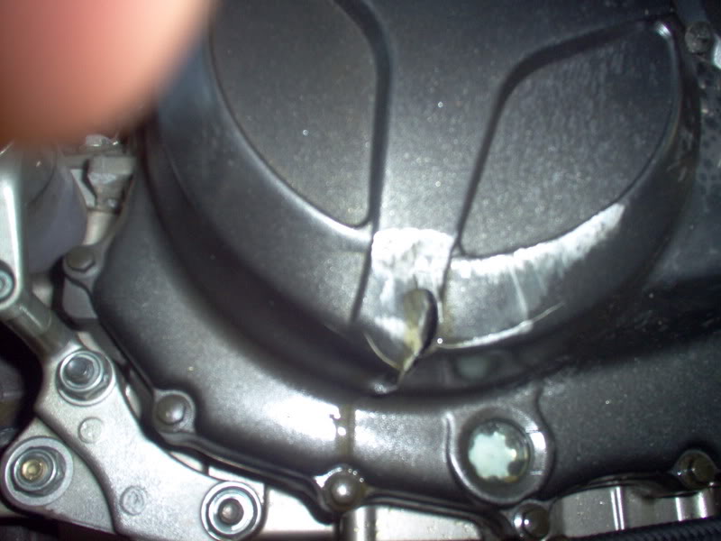

i'm losing oil out of the crankcase, so if anyone happens to have that part lying about, let me know what you want for it shipped to 73075...the rest i can live with, but if you have a good deal on the front fairing, i'd sure look at it
oh, and i got some roadrash on my right leg and elbow, nothing major...that's what i get for riding with just a helmet and gloves
anyway, on with the pics

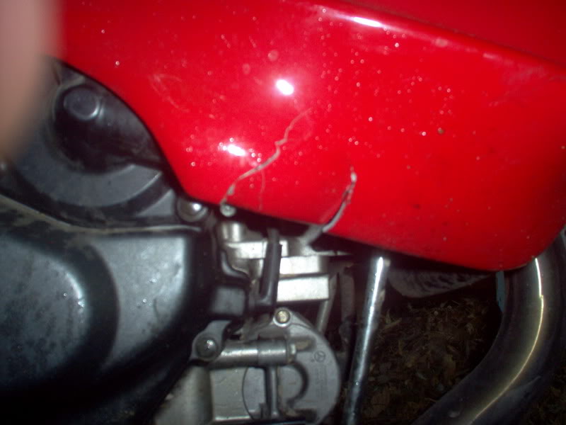

you can't really see the crack here, but it is

you can also weld the right case easily, or a welder can anyway
my friend went down and put a hole in his clutch case in a similar place, a little smaller, I tigged it back up, ground it flat and matched the contours, he painted it with kyrlon spraypaint that matched the original piant, 10k later it still looks like the day it rolled off the showroom floor
Just an option if you want to save a little money and dont want to worry about the waperpump from a used cover

+1 on what AC Cobra says.
A good metal guy can clean that up like it never happened. Prolly for cheaper than buying used.

Color Rite makes a plastic repair kit for that welds broken farings check ou t there web site. colorrite.com

If you want to try an epoxy, try JB weld. I would bet anything you wouldn't have any problems this stuff works great!
