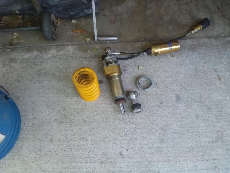

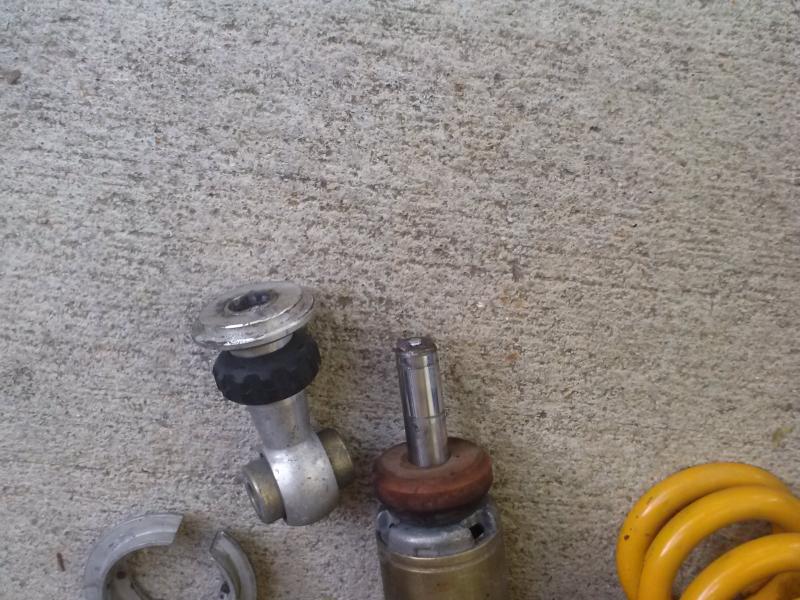

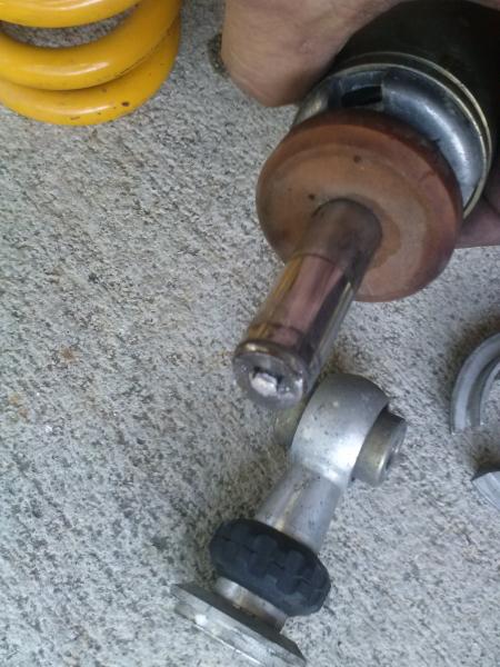

So I'm out riding today on Latigo Cyn and came up on a local who decided to take off.... Well no problem now I have someone to set the speed for me.... roll the bike into the next corner and suddenly it feel like I'm riding a pogo stick....
Pull over and check things and I have no damping in the rear
So nursed the bike home figuring I blew a seal..... but noooo when I pulled the shock I found this:
Guess I'm giving Dan a call in the morning.......

Talked with Dan this morning and the problem was that the lower spherical bearing seized which caused my issues....... Shock is in the mail and should be back pretty soon
