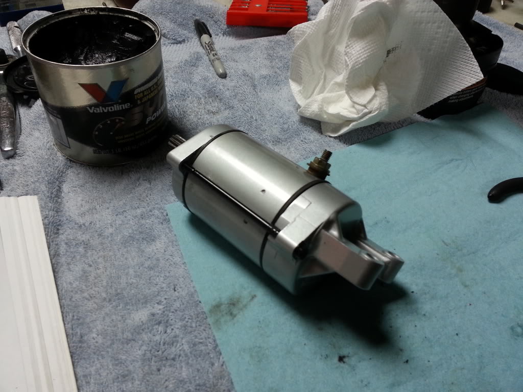

A buddy of mine just reminded me of a problem we had with a '90's Chevy Cavalier some years back. It was having the same issue, but the starter was causing the problem. Changed the starter and the car ran just fine. I'm going to look into that as well. Maybe heat soak is doing something to the starter. Hmm...
I wanted to pull the starter off to clean and paint it anyways. The engine looks great, but the starter is all rusty and nasty.
Old Apr 21, 2013 | 10:51 PM

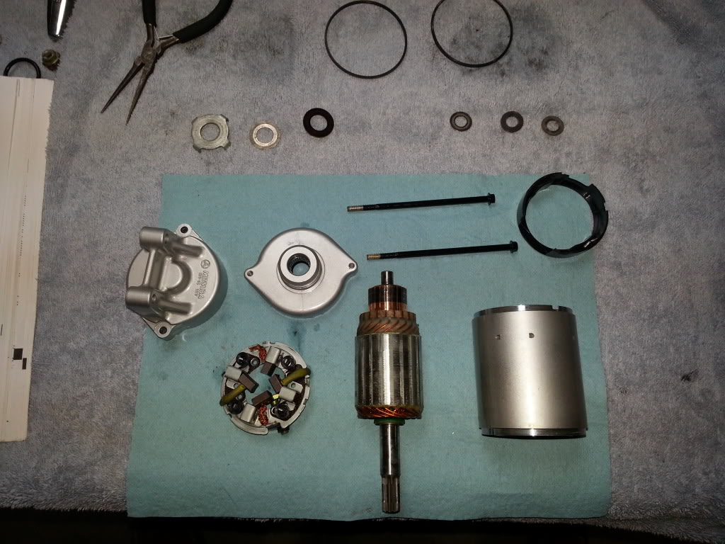

Took the starter off and pulled it apart. It was kinda crusty with that white powdery corosion and a little rust on the case, but the insides looked really good. Everything tested good and the parts were in spec.
I cleaned it up and got a coat of paint on it tonight. Tomorrow after work, I'll put 'er together and pop it back in and see what happens.

After reassembling the freshly painted and fantastic looking starter, I installed it back on the bike and she fired right up. However, after the battery was drained yesterday, I never charged it back up. So, I have a couple ideas what's going on here.
It was to late tonight to take 'er around the block, so I'll do it tomorrow morning and report back.
If it drains the battery again after taking it for a quick spin, I'll have to use your advice s4steve.

I figured out how to post pictures!
Here is the R/R and a couple of the starter.

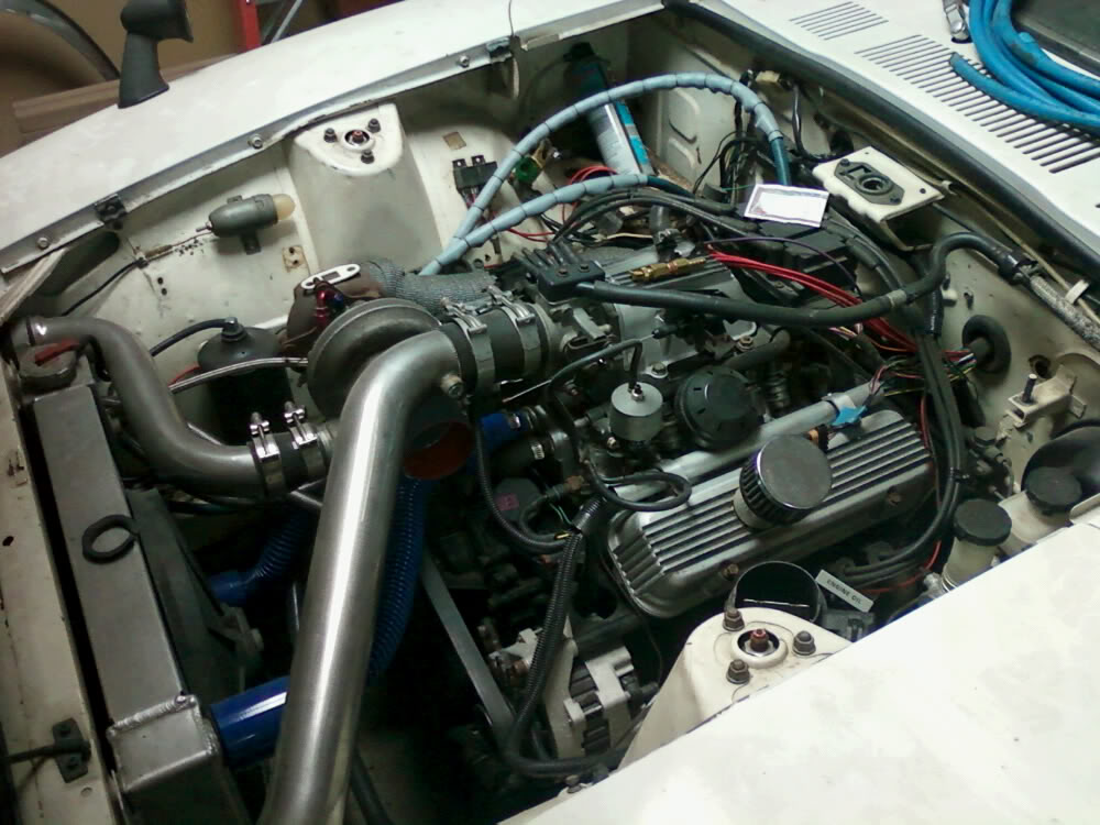

And for the dude who wanted to see the GNZ. In these pictures, the car is far from finished, but you get the idea of what it is.
