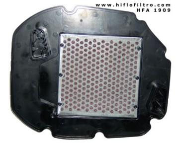

To be fair Tweety,Honda did not put them there.
Pretty sure he is describing the rubber blocks that come with the K&N Air Filter. The ones that are used in place of the stock air filter with built in blocks.
To the OP.. the blocks for the K&N or the ones built into the stock air filter
Keep the air filter in place and sealed, for no unfiltered air leaks.
I would say the shop that told you there are not needed, is mistaken.

FYI, those caps cover breather holes for the carb slides. The caps make sure the carbs pull air from the atmosphere without interfering with the airbox volume (and vice versa).
There are little foam filters in there as well (that the caps hold in) which keep debris out of your carbs. Both are important contrary to your shop's belief.

Lastly..... Seth , no loss on the K&N bits, the air cleaner is very hard to tune for, and most end up dumping it for a stocker or another brand aftermarket. If your not going wild with intake and engine mods.. use the stocker.....it's easy to tune for and gets great results .
