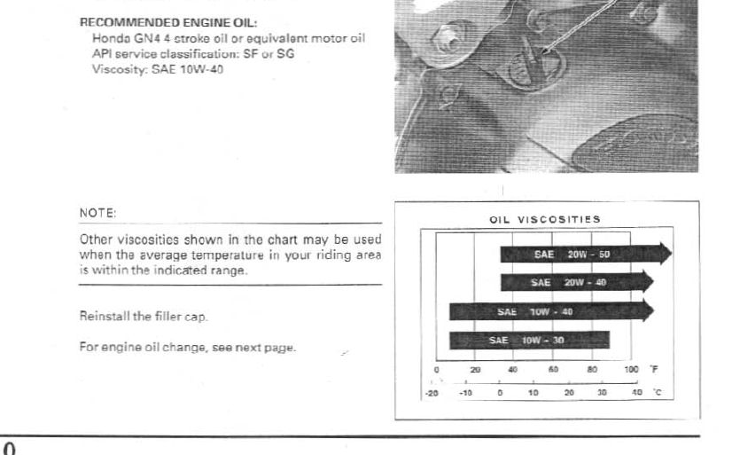

I'm in Houston so it gets pretty hot here. The manual says 20/50 is safe to use but previous owner has been using 10/40. Would anyone suggest I change to 20/50?

No, the manual doesn't say that... Read it again...
Old May 12, 2013 | 03:01 PM
Actually, it does say that... the oil recommended is 10-40,, and then states to use the diagram below to choose based on temp range.
And recommends 20-50 from temps 40F to over 100F.. and that my dear swedish friend is what temps are in his part of Texas in the summer.
For summer months here in my part of Texas i use
4T Silkolene Pro 4 15-50, Ester based full synthetic.
Having done oil analysis on this bike, using several brands of oil, and this specific brand, type and weight..I'm confident in my choices.. and it's protection and resistance to Shear and thermal breakdown.
Actually... No...
If you look at the text, and the chart... Where does it say the 20W-50 is recommended over 20W-40 at any given temperature?
They are both the correct choice from 32F to 100F... And a bit beyond...
But when you go close to 100F or above and rarely close to 32F, then the 20W-50 is probably the better choice, manual aside...
But it still doesn't mean the manual says that 20W-50 is the only correct choice, or in any way preferred over 20W-40...

Actually... No...
We can agree to disagree
The OP stated "The manual says 20/50 is safe to use" Which is a correct statement as the chart clearly shows for the average temps he will see in HIS RIDING AREA.
To responses like "Maybe if it was an air cooled engine." and "No, the manual doesn't say that... Read it again..." were made..and BOTH responses are WRONG as the text and chart clearly show.
The chart IMHO does indicate 20w50 is A proper choice or using the OP's word " safe to use".
You told the OP the manual did not say 20w50 was safe to use,, and your wrong
